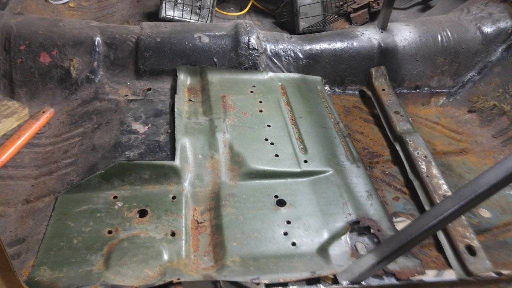

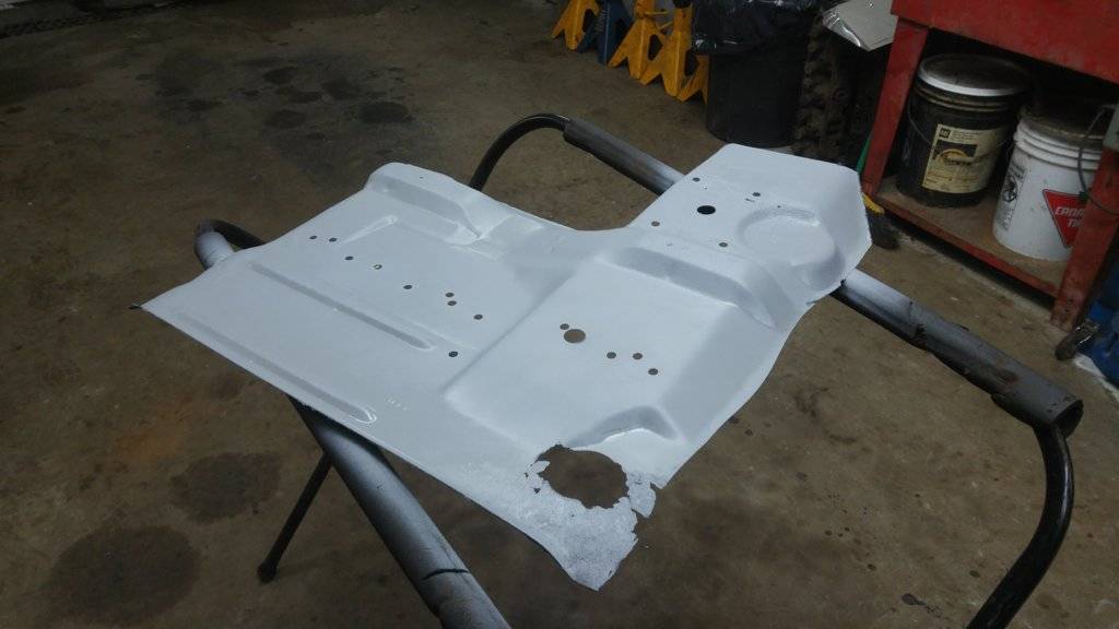

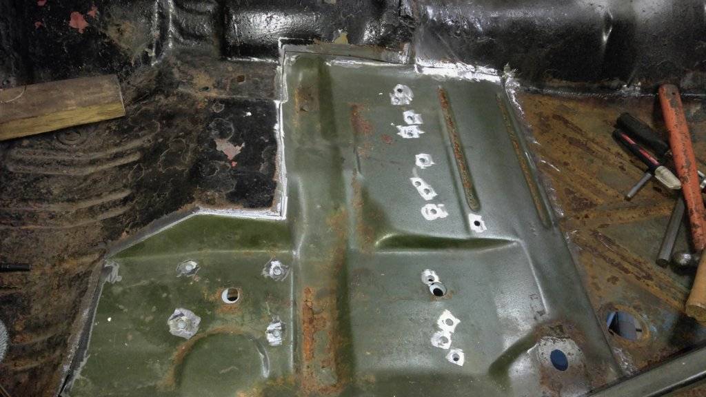

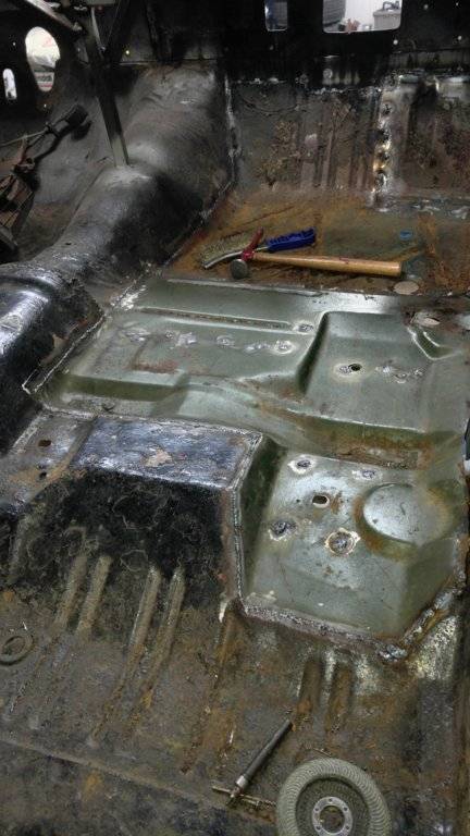

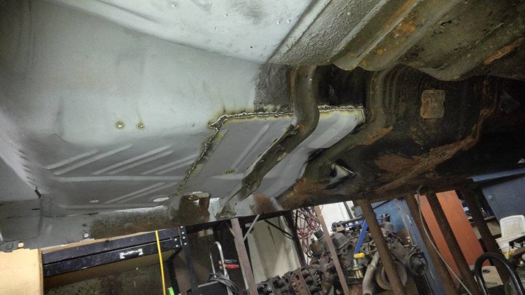

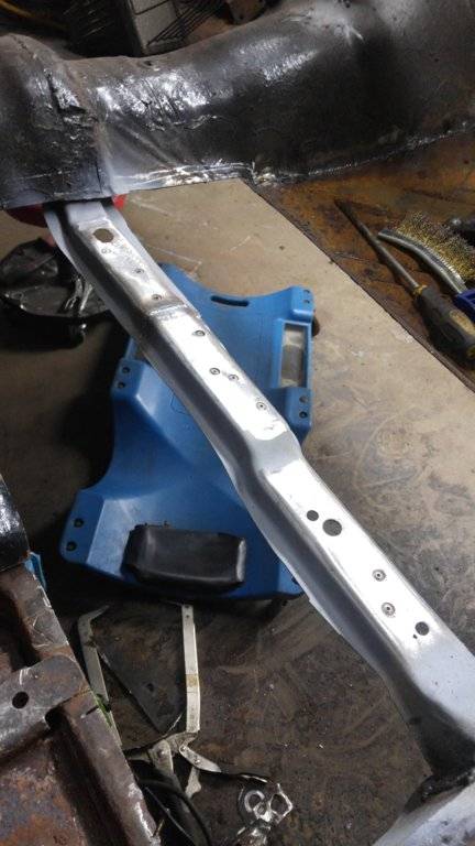

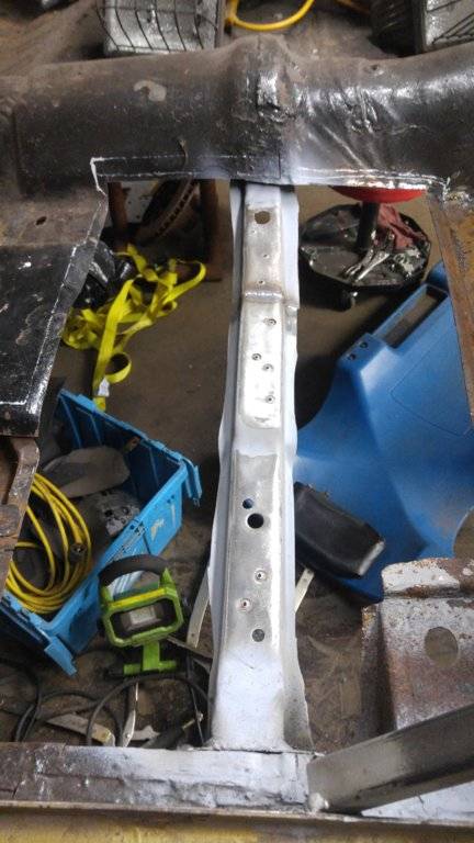

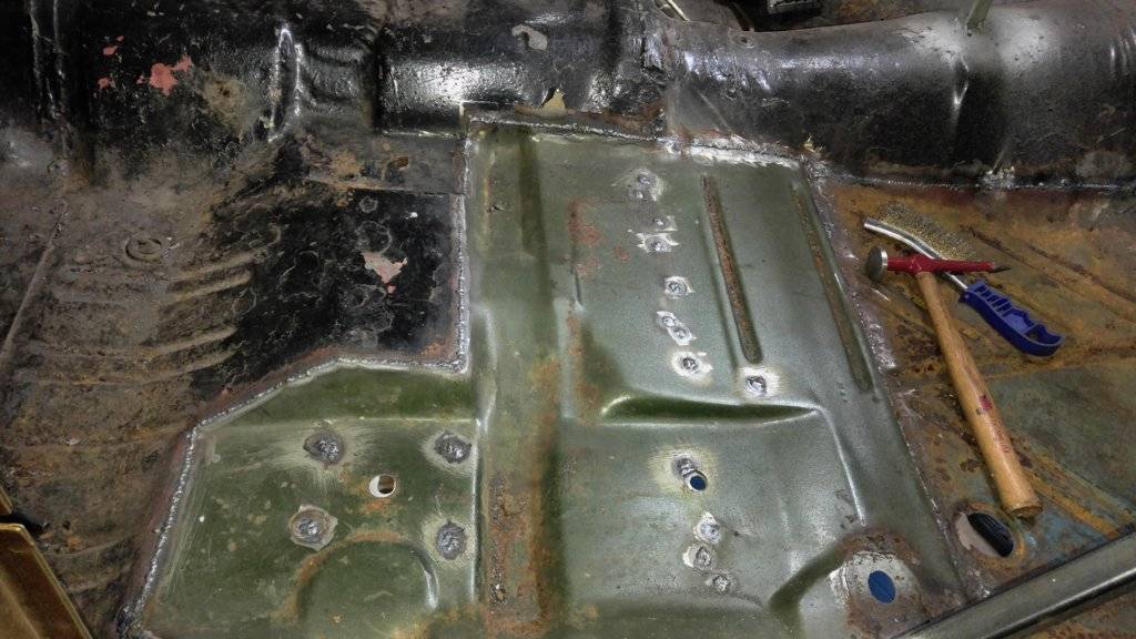

Slowly fixing nightmares as I go...the passenger front floor support was destroyed...luckily I had some donor metal from the green 70.
More tomorrow..

Aside from some minor fitment and placement of holes, in my experience, anything other then outer body panel skins will interchange from 69-73 Furys in terms of metal.
Main variation in panels I've observed between Dodge Chrysler and Plymouth is the trunk extensions, and rear footwell. Other then those the cars are all the same metal 69-73 with the exception of outer body panels but that's obvious.
I did notice the 71+ firewalls have some minor variation, mostly at the top for the OSAC system and vacuum valves.
