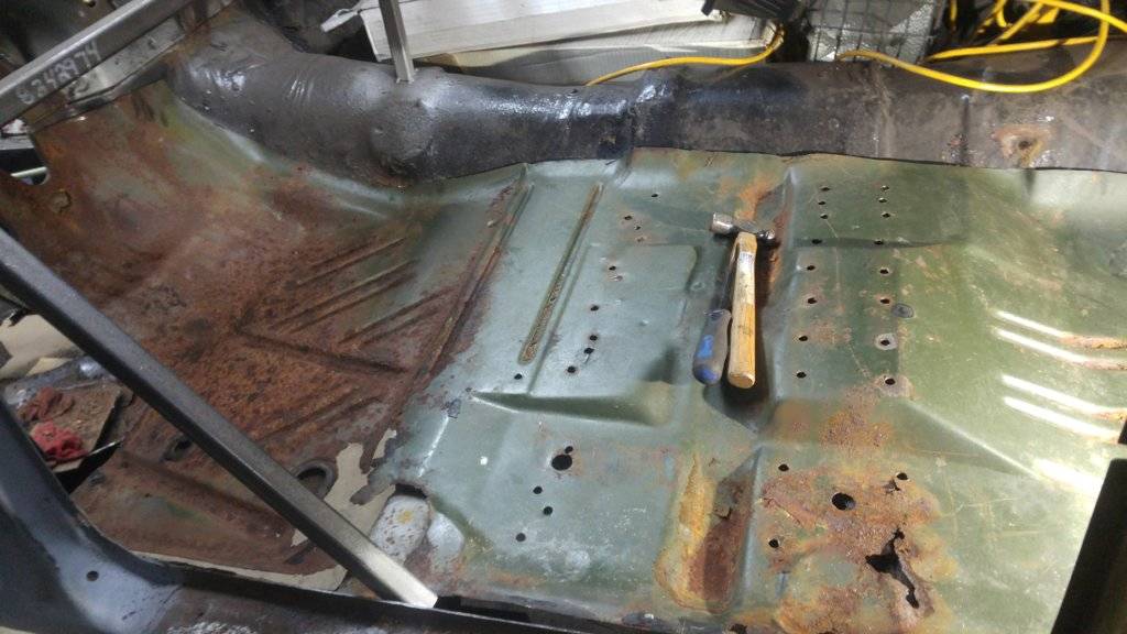

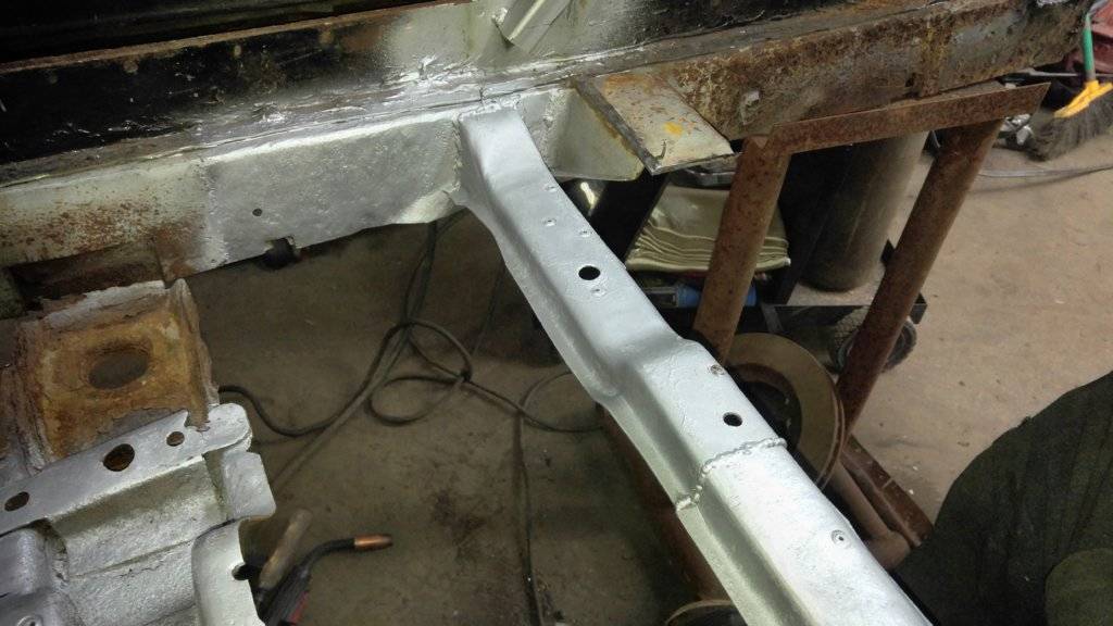

I have the passenger side finished now other then dressing my welds underneath the car for appearance sake.

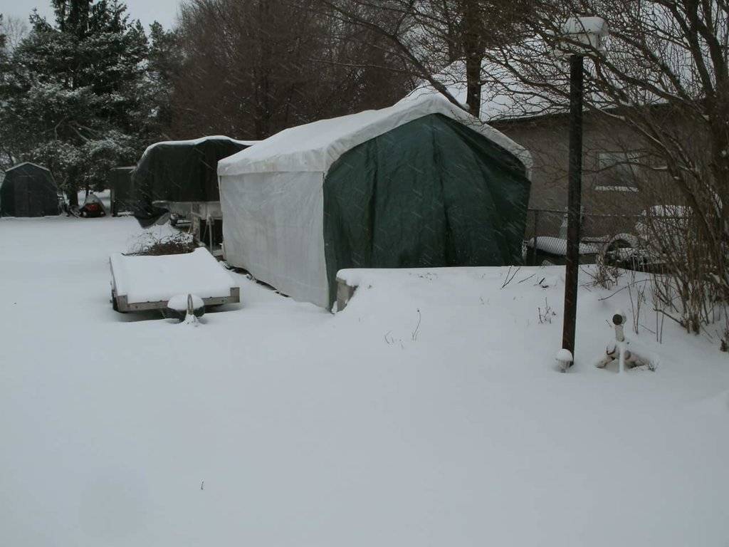

Feel better.... the garage will come. I recall a car under a tent and snow when you started. You’ve come a long way my friend.

Thanks Lea.
As I've said all along, this car holds an important place in my heart. It's as much a part of me getting to where I am today as many other important things in my life.
It also holds a lot of memories for me.
My grandfather loaned me the money to buy it, my dad helped me work on it, my father in law and I spent hours working on it, it was there during times that were good and bad, it lead to me meeting some great people I now call my friends and it's taught me an endless amount of lessons and skill sets that I may not have had otherwise.
Its been a serious undertaking, but I can see the light at the end of the tunnel...
After I finish this side, my next step is the top/outer skins of the firewall and then I will be cleaning up the bottom of the car so I can paint it....I'll then paint the firewall and front windshield frame and then I can start reassembling some stuff;
From there I will put the stub back in with the completed engine and trans, I will reinstall the rear diff and springs, and will begin reassembly of the brake system and heater box....
Then comes the next big hurdle, the exterior body and body panels...

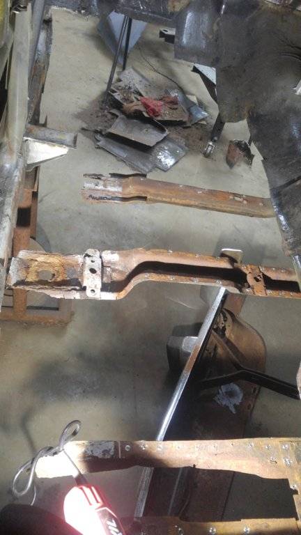

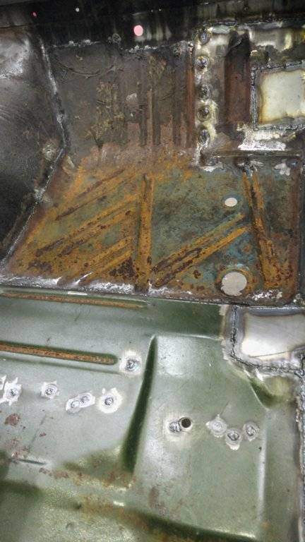

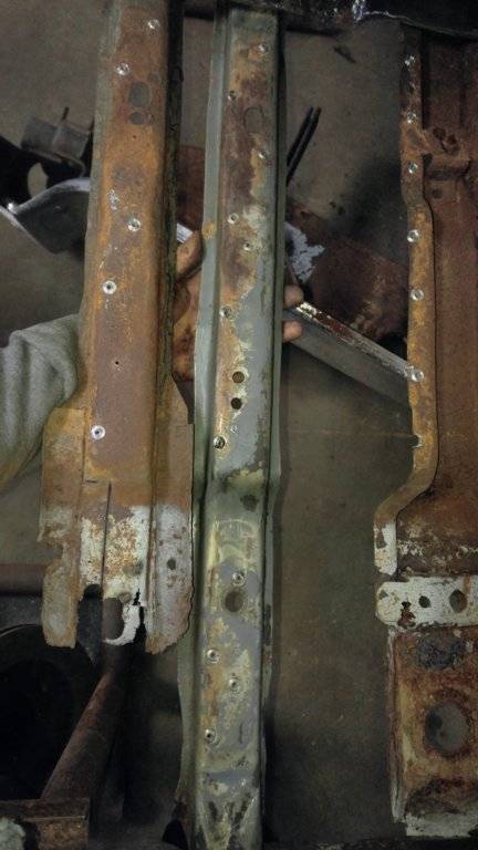

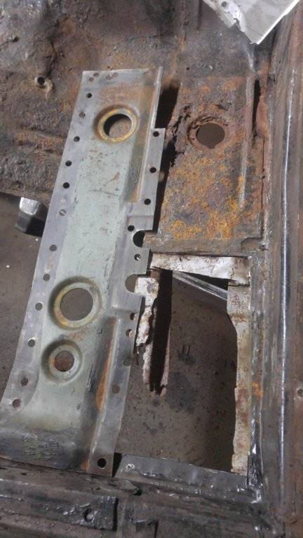

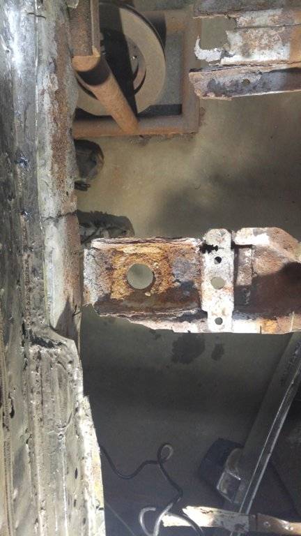

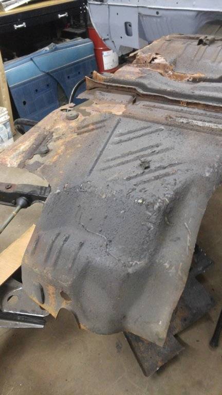

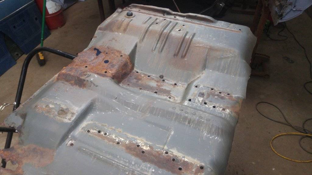

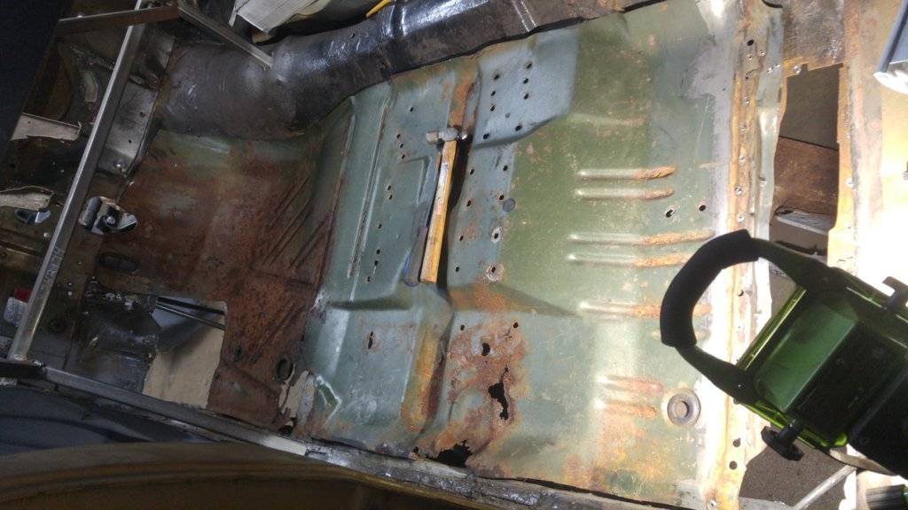

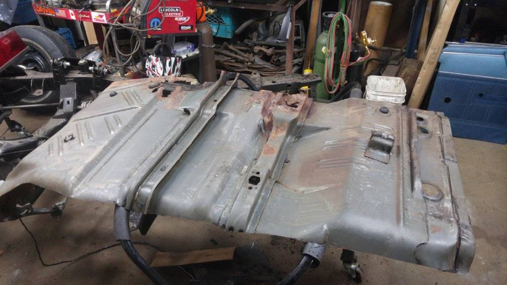

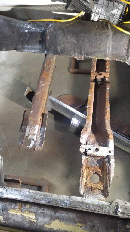

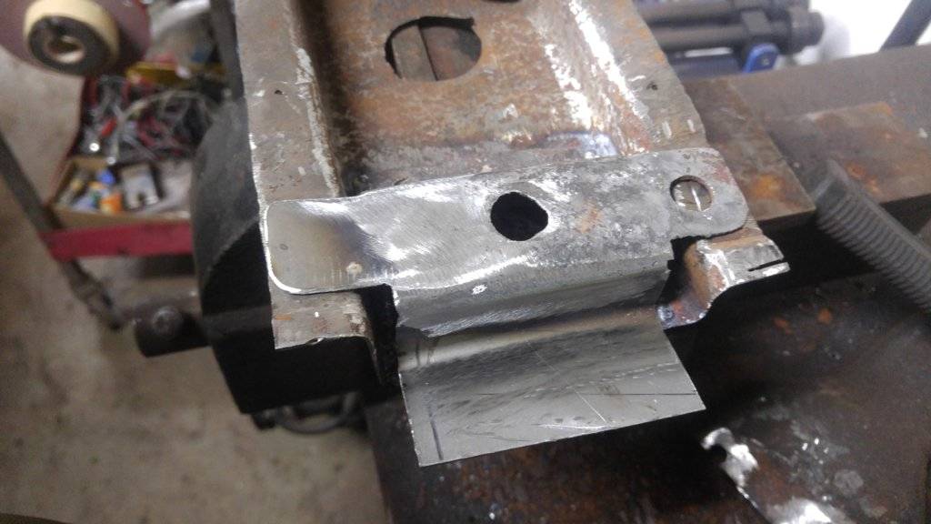

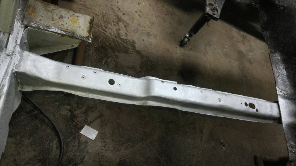

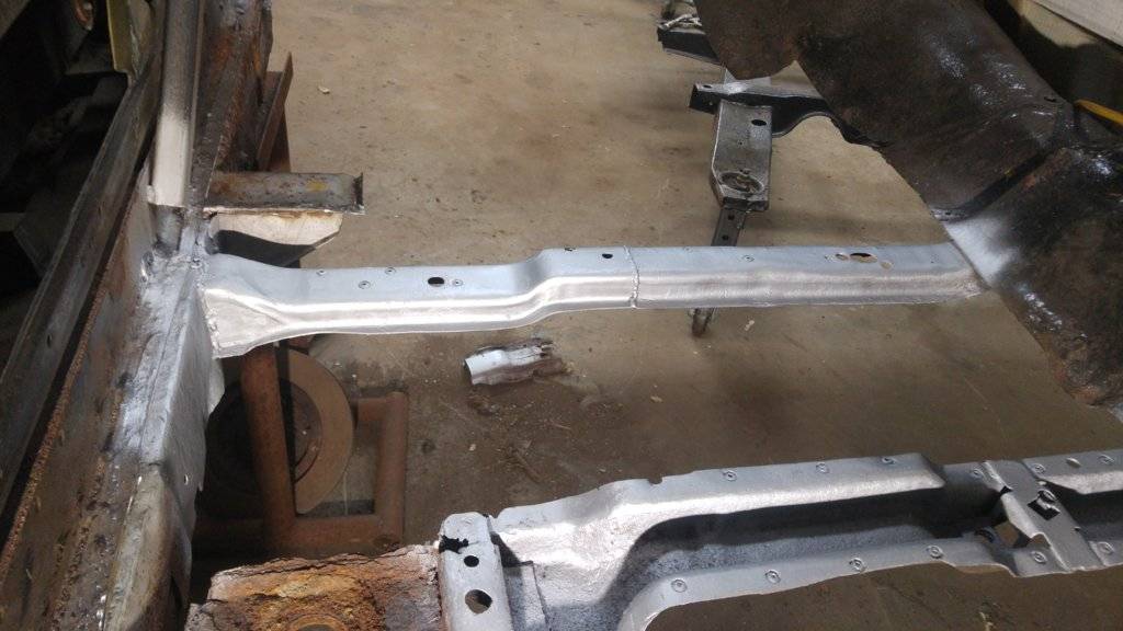

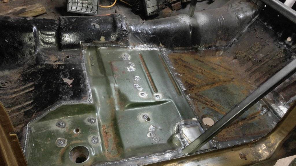

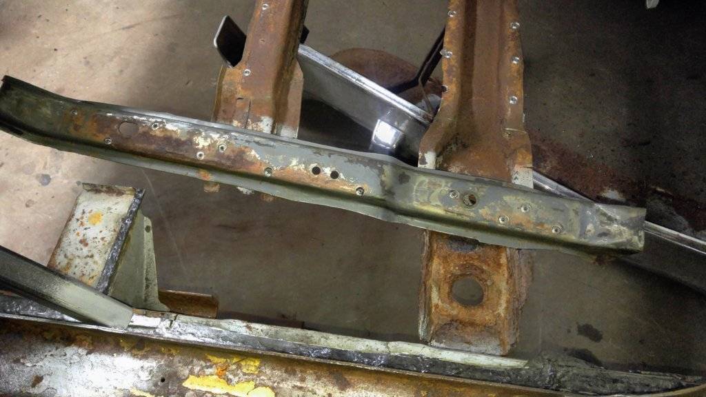

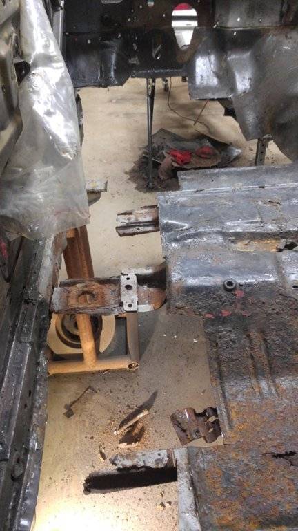

Anyway....I ran errands this morning and stopped by my shop to do some stuff on the shop van. Got home around 1 and headed out to the garage to begin some tinkering....quick FYI, a drill-doctor is a worthy investment if you use still bits a lot..
I ended up removing most of the drivers side pans, the water damage over time just made the remaining metal so damn soft that I didn't Think it was worth leaving and potentially having an issue with it later down the road.
I'm already waist deep, what's a few more inches?
View attachment 265265 View attachment 265266 View attachment 265267 View attachment 265268 View attachment 265269 View attachment 265270 View attachment 265271
Wow.... all I can say.
looks like there wasn't much holding that old girl together. nice work, nick.
