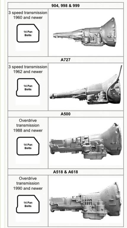

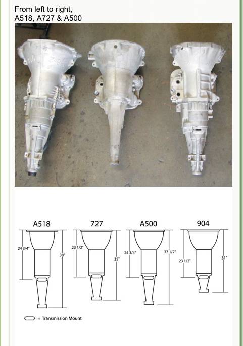

You've said this in another thread recently and unless you can show me numbers in production then we need to call it 50/ 50 , 904 / 727.
Here are the measurements of a 727 SB from the Summit site. Click on mail 0014 not the icon.

I'm referring to production numbers. So many 727s on small blocks. To say most came with 904s I can not accept.

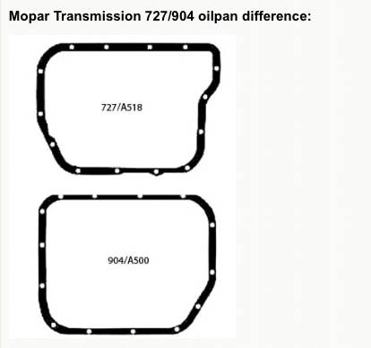

In any case the OP can use these measurements to compare. The 904 and 727 also have different pan configurations.
