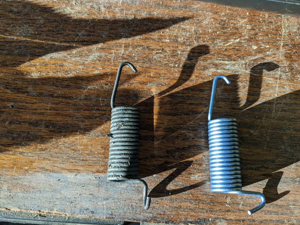

Does anyone know the correct part# for 66 fury3 front brake spring kit (shoes=11"x2.75") & (front brake flexible hose #?)

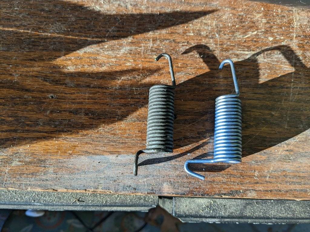

I have purchased 2 different sets in the last week on Amazon & both wrong( Raybestos H7116 & Dorman HW7116
O'reilly is stating that H7716 is the correct kit
the black spring is what I took off & the blue spring is what I received......

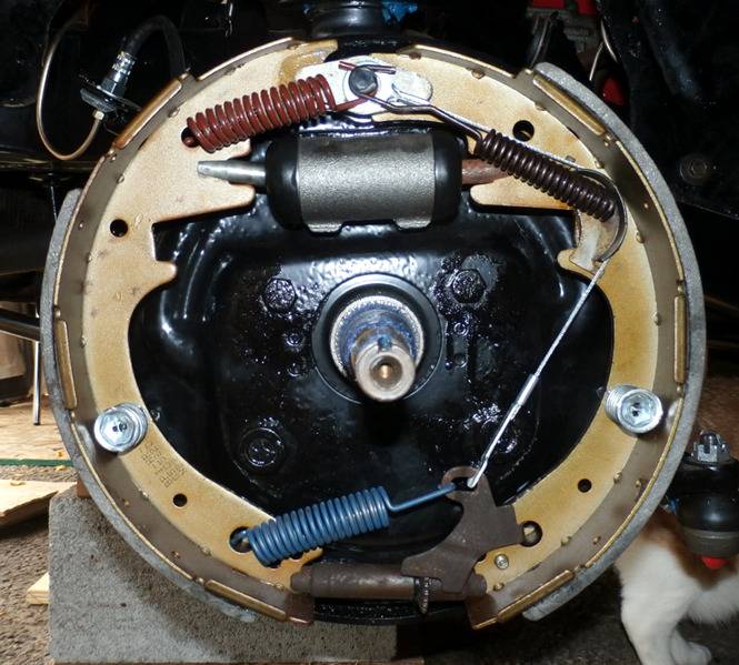

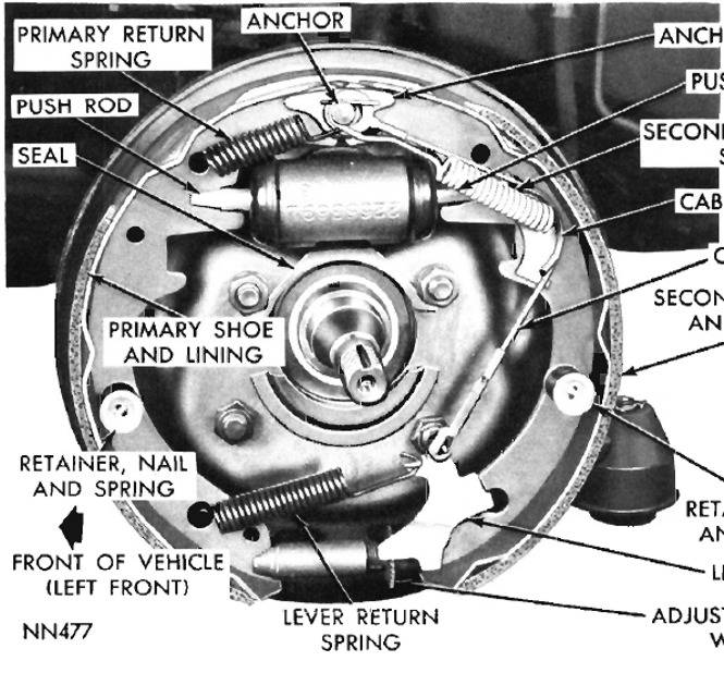

Over the past year or two when buying some parts from rockauto I'd browse through the brake spring kits not just for Mopar but also ford and gm. They were only a few bucks each and I bought the ones that looked like they'd be useful, comparing them to what I see in the factory manual.
I had an idea of replicating what I saw in the manual. So here's what the (1967 Monaco/Polara) manual shows, and below that is what my front brakes look like:
The brakes are slightly energized, the primary shoe is shown as slighly in motion here. That's what I was hoping for - that when pressing the brake pedal that the primary shoe would reliably move first in accordance with the "servo" theory of drum brake operation.
I also have a variety of hold-down nails, differing by length, I find the longest of them somewhat uncommon but I think they fit / work the best for these shoes (yes they are 11 x 2.75).
The blue spring is the one to use. Google "NOS Mopar brake springs" and I'll bet you'll see they look like the blue one and not the black one.
