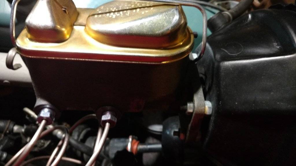

Well I have a doughnut and a cup of coffee in me now, time to check out the push rod. The damn thing popped out again. At least it was what I was anticipating, it is looking like Goldie is going to be out of commission for a while. Now a shipment back to the re-builder.
It all makes more sense now. I had to use a big hammer to set that pushrod, I thought there was no way that it would pop out again. Now my initial success makes sense, because it would have been seated properly originally.

I tried once again to set the push rod in place with a hammer. No luck, too much flex. I am at home in my garage where I don't have all the tools to make the removal easier, so I added some spacers, of nuts I had on hand, and adjusted the push rod to 1". I should be good for the 12 mile drive to my shop.

OK - glad to hear that the booster again is the issue... and whether or not the rebuilder instructed you to use the hammer, I am glad too you're sending it back. The hammer repair or adjustment on domething as critical as brakes is not something I really like, if you get my drift.
If you have a decent enough relationship with your rebuilder, you may wish to respectfully request of him to exchange the booster since it may be something that will repeat itself. You've had enough pulling your hair out over this. He can get the replacement on its' way to you now to minimize your downtime.
And while practise makes perfect on any job, yanking the booster on a 65 or 66 is a nasty job with at least 8 extensions and standing on your head!! Another reason to ask for a replacement booster. This should be the last time you need to do that.
I sent the booster I located myself, to have it rebuilt. You comment however, raises a question I can have with him, if this booster is indeed rebuildable. I don't even know if he would have one in stock since it is pretty rare.

I would suggest sending BOTH booster and master to your rebuilder to have him determine if there's any other mismatch issue...
I am wondering if there's a "too long travel" issue in the MC that would cause the booster to pop out. Just thinking out loud.

I will be shipping the booster back to the rebuilder. He is really baffled by it too. He said so long as the master is not grabbing the push rod (which it is not) there is definitely something wrong with the booster, and he is very interested to see what that problem is.
He said there is no reason to ship the master with it. Even if the master is not recovering as quickly as the booster, the push rod should never work its way out. It was a good suggestion Ross and I was glad I asked the question, because I would wonder if the master was some how causing this, but apparently not.
