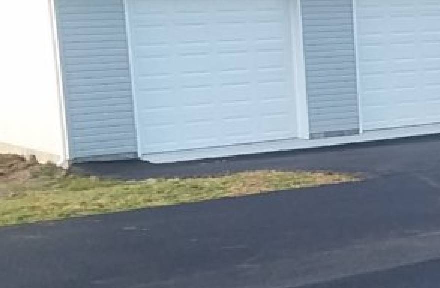

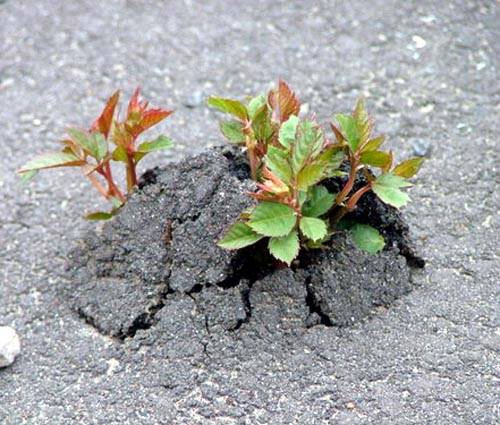

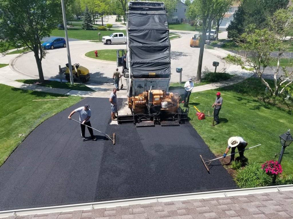

How the hell can something grow under asphalt and push it up?
And everybody wonders why I am in a bad mood all the time!
Wasn't a good answer...
Unfortunately it's not uncommon. If there were any remnants of vegetation left in the soil before the surfacing, they can push their way through. Just the messenger...
I have to agree with Stan on this one, that aggregate looks way to coarse and not nearly enough tar to seal it up properly IMO. So sorry to see that it is not holding up the way it should. :(
Fluck! Start yelling now and threaten to go public with it immediately.
I'd be on the horn with the paving company pronto! Seems they didn't prep the base properly.
Call them and rattle their cage.
Got in touch with them last night. He echoed you guys....pretty common with new asphalt. Once they are able to work again they are gonna come out and fix it.
Your driveway looks nice. It's too bad you're having problems pop up so soon.
Like Stan said, the aggregate, and how it's applied is the key to a having a solid, long lasting driveway.

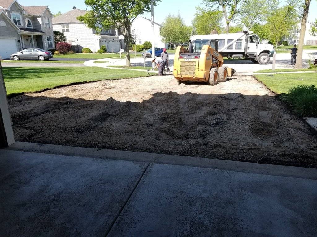

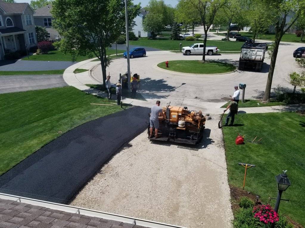

My driveway was repaved in 2018, because it had settled by almost 3" at the entrance to the garage, cracks were appearing and weeds made their way to the surface too. The builder in our sub-division most likely found the least expensive contractor to do all the homes. Many of my neighbors had the same issues.
When they tore out the old blacktop, I saw how uneven the asphalt was laid down, with some sections just 2" and other sections about 4".
The contractor we used brought in 10 yards of aggregate and rolled it with a tandem drum asphalt roller to pack it all evenly.
FWIW, what I found when looking for a contractor was that most residential asphalt companies come with a warranty between 3 to 5 years.
Check your paperwork. Hope they make this right for you.

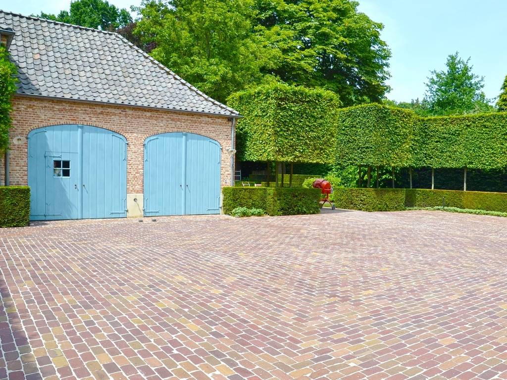

Why do you guys use concrete or asphalt………..and no bricks like we do here.......a lot.
No problems with cracks.......
( just a picture from the net ).
I'd hate to see your landscaping bill. :lol:
That is a sexy driveway!! Never really thought about brick, how does it hold up to harsh winters? And what are all the joints sealed with there, don't they usually just use a very fine sand?
