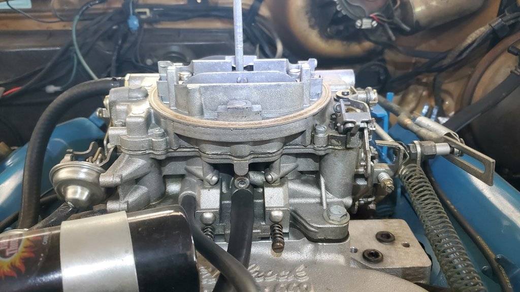

Dry Carb after sitting for a week.

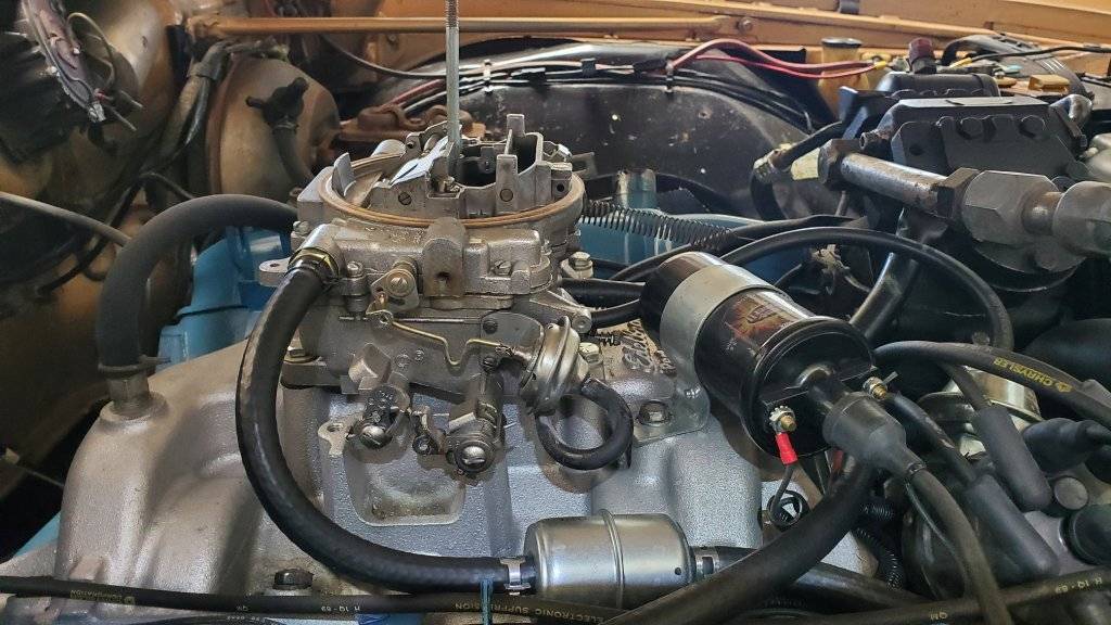

69 Chrysler 300, 505ci, 4640S. Everything is new or recently overhauled, new fuel tank, fuel lines, fuel pump, 4640s overhauled by Woodruff, newly overhauled engine, distributor, coil, etc.. The choke is not hooked up and is open all of the time. It's Texas, it's hot, it's not the issue.
When you drive the car daily or every couple of days it starts right up. Two pumps of gas, crack the throttle blade, crank it and it fires right up, idles and drives as it should.
If the car sits a week or two, it would need to be cranked for 15-20 seconds before starting. I had spark, but no gas.
Went out today after sitting 10 days, two pumps of gas as I looked down the carb, no gas spray from accelerator pump. Pulled fuel line from carb, cranked the starter, took about 8-10 seconds before I got fuel to pump out of the line.
It appears that the fuel is draining down back thru the fuel line and leveling with the fuel tank. I wouldn't think it could siphon fuel out of the carb though. There is never a fuel smell in the garage.
Once fuel gets pumped back up to the carb, car runs and starts as it should until it sits for a week or so.
What gives?
Thx
