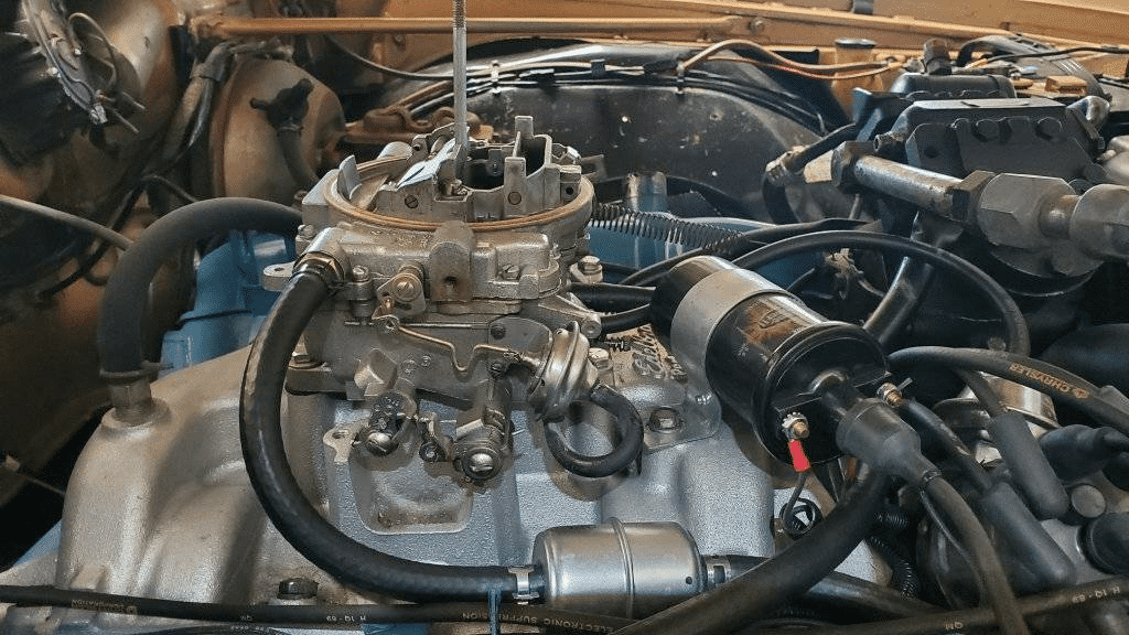

69 Chrysler 300, 505ci, 4640S. Everything is new or recently overhauled, new fuel tank, fuel lines, fuel pump, 4640s overhauled by Woodruff, newly overhauled engine, distributor, coil, etc.. The choke is not hooked up and is open all of the time. It's Texas, it's hot, it's not the issue.
When you drive the car daily or every couple of days it starts right up. Two pumps of gas, crack the throttle blade, crank it and it fires right up, idles and drives as it should.
If the car sits a week or two, it would need to be cranked for 15-20 seconds before starting. I had spark, but no gas.
Went out today after sitting 10 days, two pumps of gas as I looked down the carb, no gas spray from accelerator pump. Pulled fuel line from carb, cranked the starter, took about 8-10 seconds before I got fuel to pump out of the line.
It appears that the fuel is draining down back thru the fuel line and leveling with the fuel tank. I wouldn't think it could siphon fuel out of the carb though. There is never a fuel smell in the garage.
Once fuel gets pumped back up to the carb, car runs and starts as it should until it sits for a week or so.
What gives?

First things first..rubber fuel lines resting on engine..not good. Cause fuel perculation and not to mention a fire waiting to happen.
Repop steel lines are available and recommend heat sheathing.
Secondly, get either an electric choke or manual choke cable. Regardless of outside temps, as you may already know a working choke does help in quicker start-ups
As others mentioned, todays fuel blends do evaporate and empty float bowls is a common thing nowadays when cars sit for any extended period of time-- my C's do that.
I spray brake cleens down the carb or fill the bowls with gas.
Pain in the *** but better than a long dry start-up.
The other alternative as mentioned is run an electric fuel pump to prime the carb.
Hope this helps.

Thx for the responses. Some of this has gotten way into the weeds.
Back on point, the Carter AVS apparently has a tendency to evaporate gas thru the bowl vent when sitting. Got it. It is what it is. I just use some Starter Fluid for the first start after sitting.
Choke - I live in Texas where the temps for most of the year are 60F-105F, the choke isn't really required for a normal start. Running a manual cable or re-fitting the carb with an electric choke is more work than necessary.
