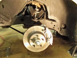

When they say that this kit cannot be used with the factory magnum wheels, why is that? Is there an offset mismatch or is there a lip inside the back of the magnums? I assume one could use aftermarket magnum wheels in a 15" without issue?
With most conversions, the calipers rub on 14s, but 15s usually clear.When they say that this kit cannot be used with the factory magnum wheels, why is that? Is there an offset mismatch or is there a lip inside the back of the magnums? I assume one could use aftermarket magnum wheels in a 15" without issue?

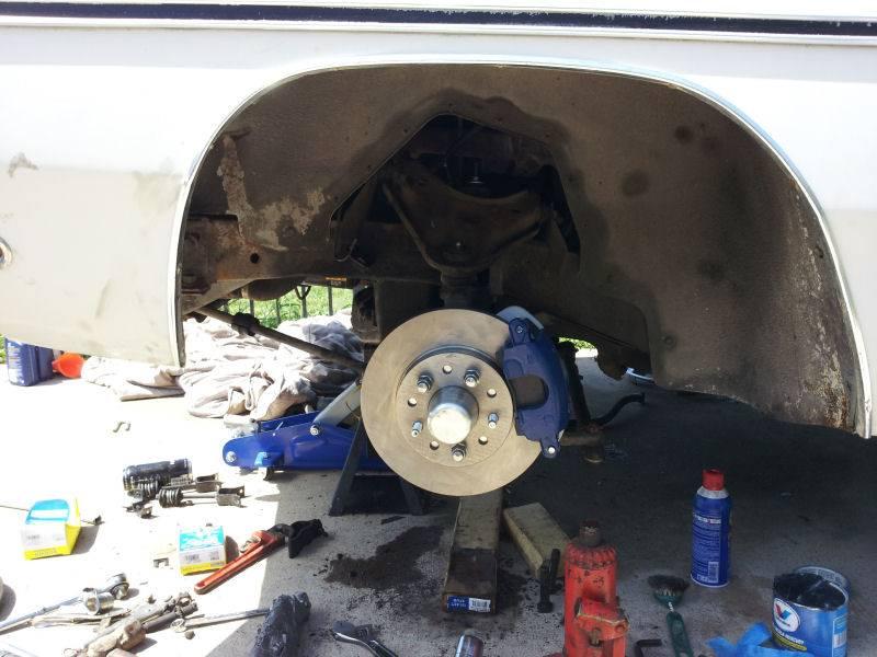

presto! no more drum brakes:
View attachment 11624presto! no more drum brakes:

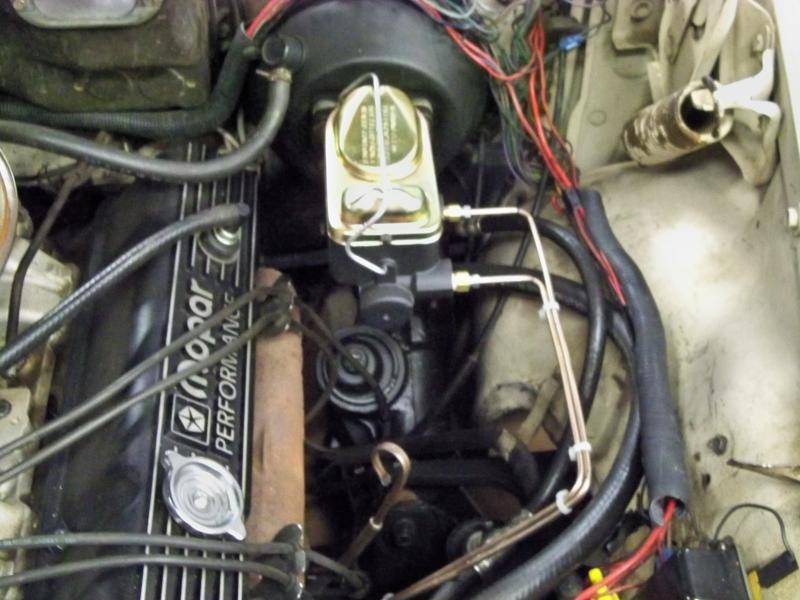

The rod from the booster to the M/C has a threaded adjustment on the M/C end. You turn it in and out to lengthen and shorten it as nec.
Another question to the experts.
I had to remove the rubber thingie in my new M/C for the end of the rod to fit in it.
Should I have not removed it??
