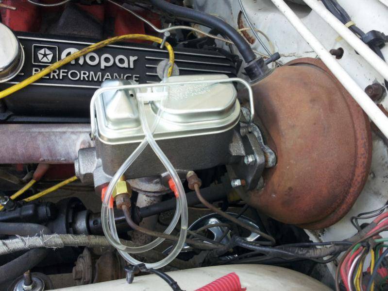

well, hell. I changed the MC today, and the booster has to go too. There was/is a little piece in between the booster and MC - its just labeled " filter" in the manual . .. it literally crumbled when we took the MC off... sigh. it was some plastic looking thing. without it there is about 1/4" gap between the MC and booster. And the booster piston arm is all rusty looking. And if you peek inside the booster, there is detritus in there . . .
of course, I didn't buy one. And of course, its special order. Wont be here until tue - wed. I hope it has this 'filter' piece.. otherwise, im not sure what im going to do. Maybe take the MC and booster back and buy a combo unit already stuck together.
sigh.
well I maybe got all discouraged too soon... it maybe really is just a filter and housing. the other site had a post that said this is a midland ross style, and there is a plastic housing and filter in between the MC and booster..when the booster boosts the air pressue changes from the bellows goes in / out this hole... I figure the filter is long gone and what I have in hand is pieces of the plastic housing. the other post said go get a lawnmower filter, cut to size, and stick that in there. id do that, but I don't even have the housing to hold the filter.... so I may go commando. has anyone been here before and can speak about it ? thanks all -

any idea about the space in between the MC and booster where this filter and housing was?
I figure since mine was non-existent pretty much, im probably OK to just bolt on the new MC . . . but im trying to confirm that with someone who has done this before.
the last car I worked on was 1995~ and I have no one really to ask locally and no other car to compare to either,, im sorta winging it

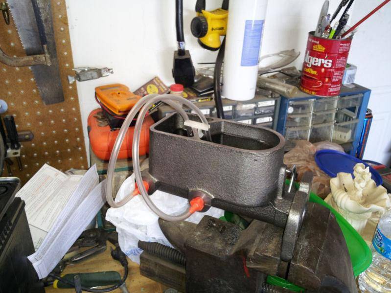

MC is on the car woohoo. bench bled it in a vise for a while, went to autozone, then got some more bubbles out when I got back . . .take your time bench bleeding so you get all the bubbles out. level the MC in the vise front to back and side to side so its flat.

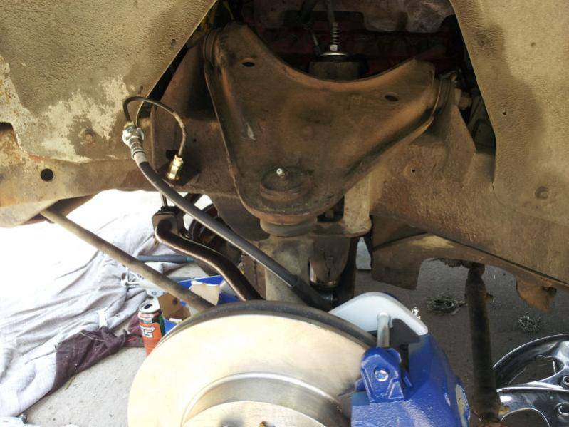

brakeline-path.jpg brake line extensions and fittings - hope the line path works OK.... don't have wheels and tires y et so I don't know how this is going to fit up yet...
Looking good, I'll be awaiting the report after the test drive. Nice work.
NO! NO! NO!
The end of the flex line HAS to be secured to a fixed point!!!
Ruptured line waiting to happen.
View attachment 11898 brake line extensions and fittings - hope the line path works OK.... don't have wheels and tires y et so I don't know how this is going to fit up yet...
It may appear as an illusion.... but doesn't it look like the rubber brake hose will or is rubbing in a couple of spots and is the hose going to be too short with the wheel turned all the way to the right?
The hose is way too short. You need a longer hose.
I guaranty you the tubing is going to rupture right here:
