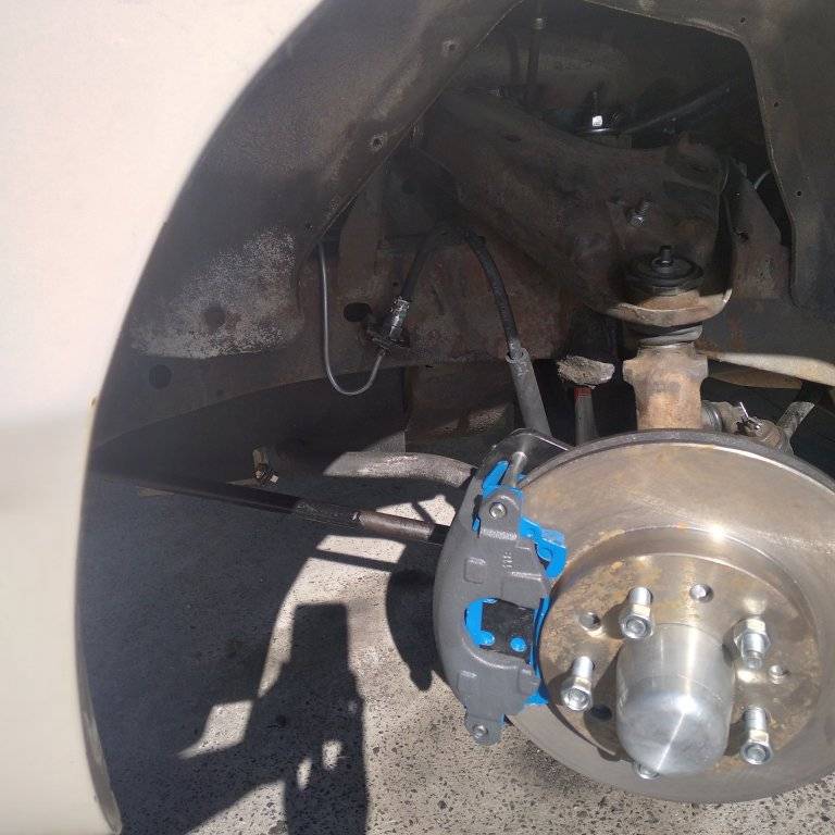

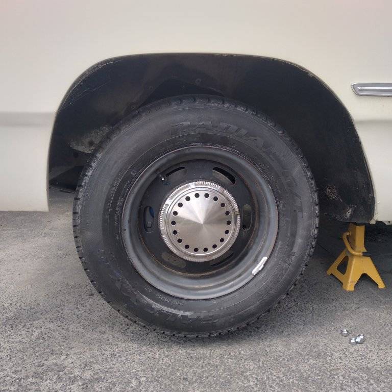

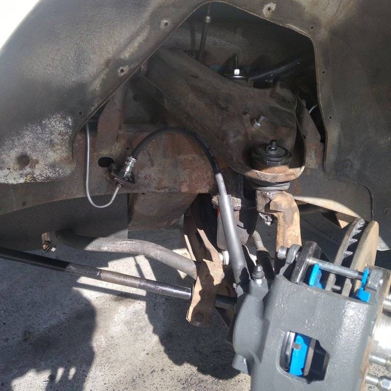

Finally had a chance to do final assembly. Here`s a short video of the 14" wheel mounted.
[video=youtube_share;7WBHRPD-C1A]http://youtu.be/7WBHRPD-C1A[/video]
As I expected, the total amount spent on this conversion was less than $200. That includes m/c, calipers, hoses, pads, brackets, rotors.
I had to turn the original hubs down in order to accept the rotors, turn the lug bolts down (the part that has no threads and is sticking out of the hub) and I had to get longer spindle bolts to compensate for brackets thickness.
If someone wants the CAD files for the brackets - let me know. However, I cannot be responsible if something does not fit. It worked for me though.

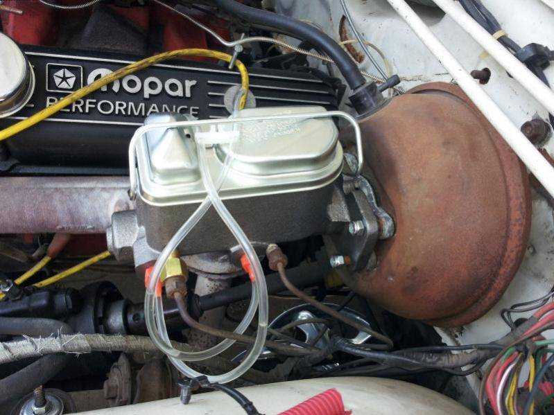

im about done with my ECI installation but the M/C fittings are giving me a problem - Im using the dual they supply in the kit. The Front fitting is 1/2-20 thread and im good, but is the rear fitting a 9/16-18 or 9/16-20 ?
I have 9/16-18 inverted flare fittings but they dont seem to want to thread properly
But 9/16-20 seems like an odd size for an OE master cylinder
thanks
I was able to verify with ECI so I figured to post for information
According to them, the Chrysler OE dual master cylinder that they provide in the kit is 9/16-20 thread pitch for rear brake reservoir and 1/2-20 thread pitch for front brake reservoir

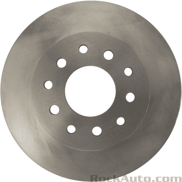

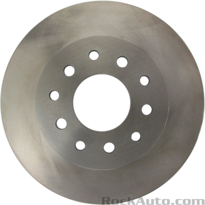

Reviving this thread 'cuz more info...from what I can tell judging by the pics on both their site and what saylor and others have uploaded, ECI seems to use the Centric/FVP 12162025 rotors for the 1979-1981 Pontiac Firebird. These are the rear rotors, and of the selection that rockauto offers, these appear to be the only rear rotors that have a dual bolt pattern at all:
The reason I think these will work is because the dual bolt pattern seen above looks exactly the same as the one that I had drilled in my Durago BR5560 rotors that my dumb *** had bought, completely forgetting the fact that those were only drilled for the 4.75 inch bolt pattern. Just having the correct 4.5 inch bolt pattern drilled out alone cost more than buying a pair of the Centric rotors...including shipping. Ouch.
Rockauto and numerous other sites claim that the center hole diameter is 71.7 mm, however measuring this up with calipers the actual size is more like 70.91-92 mm - almost identical to the claimed center hole size of the Centric/FVP rotors at 70.8 mm. Not sure why the discrepancy. As far as I can tell, the shop didn't drill out the center hole, and a test fit on the ECI hub showed that it was very snug. As such, I'm confident that the Centric 12162025 rotors will fit this kit.
