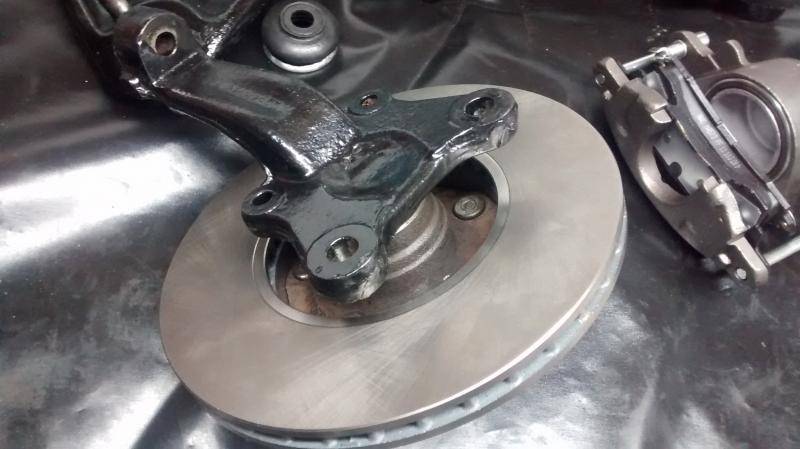

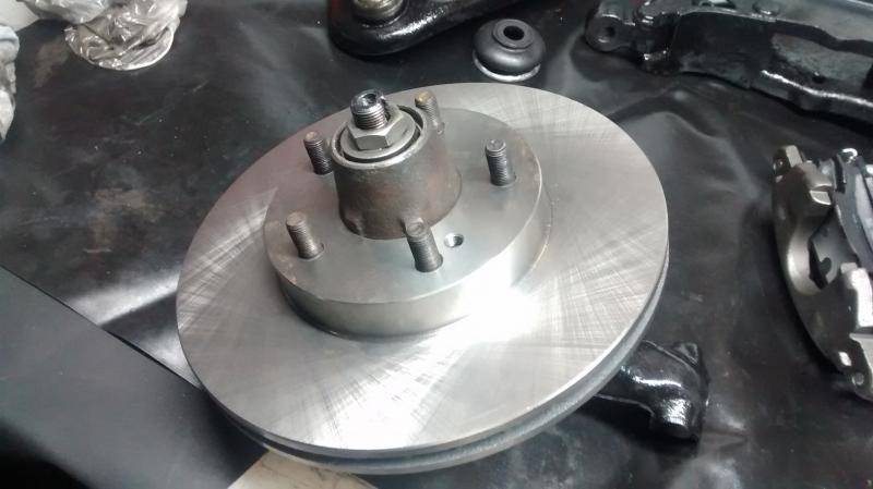

Update. Worked on the stock hub last night - I had turn the flange and the pilot diameter down on the lathe.
Here`s the pic of the standard unmodified Nissan Maxima rotor installed on the hub.
Next - make the bracket, put everything together and test fit the wheel.

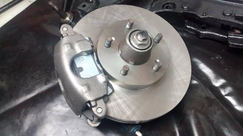

I was working on the bracket blueprint tonight and to me it looks like putting the caliper on the front side of the rotor would be better and easier - I get better clearance between the caliper and spindle and the hose length will be fine (will not have to relocate the brake line). Is there any reason not to put the caliper on the front side? My concern is the strut, but I cannot check it since all front suspension is apart now.

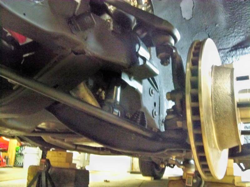

Would you have to switch the calipers and put the driver on the passenger side and vice versa to keep the bleeders on top? I am not sure about clearance but here is a old pic of mine, don't know if it will help.

Yes, I will switch the calipers left to right.
Thanks for the picture. Looks like there should be enough room.
I will make a temp. bracket out of thinner steel (I just made the blueprints) and mock everything up. Once I confirm that everything fits I will cut the brackets out of 3/8 steel.
That was going to be my question, but you beat me to it. Couldn't Saylor just have put the caliper brackets on so that the calipers would be mounted in front of the spindles, and then switched the calipers from one side of the car to the other ?
They are supposed to be on the front to allow the hose to cross the pivot axis but if you move the hard line or check everything they can go either.
