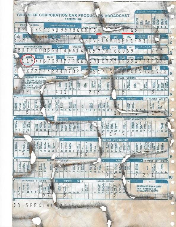

Broadcast sheet has an engine assembly code of "103" and a "T" in the VIN. I don't know what all the numbers on broadcast sheets mean, let alone what the engine assy. codes all are, but is there any significance to that "clue"?

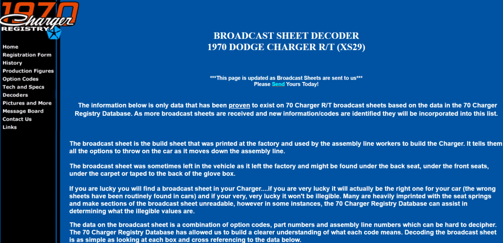

How is the broadcast sheet "decoded"? example below for our B body cousins..do C's have an analogous "registry"?
source: 1970 Dodge Charger Registry
@detmatt has it for B & Es .... anybody here point us all to it, for C bodies? what does "101" and "103" mean for C's .. last three digits of what engine assembly for mills available in C's?

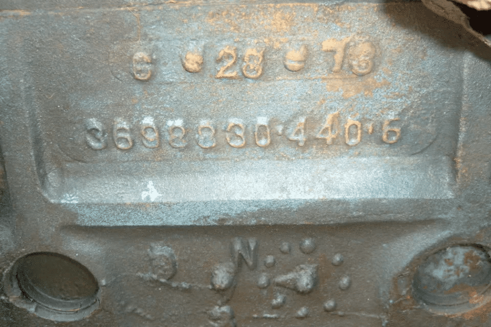

Where are the casting numberd on the bloc near the partial vin ?

It’d be the same for C’s Ray. In other words if this was a U code ac car it would have 116 on the sheet. I just don’t have the numbers for the 350 horse LP 440’s.

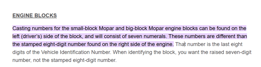

Casting number(s) (pictured) really aren't relevant to what I think this thread is trying to do. The partial-VIN would be stamped into the opposite (Passenger's) side of the block to tell whether this particular engine was original to this car. The *103* of interest (the last three digits of the engine assembly's part number xxxx103) on the broadcast sheet will not appear anywhere on the engine.
little twist there boss. :)
"103" is on the broadcast sheet. I never said look for it ON THE BLOCK. -- it clearly aint there.
I was answering the question "where is the block date code located?" If not relevant to anyone, its cool. It was part of my process to understand what's in the car. nobody needs it? Cool.
So I was using it to determine, IF the block did NOT have 8 digit VIN on pass. side pan rail, was the block a contemporary (vs. the assy date of the car) dated piece. Just offerring it up for consideration.
I have encountered this trying to figure out funny looking stuff nearly 20 years after it happened.
Picture/source I used showed where the date of the casting is located .. happens to be on same side as casting number.
In that regard, I agree casting number has little relevance ... UNLESS it was something from the mid 70's cast AFTER the car was built. Bet this months paycheck, if we learn the casting date of the HP block, it'll be somewhere logically near the SPD of the car.

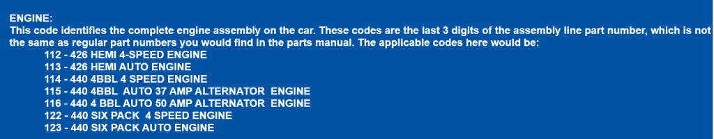

The engine assembly number is a three digit code that appears on the Brodcast sheet as well as on a 69+ Lynch Road fender tag.
While many numbers on a broadcast sheet are the last three digits of a specific part number, certain assemblies or components made up of individual parts (engines, rear axles, manual transmissions) carry only two or typically three digits. To call the assembly number the last digits a part number is over reading the numbers on the sheet.
Assemblies are built and coded based on three major parameters: body platform (A, B, C, E) whether the car had a manual or automatic transmission and whether the car had A/C or not. There are some variants found, say later in the production year when there may have been a change to a component, but for the most part, the assembly numbers are pretty consistent through a model year. Assemblies change year to year so assembly number change year to year.
Here's what we know for model year 1970 B, C and E body 440 assemblies and corresponding VIN codes. I don't have a copy of a BS for a 1970 C body U code without a/c. I presume the engine assembly number is 117 or 119 as 118 is the number for the 440-4 auto with a/c.

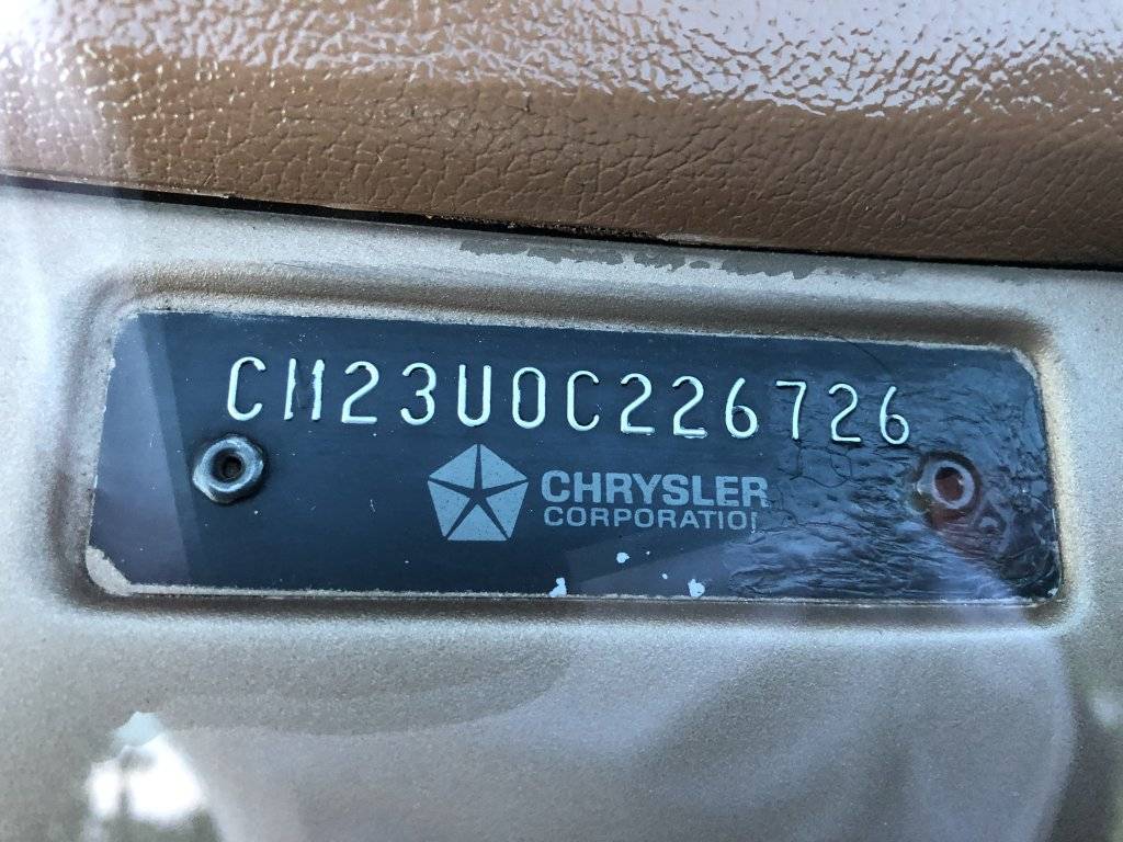

Not according to the Fender Tag he posted.

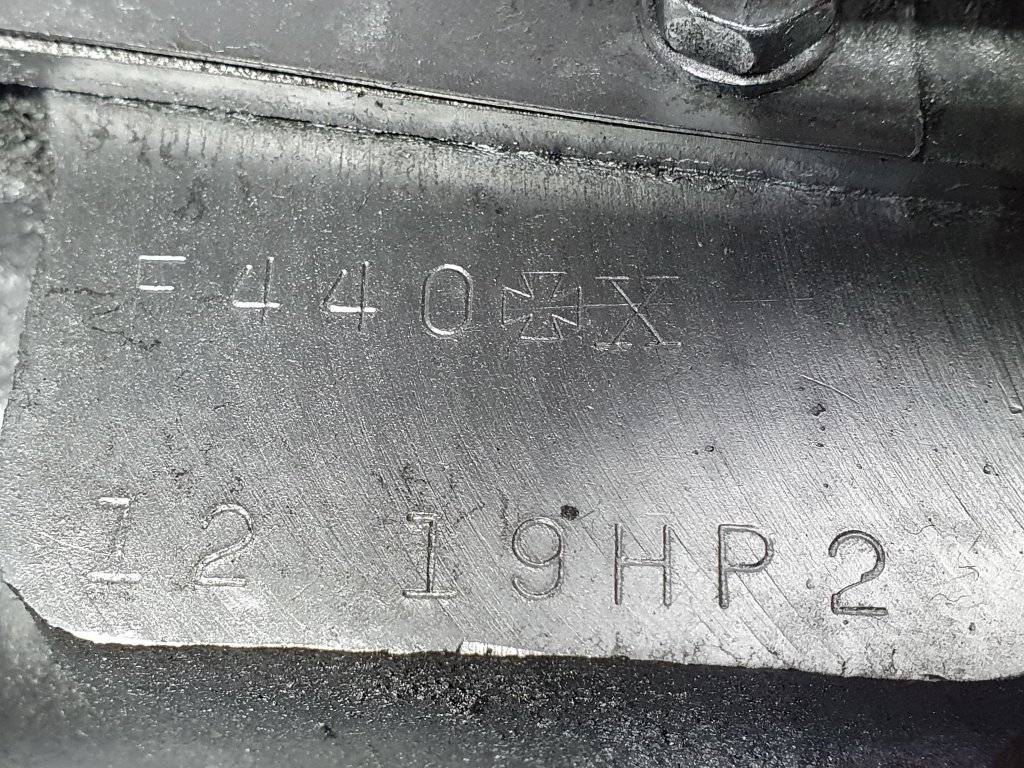

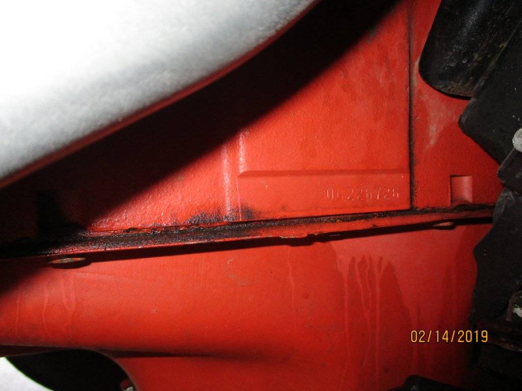

Hi folks !
i haven't posted since a lot of time but we are working on our 1970 monaco and I wanted to identify the engine.
i assume everything is matching but we cleaned the bloc and discovered the engine number with some marks.
Can you tell me about the codes ?
The iron cross and X mark, i suppose that someone did it ?
My response was based off the OPs original post combined with the picture of the HP stamp F440 block that he believed to be original.
My excitement was based off the fact that the U-code was not an option for the '70 Dodge/Plymouth civilian full size but being that the OPs in France who knows what could have been ordered if it was originally an export car.
