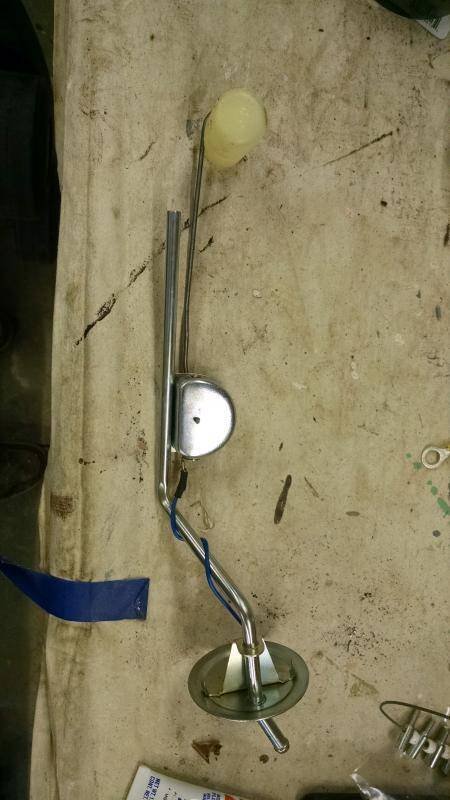

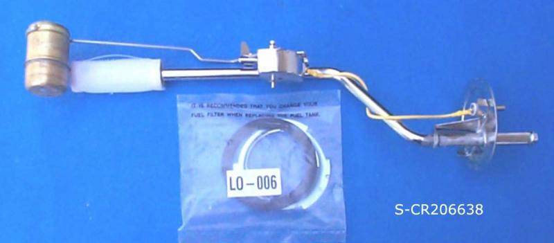

3rd I am hoping this is it. I removed the sendng unit and it is missing the sock. Is it also an extention of the sending unit along with being a filter? I have about 4 to 5 gallons in the tank. It was getting late and I didn't have more gas to pour in tank.
New unit
WOW! Thats a clean filter! Did you try to push some air through it? Yeah the sock is missing but that's not the problem. I thought that was the old one lol! I never asked what type of ignition your running?
Yes the tube is completely unrestricted. It is possible that the sock is clogged lying in the bottom of the tank, but I didn't here it fall off when I was removing it.

The sock might be stuck to the bottom of the tank and you pulled the tube out of it.

there is supposed to be a plastic cylinder thingy at the end of your sending unit pickup tube that the sock goes over. but I don't think that's the issue. sucking the loose sock up into your pickup tube MAY be an issue.
