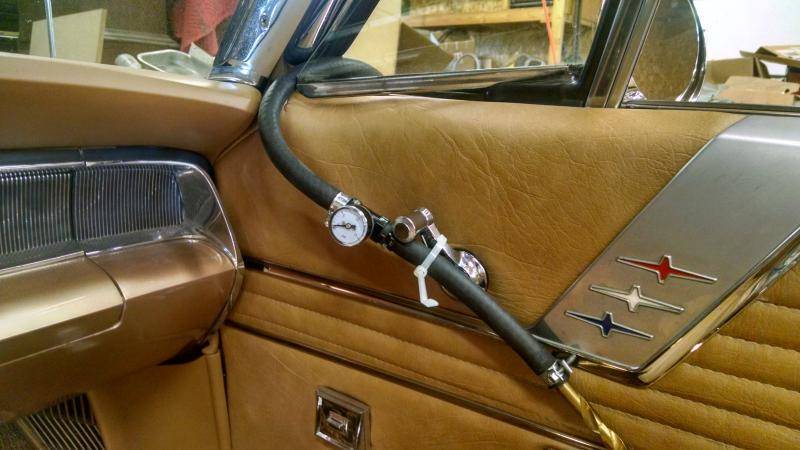

I replaced the accelerator pump early on and rebuilt the carb again. Matt and one of the other guys on the site made the suggestion of viewing the fuel pressure while driving. I am planning this weekend to insert a T in the fuel line and running the pressure gauge in my view while driving.

OK it is fuel related. I added my psi fuel gauge within viewing from the drivers seat. When I press the accelerator psi goes to 0. Thank you Matt and 65Fury440 for the suggestion.:yourock::eek:ccasion14:
Now I either have 2 bad fuel pumps or something to deal with the rubber lines added. I plan on adding a couple of 90 fitting to to shorten the line going to the pump.

I think I am going to buy a regulator and try to use the current pump. It says it doesn't need one, but 65Fury440 had put a cheaper regulator and had the same problem I am having. He put on a better regulator and problem solved.

Cool that you narrowed it down. Now there is either a suction side or pressure side obstruction you have to figure out.
Remove your fuel line before the electric pump, blow back into the tank with about 20 lbs of compressed air with the gas cap off. You should hear the air flowing pretty good, also listen to hear if it is bubbling(means your pickup is submerged).If it seems like you are flowing freely into the tank, move on. Tighten up all the inlet lines so you know it isn't sucking air.
Take it for a ride with your gas cap loose.If it works at this point, you are looking at a gas cap, vent, or pick up problem
If you still have the problem, it's probably another bad pump/regulator.I don't know if you are trying to push gas through the old mechanical fuel pump, if you are, bypass it.
Keep in mind,to set a fuel regulator, the more you screw it in, the higher the PSI will be. I'm thinking you have the electric fp working well, so you can discount that.
