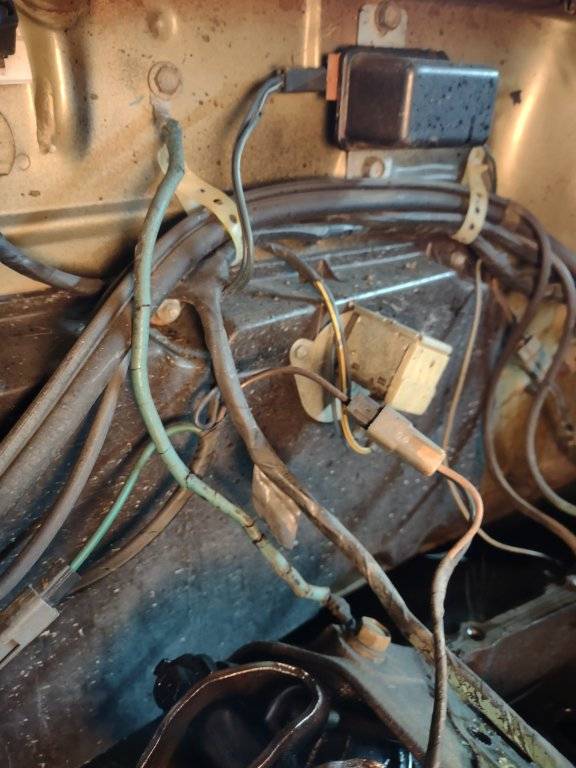

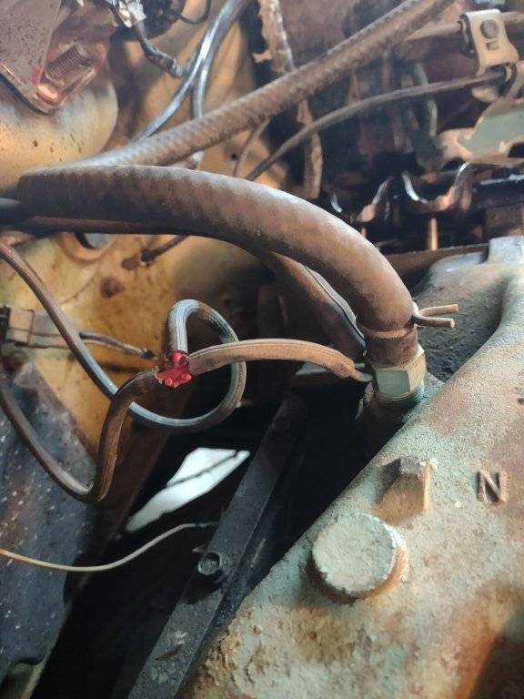

That’s your oil pressure sender wiring.

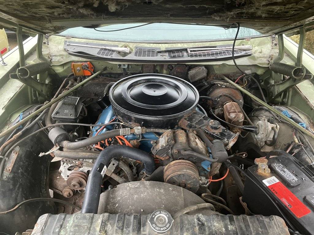

In my research 1969 and older cars have a firewall to engine ground and a battery cable. The way I understand it is the engine ground is the battery, and the body ground is the engine.
1970 and up have no firewall to engine ground and a small additional body ground at the battery that replaces the ground that would be at the back of the engine.
Ill get a better picture tomorrow. My '69 definitely has a firewall ground.
There are 3 grounds. One comes off of the battery negative terminal and goes to the body near the battery, one bolts to the engine at the front of the block, near the end of the front of the driver's side head, above the power steering pump and below the valve cover, and then the rear ground at the back of the passenger side head as described by others (including me). Other years have used the flat ground woven cable (often called a strap) on the rear, but it is not applicable in your case.
In later years during the 70's a woven cable (strap) was used (74 up) and also when grounding hoods et etcetera for heavy duty police cars ( same era) so as to reduce electrical interference. Also not needed in your case.
you should have more ground straps than one would think. the more the better. scrape off any paint before grounding. just my 2 cents.
That’s correct for 69 and older. 70 and newer will not have that wire. 70 and newer has a body ground at the core support that is part of the negative battery cable.
I did a concours restoration on a 69 Charger. You can see the ground cable.
Then my 72 Imperial you do not see a ground cable to the firewall.
