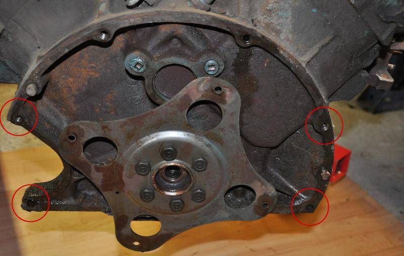

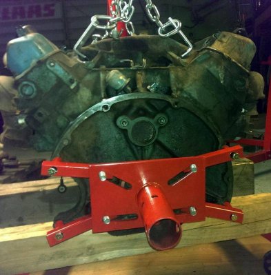

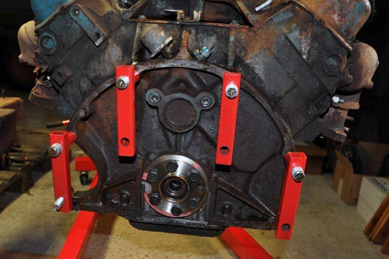

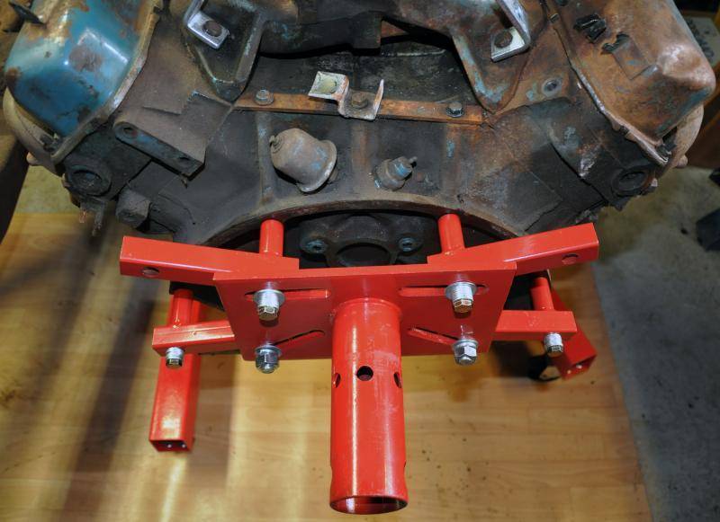

Yes you can use nuts and bolts on the lower holes. Give up on it being pretty or symmetrical, it just needs to hold your engine.
I just wish they made these things so you could get the pivot up to where the cam is, would make rotating easier.
Alan
Thanks Stan, that's great! This was my next question, if it's safe to use the four lower boltholes, because it's the ONLY way my enginestand fits on the engine.
I wish it would be symmetrical centered to the cam, like I saw it in one of his videos (https://www.youtube.com/user/Myvintageiron7512) can't find the particular video)), but there is no way this would work with my enginestand.
But I still have to order nuts and bolts on ebay because the home store just have no grade 8 bolts, just grade 5...![]()
