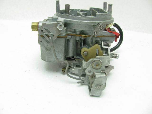

The Holley 2 bbl carburetors on those 1973 engines was notorious for running badly because over time the upward tension of the air cleaner wing nut pulling up on the stud mounted to the air horn of the carburetor warps the airhorn upward and causes a vacuum leak that results in poor idle and off idle poor driveability. Just rebuilding it will not fix it unless the rebuilder is aware of the problem and has a way of machining the air horn flat again on the bottom side or perhaps another technique for fixing this. The only reliable rebuilder of those Holley 2 bbls in my experience is Autoline, which is available from Rock Auto. They are well aware of the problem and fix each one properly. I would personally start there, as your symptoms sound just like that issue has surfaced. It is a ***** to find unless you are aware of the issue too and know how to remedy it. If you get an Autoline carburetor, forever after, do not tighten the air cleaner wing nut any more than absolutely necessary to prevent the problem again in the future.
AUTOLINE C7107 {Click Info Button for Alternate/OEM Part Numbers} Rochester 2 Barrel; Reman Info
2BBL; H2-2210
By the way, the listing says it is a Rochester carburetor, but that is incorrect, as it is a Holley 2210 model, but the Autoline rebuild is the one to get. The photo shown is definitely the Holley 2210, not a Rochester. Just FYI
I worked for Chrysler in the fuel systems laboratory as a permanent assignment and there was also a field fix issued to prevent the warpage, but few ever got the fix, which was a brace to hold the airhorn down so it would not warp. Better to just not tighten the wing nut very much in the future.
