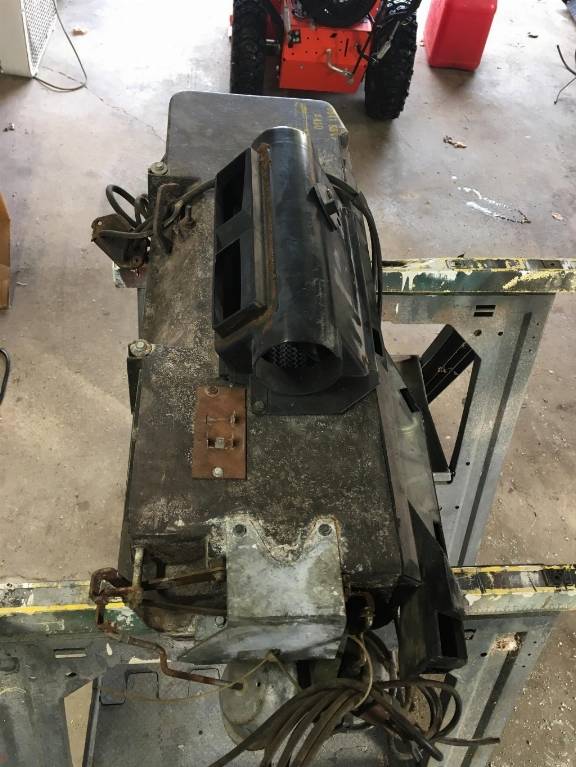

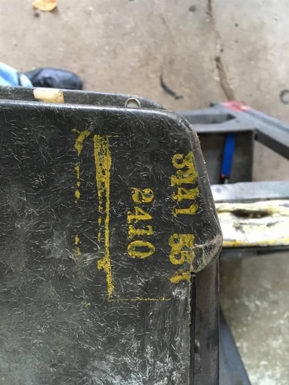

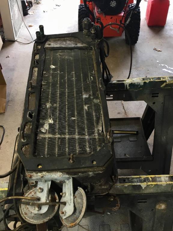

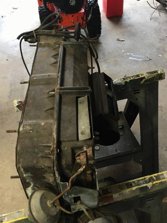

The second one is a little mystery to me. Perhaps @david hill can identify it. The part number is a little smudged so I'm not sure what it is.
For you guys that don't live where there is real winter, the red thing behind it is my snow blower. LOL
--View attachment 573762
The second heater box is definitely from a 69-70 300 or New Yorker. Note the center dash duct work is a pure give away. The center dash discharge was continued through 72 w/ slight variations on the ductwork. Reusing your cars specific duct work would allow you to use the basic three pic heater box 69 through 72 as I have done repairs using doner heater boxes parts on 69-72 Chryslers. I'm very sure the same theology can be used on full size Plymouth models 69-72. Have no experience on full size Dodge models to draw from.
I had some time this morning and did a search of my parts book and found the number, which I believe is 3441554 since there apparently isn't a number that is 3441551. That is an assembly number (not the housing itself) that fits a 1971 C body PDCY without autotemp. So with that maybe you could discern any differences if any. Thanks for the effort @Big_John !
With my experience on interchanging heater box parts your research tells me that the assembly # 3441554 or an exact matching part can be used to repair any full size PDCY (Plymouth Dodge Chrysler Imperial) Manual heater box. Without seeing an Imperial application Ican't confirm if the evaporator cores or heater cores are interchangeable.
