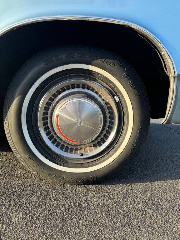

I am getting new tires today on the factory wheels. Venezia 225/70R15. These tires will also fit the future 15x7 magnums if I end up going that route.

looked up that tire. hadnt heard of it.
a great OE look, right stripe, robust size, and keeps options open for different wheel choices later.

Holy cow, Batman. An old-school tire, in 70 series, with a whitewall.
I assumed @SPF Required got the whitewall for an OE look. there is a non-descript blackwall out there too

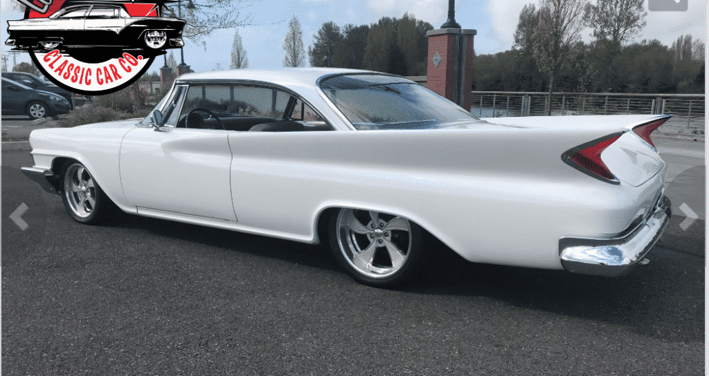

18x8 in front, 18x9 in rear. no backspacing given.

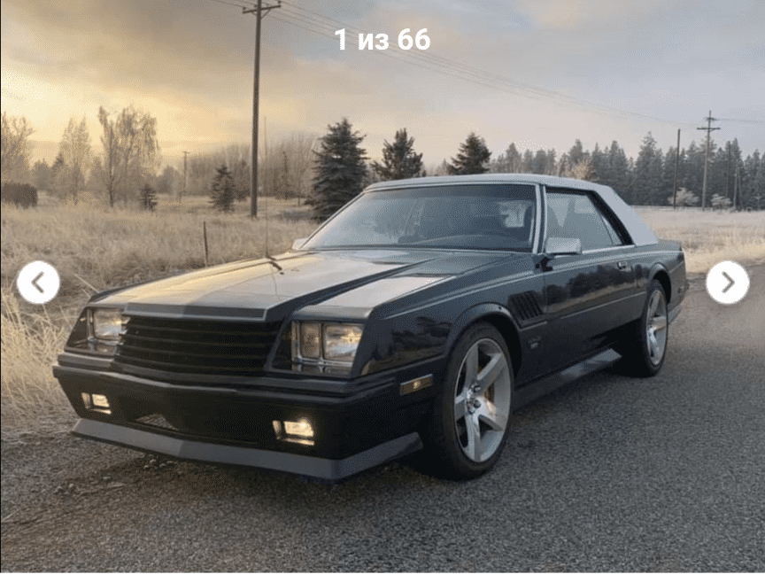

there is a C here (in the forum but maybe not in this thread) where someone did what you describe.
i used to know a guy years ago that built one of these. yes, an "M", but like "C"s, it likes 5x4.5, 4 in bksp. '80's mirada/cordoba alloys on C's are all over this thread and are a painless swap if one likes that 5/10 spoke design.
the 2006 and later model 5 x 4.5 in. (114.3 mm) b.p.Charger 17's will generally fit, but offset is much more positive than anything OEM C's ever had.
to make this M work, they did a buncha mods (to get all the ride/handling benefits of the body/chassis transplant they did).
But, without all that, you still may need spacers to "offset" the wheel offset (i would guess 6 to 7+ in. bksp depending on width of that wheel -- 8 to 10 in.?) for suspension clearance on a "C", and/or to avoid that 'spindly-leg' look "modern" offset wheels tend to display when used on vintage ('60's to '90's) cars.

Great stance on that CMX.
Yes, those wheels would not look that proper without some adjustments of some sort.
Is there a link to pics of what is under the skin on that car?

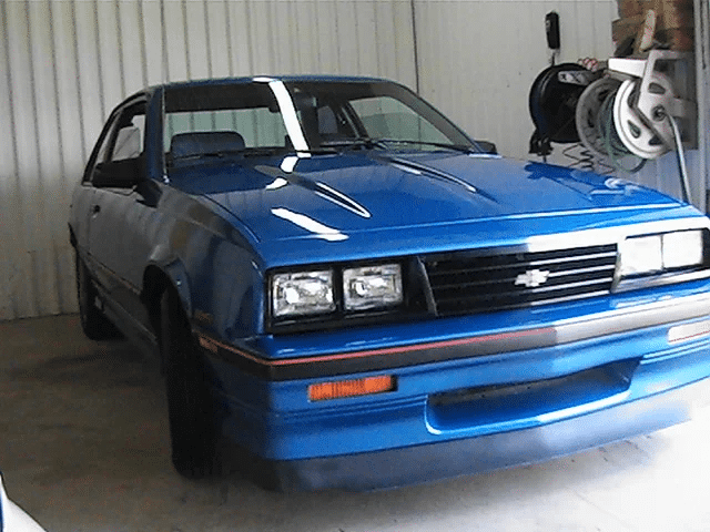

I put a similar chin spoiler on mine back in the mid-90s (an 80 'Doba with a Mirada nosecone), I had forgotten all about that.
IIRC it came of a 80s Cavalier Z24 like this.
I think there's a bunch out there. I think.
if you search under some variant of keywords "Mirada SRT/8", i would guess a few more things on this same car will show up.

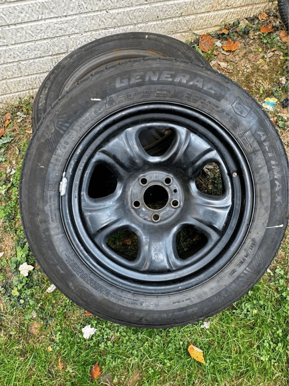

I was actually thinking of using 18" steelies, like the one pictured below, from a 2005-2006 Charger Police Car, could be same thru 2011, not sure.
But adding spacers and changing wheel studs is extra work that I really do not want. I can just go with police rims 15x7.
