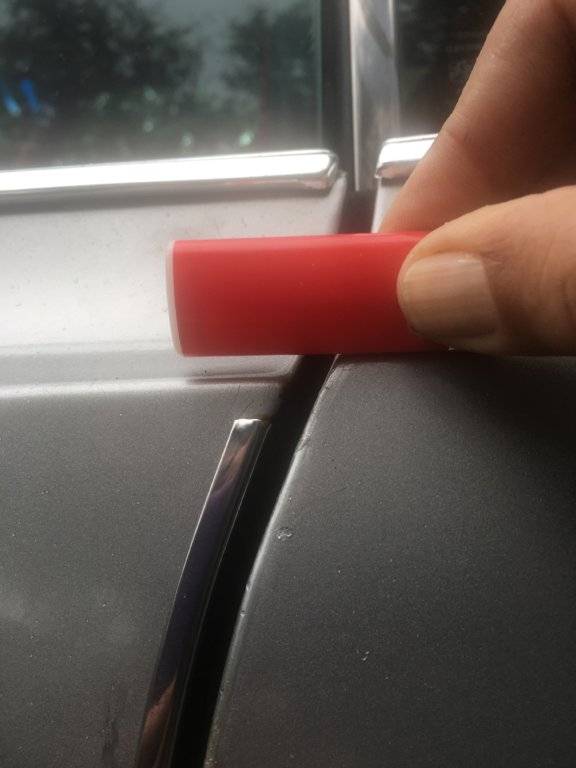

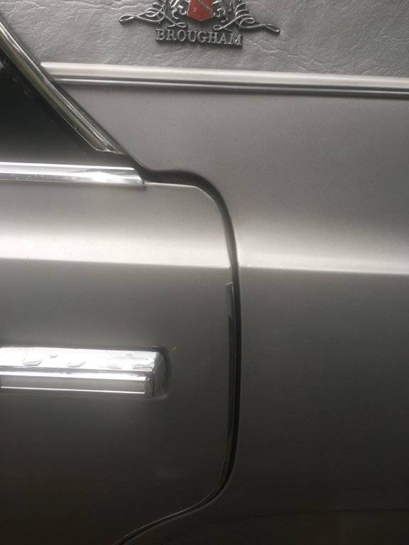

Started at the rear passenger door. It sat a good 3/16”+ below the fender and roof. I was able to move the strike out for part of it but will need to rework the base for at least 1/16” more. Also the edge fit for s crappy. I would want to weld in a wire along the edge to get it closer.
Here it is with the strike moved out all she’ll go.

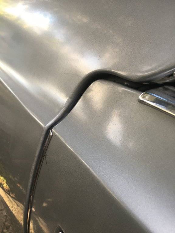

Front of same door is again lower than the rear of the front door. Was able to raise it a bit
Took the difference down by half. Better .... but not there. Again I hit the limit of adjustment here too. Next would be to rotate the front door a bit. But in reality, to get this right will lake shimming and then adjusting the glass.
This is as good as I could get it in the limited provided adjustment without resetting the windows. Again..... better; but not there.

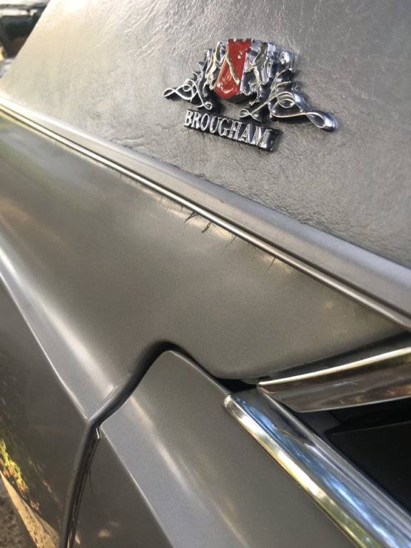

I would strip the panel to bare metal as there looks to be some bondo just below the trim line under the "Broughm"script. If the rear quarter was hit as some point, that would explain the poor fit for the door. If the seam was pushed back in a collision, it might not have been properly reset. A lot of body shops fix that type of error with filler.

Thanks Dave.
I’ll check but I don’t think so.
I’d love to see the original assembly manual to check some tolerances I think are off with the fender as it’s welded to the door jamb as both have the same problem to some degree.
Also...that alignment is off for the entire belt line in steps up to the fender. Both sides. The difference is that the drivers side has the rear door higher than the front.
Interestingly, the strike and the hinges do not look like they’ve ever been touched. Also, the torque on the bolts was varied on the hinges. Some were tight and others more like just snug. Like 30-40 ft.lbs versus 10.
I need to first check the fender and hood tomorrow to see if there’s anywhere to go with them before I tackle the front passenger door. If no play in the fender and hood to go down, then the front edge of the front door would need to go up and the rear go down by about an 1/8” to work. I would then need to realign the front window as the change would bring the top of the front window too close to the rear window to marry up even and parallel.

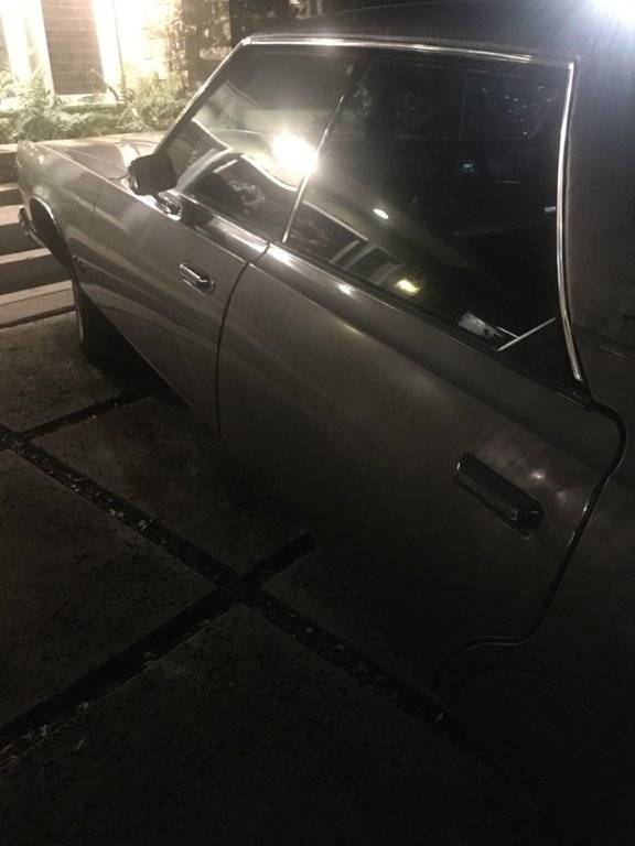

F&@ked with it some more but it got dark on me.

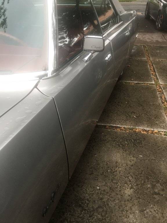

**** day raining off and on. Here you can see what I’m up against. Front fender to door is almost ok but the drop of the front door at the rear is something to behold. The front door leading edge is also a bit proud of the fender.
The rear door is almost acceptable at the rear with maybe a 1/16” low.

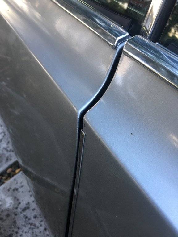

Here you can see what I mean between the rear of the front door and front of the rear door. The view from the rear view mirror has always made me cringe.

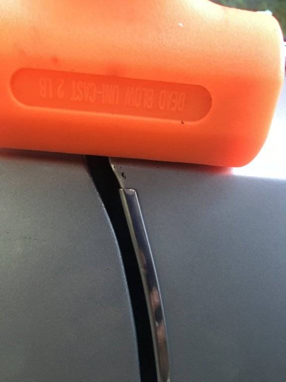

Detail of the rear almost ok but just a touch low. Slight relocation of the strike made this go away.

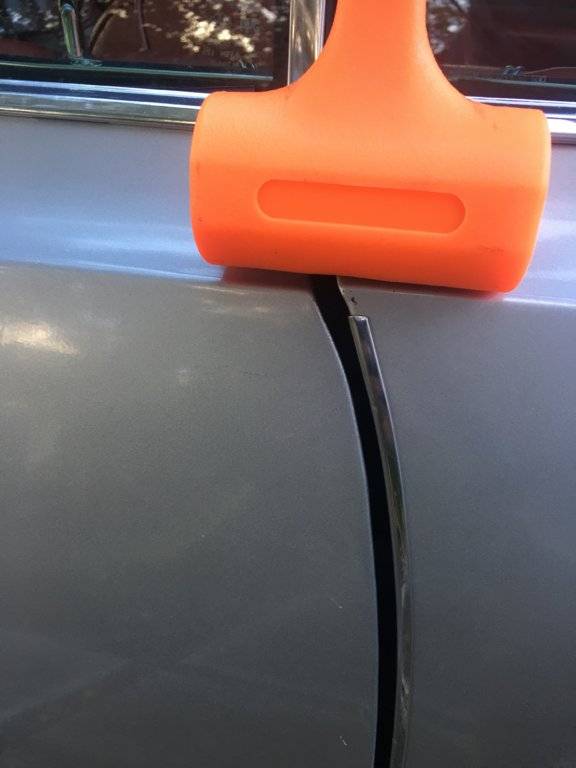

Here’s the difference with a strait edge to show the drop. Checked the door hinges and they are tight.
A little loosening shimming and only the tiniest of bashing later.... better.
