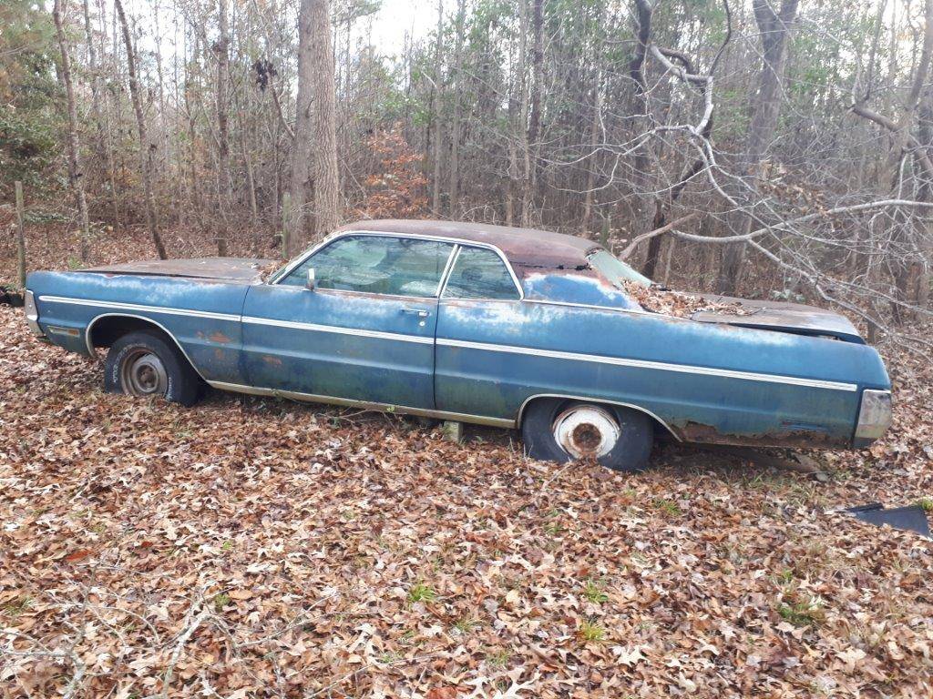

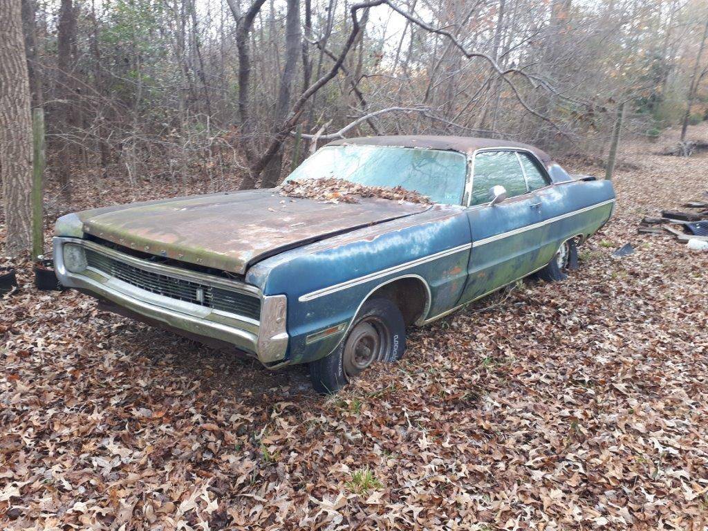

Car came with a stack of registrations, receipts, and paperwork going back 1971 and the window sticker. Looks like it got parked in NC in 93’ shorty after the then Marine or Navy Officer got stationed there. The car was sold new in Washington. Between the snow, and being parked in a swamp for about 26 years, I dont think it had much a chance. @Aidan1976 How does your sport fury in Gary’s yard look? Same body and color IIRC no?

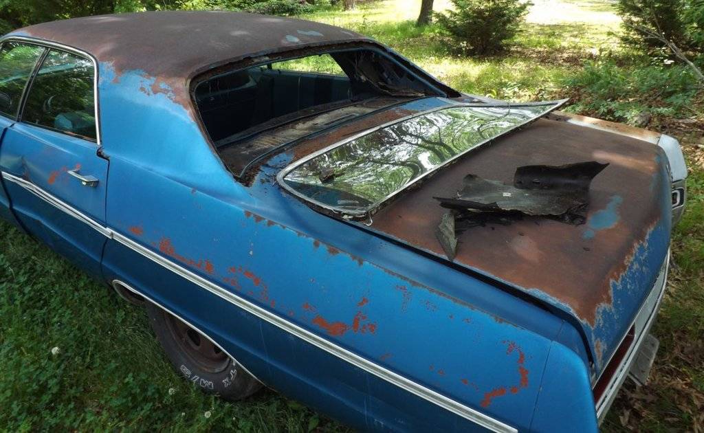

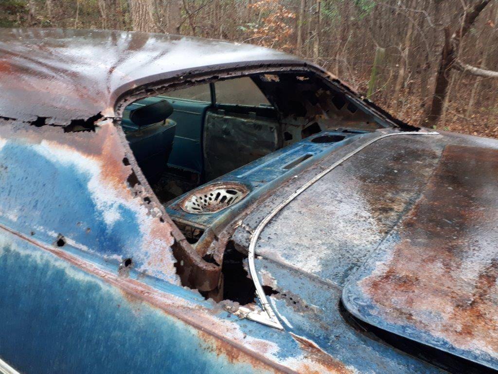

Hey mate. How does the '70 Sport Fury parts car look? BAD, very bad. Just kidding. Yes, it has the same roof style as your parts car. And it is B7 'Jamaica Blue' from memory (or maybe B5, just can't put my hands on the fender tag photo at the moment). Here it is after some partial stripping during my visit to Gary's in December (the rear window too also basically just 'fell' out of it):

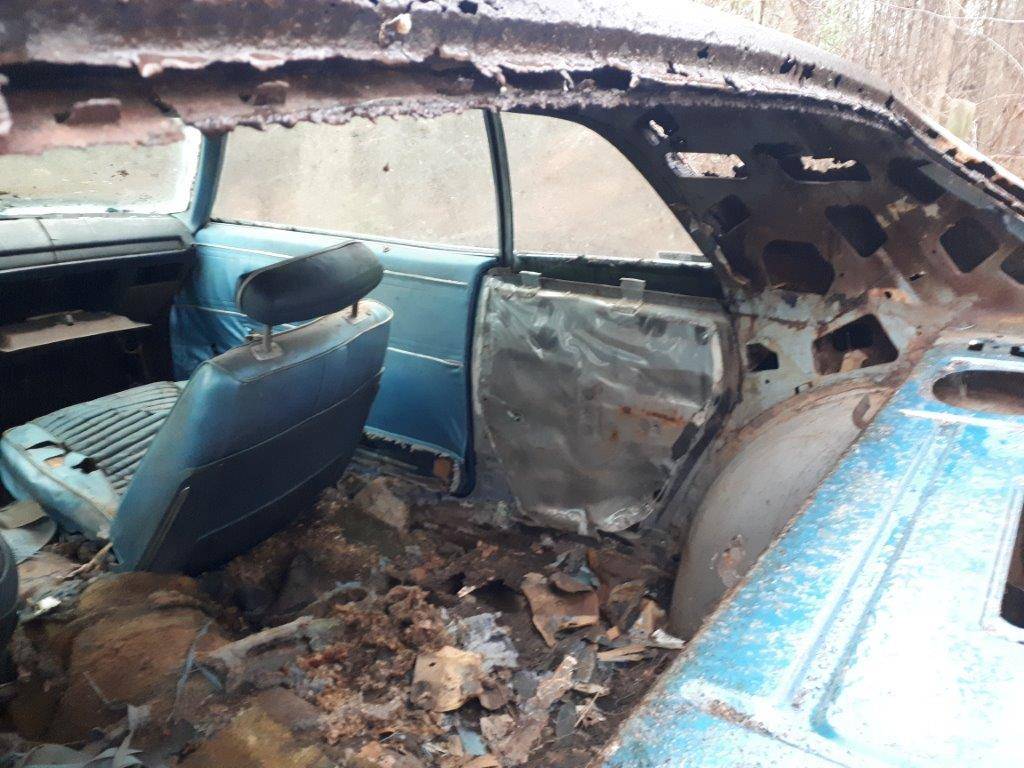

DISGUSTING inside. We both had to get tetanus shots after this (can see how the 4-Door body shell was used for the 2-Door, with that inner piece & door jamb welded in, then 'covered' with the 2-Door quarter panel):

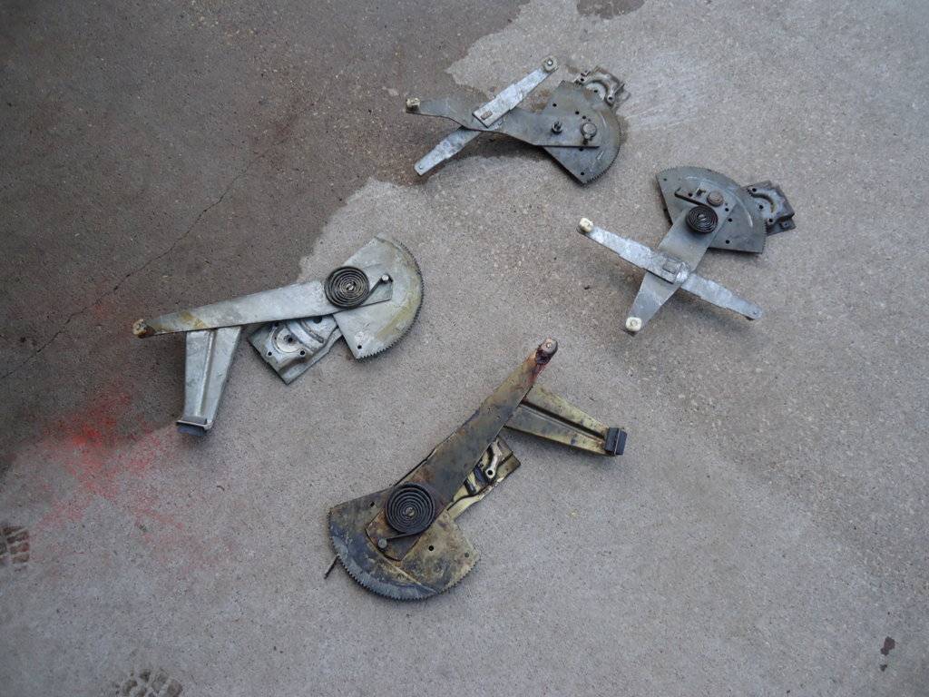

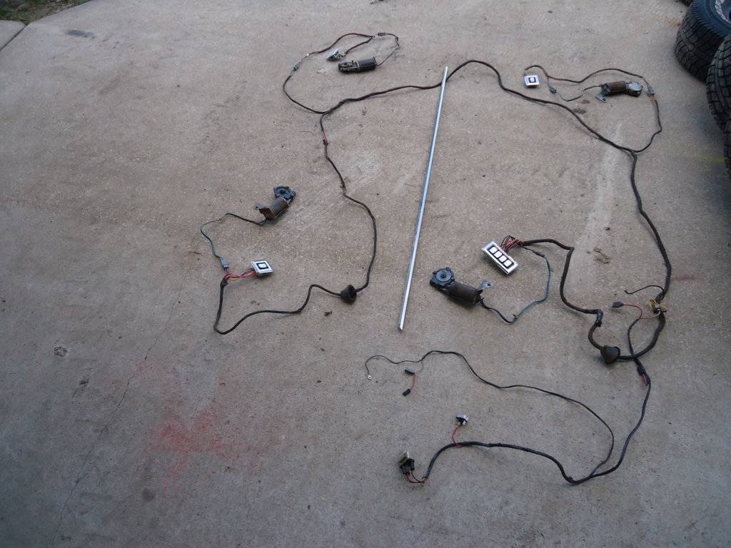

Who else hates crank windows? Well I for sure do.
So I’ve been sourcing parts for an additional conversion. So far I have the window regulators, all 4 switches, wires, harness, window motors, the relay and circuit breaker.
What other specific items do I need? Do I need special switch pockets?

The switches will fit into a housing that is mounted to the door card, of which has the holes in a different place to the window winders. So you may be up for door cards too.
I wanted to change the interior color but was gonna keep it cheap and decided against it. If I’m in new door cards, then i might as well be in new seat covers. :realcrazy:
Are the guide tracks different for power windows? Also mounting pockets I had the suspicions. Do the housing for the pockets unmount? I’m trying to picture them so I can source them. I want everything to complete it the correct way.
They slip through from the front of the door panel and have metal tabs that are bent over the back side to secure them in place. You will just need to have someone either cut out the metal pockets, or have someone pull them out carefully. Should be the same units used from 69 to mid 70's..??
The tracks and such should all be the same, your only replacing the actual up/down mechanism with a power unit.

While you're at it, I would put individual relays on the motors (8 total). Big John had a write up on it.
