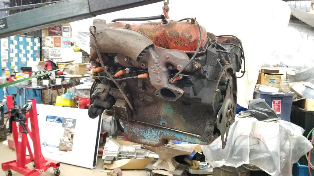

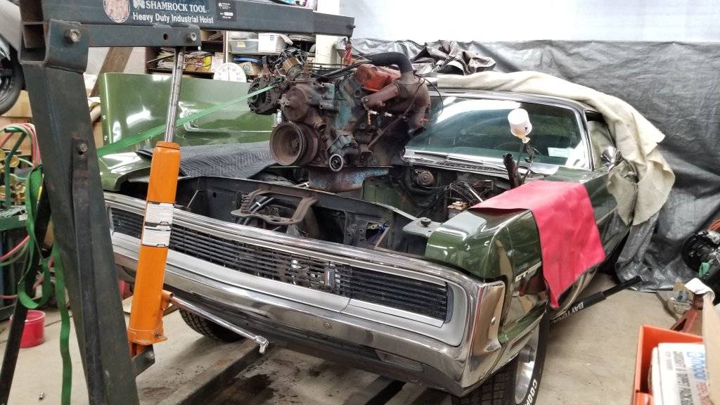

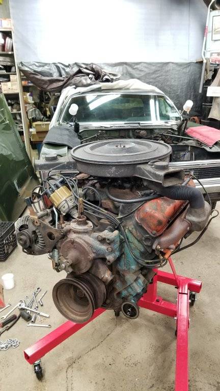

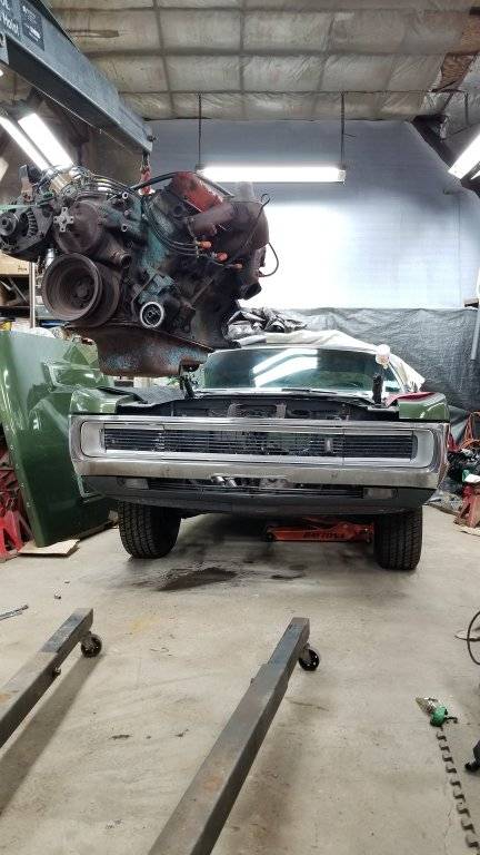

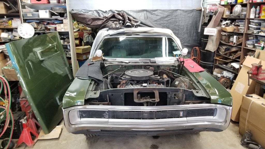

Spent last Saturday afternoon plucking the original 440 out of the car to finally see what went wrong and how bad.
Oil pump seized from the 50 years of sludge/grit coming loose & going through the rotor.

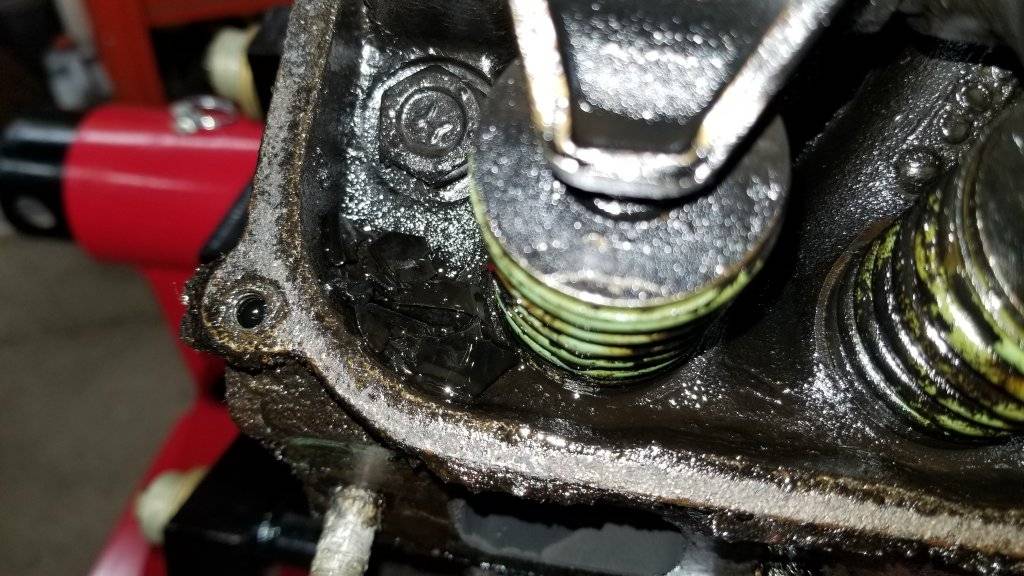

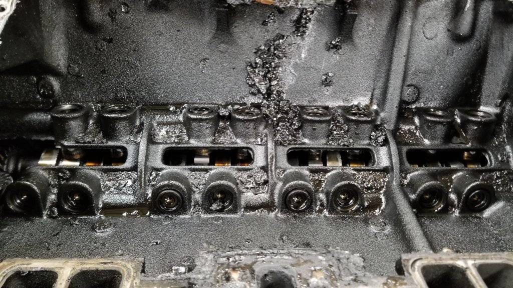

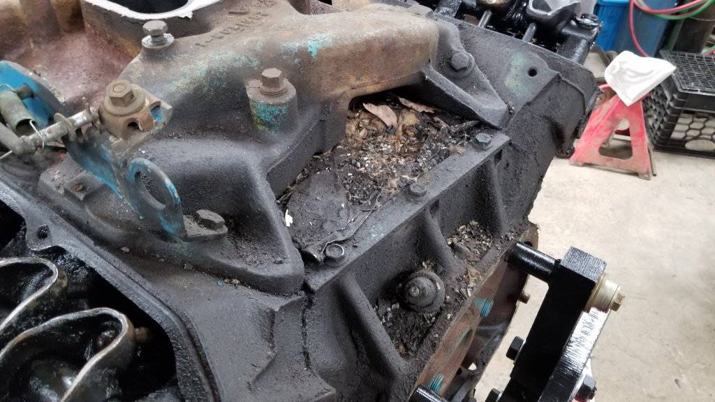

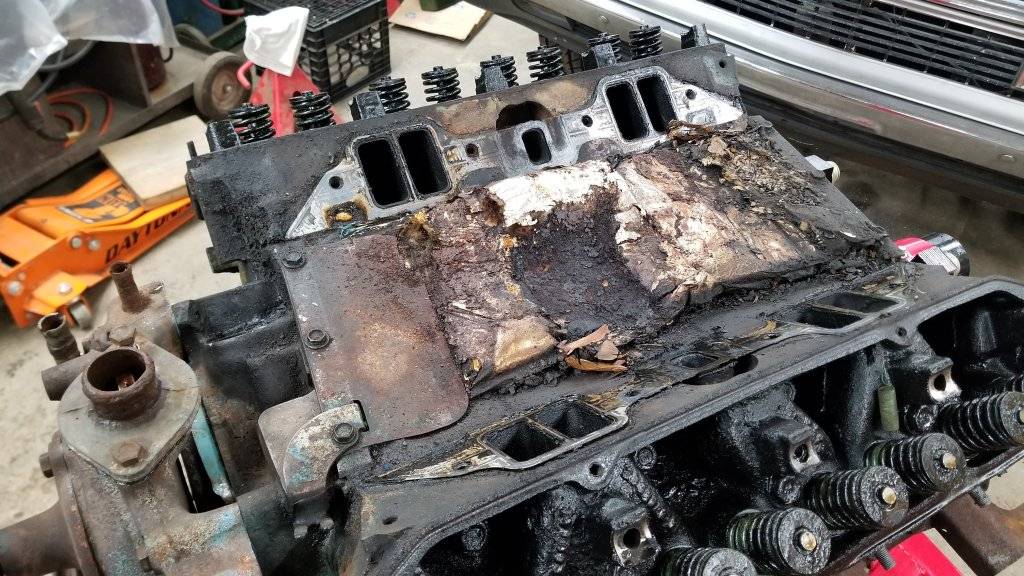

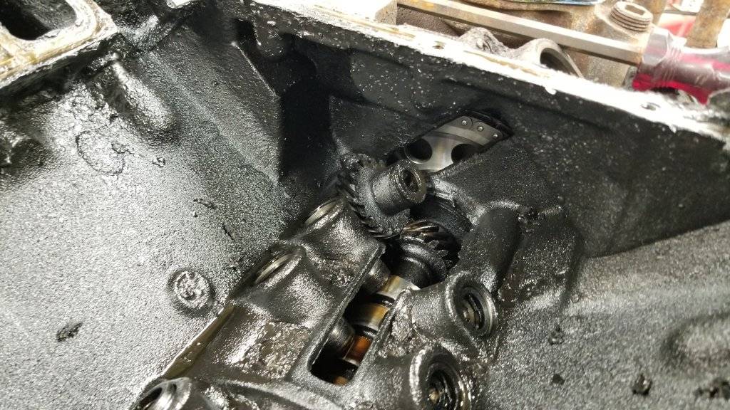

Found lots of nasty sludge/carbon buildup in the valley when I popped the manifold tray off. But its what I expected to find.

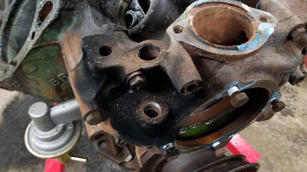

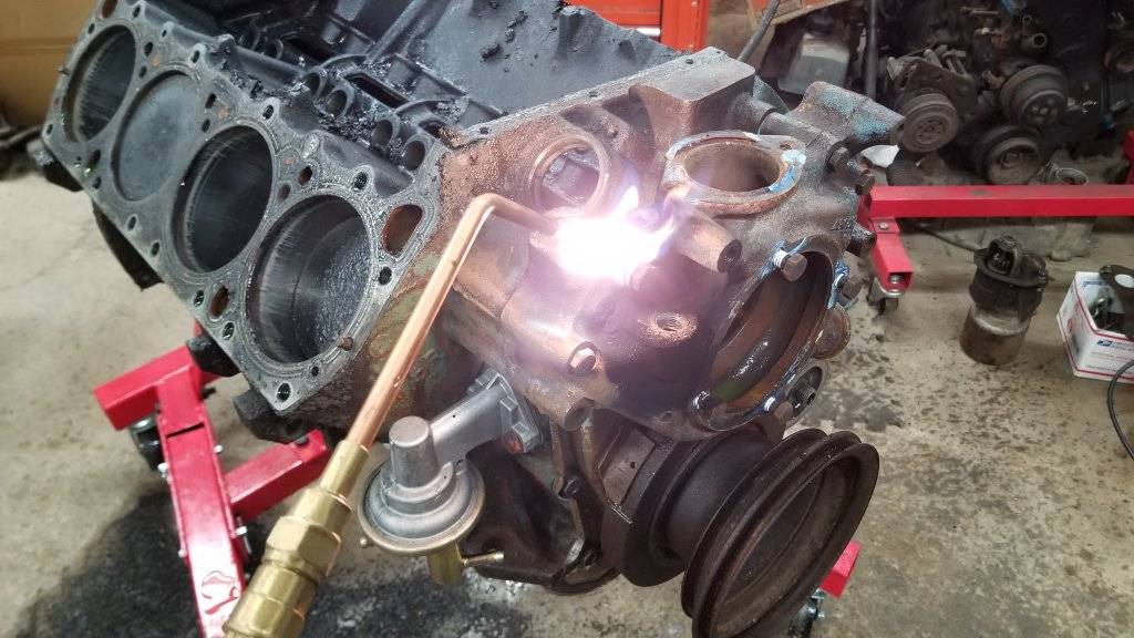

Broke the torch out to remove the water pump fittings. The hose barbs were pitted bad and very tough to get the heater hoses to seal with the factory style clamps.

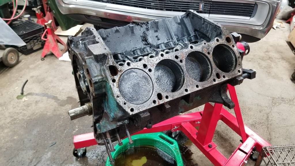

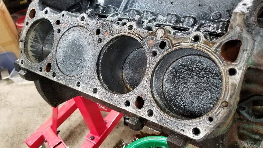

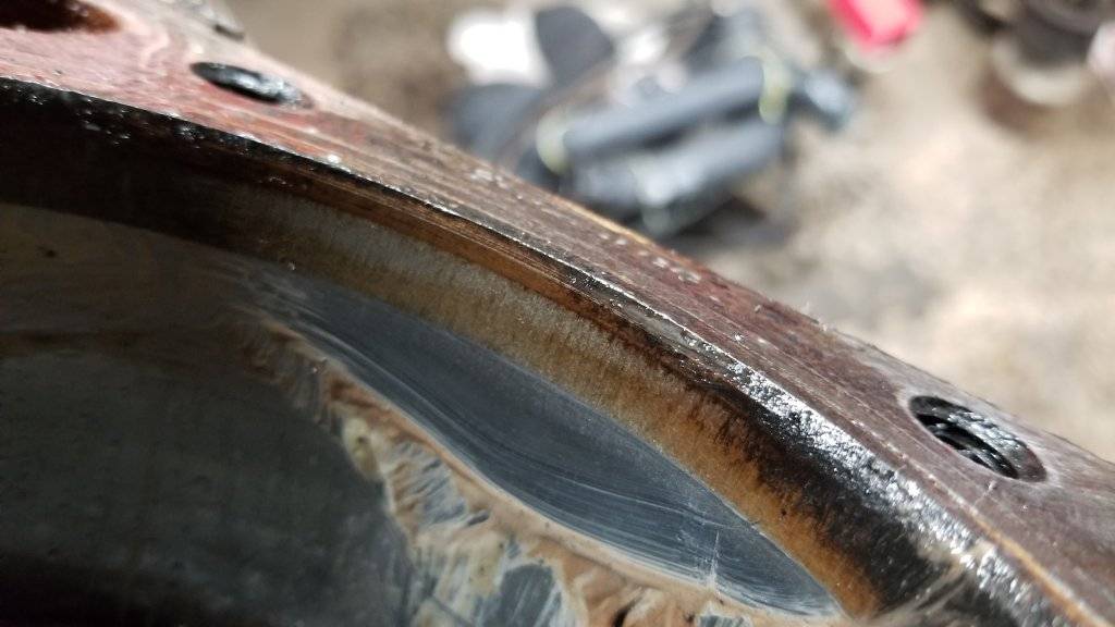

Pulled the heads to check the cylinders. Looks like a 95k mile engine inside. Almost no trace of the factory cross hatching and there is a slight ridge at the top of the bores.
