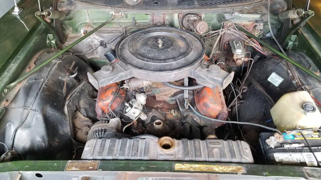

Warmed up just enough here in NY to go ahead and take care of a few maintenance items on the GT.

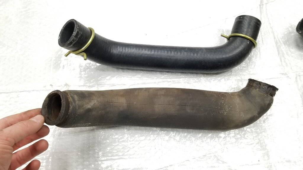

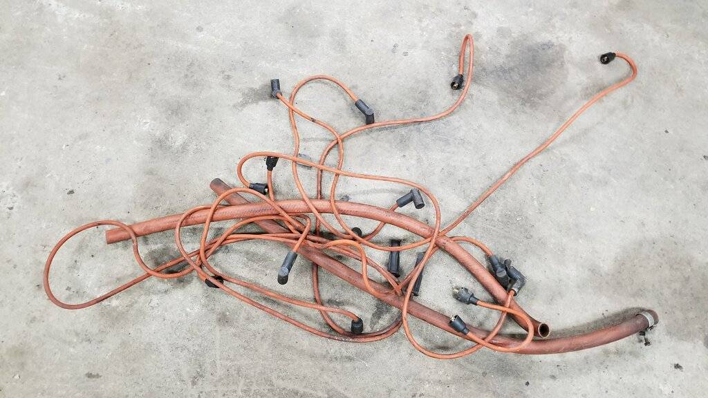

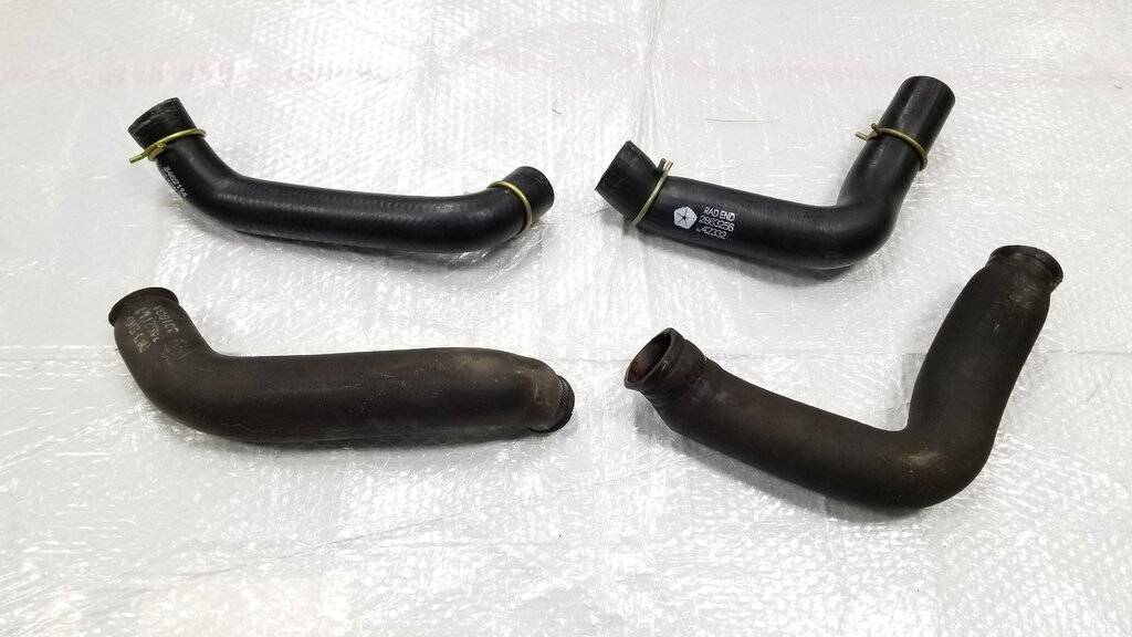

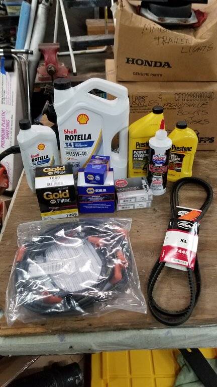

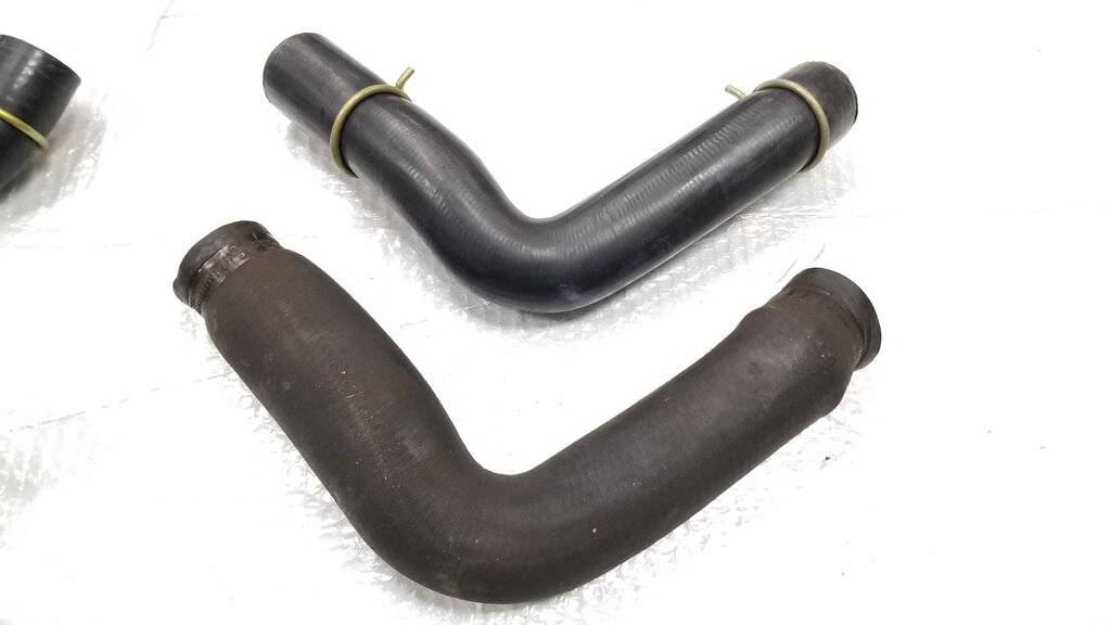

New NGK plugs, repro wires, cap/rotor, new alternator & power steering belts, oil change. Also picked up some reproduction radiator hoses to replace the swollen and ready to burst originals.

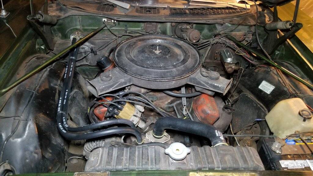

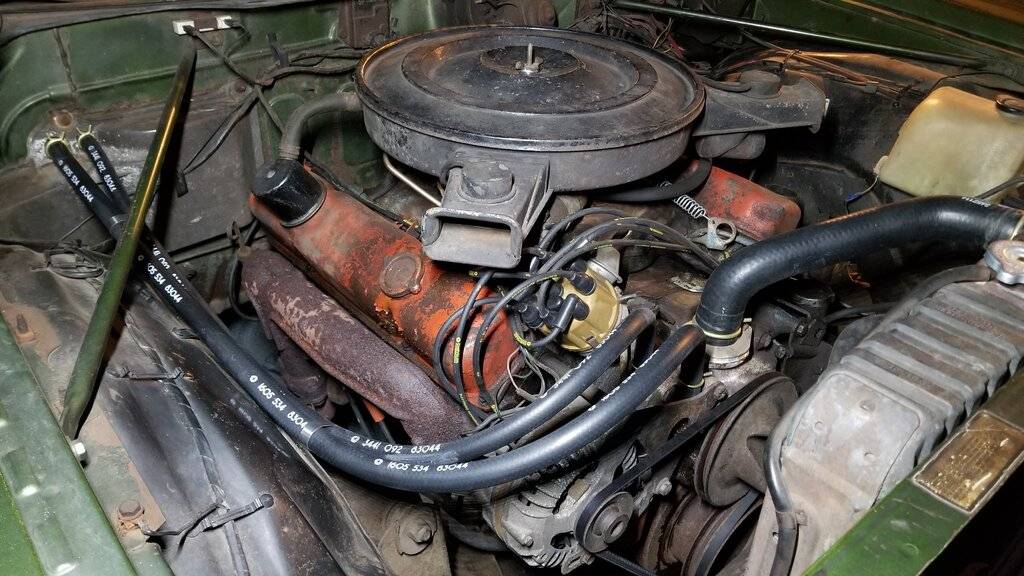

Everything installed, reproduction heater hoses too (need to get a repro strap that holds them to the fender well).
Even found the original log exhaust heat shields from the convertible so I threw them on there for the time being. I do fully intend on installing a set of HP manifolds when the time comes to do the exhaust.
Gah, I absolutely hate color wires/hoses. Seeing them there annoyed the hell out of me lol.

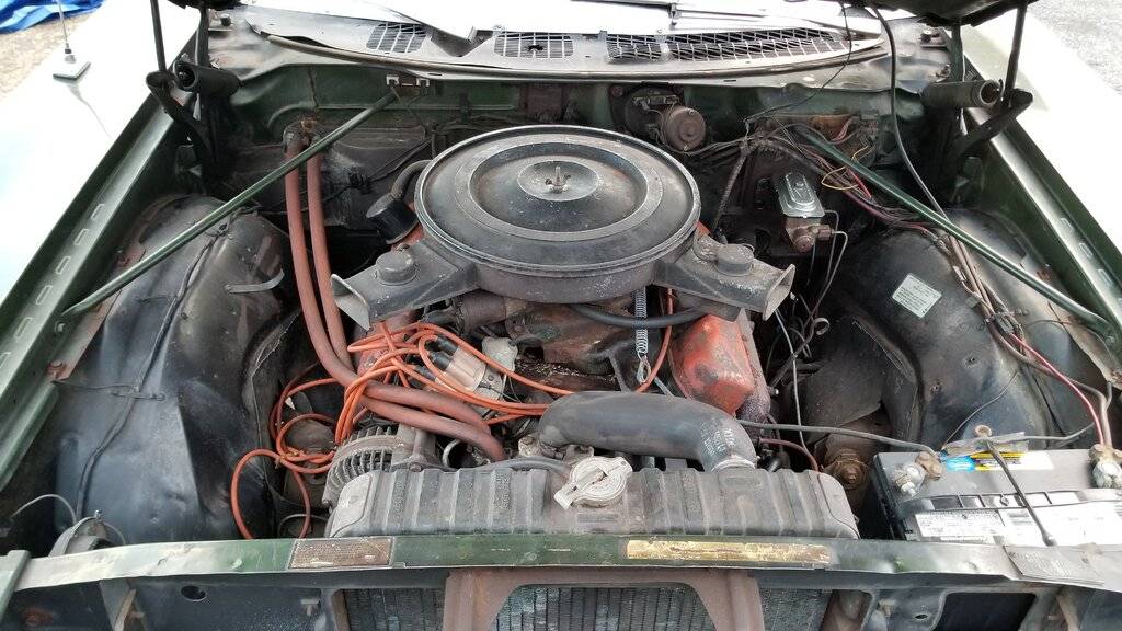

Before:
After:

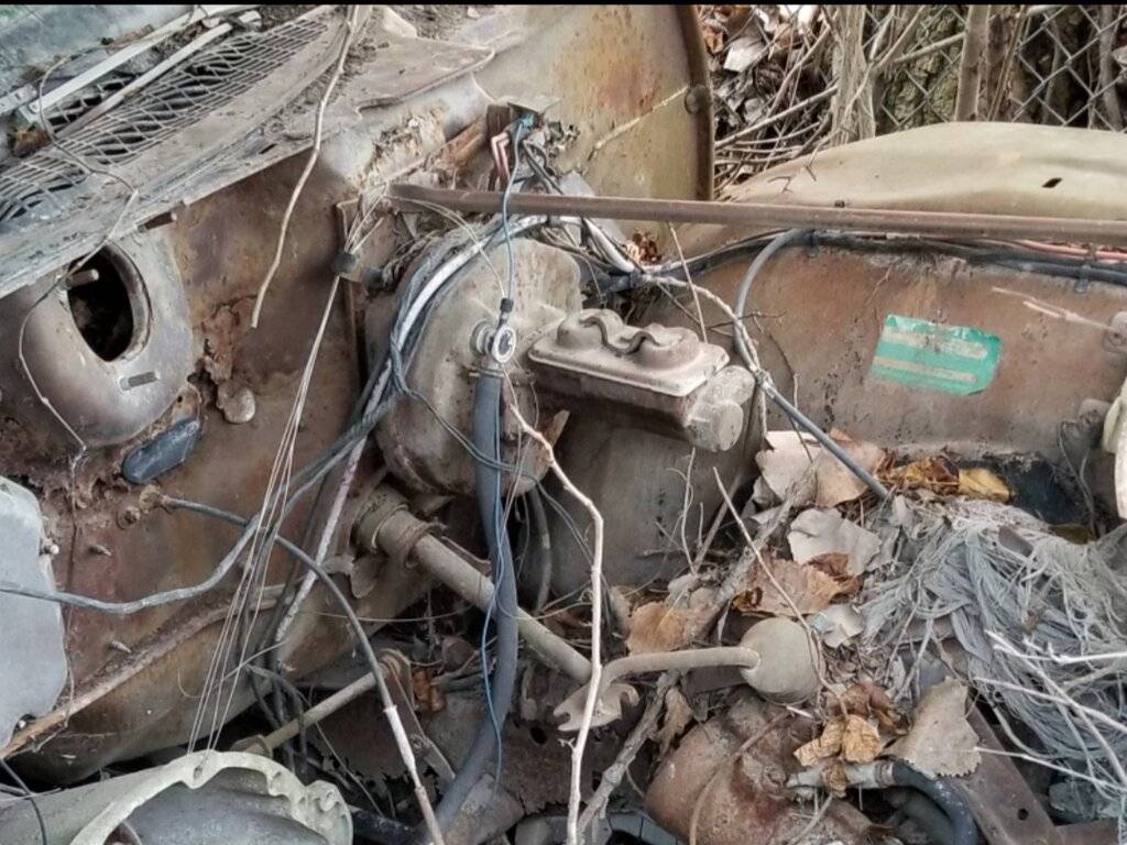

A local friend has a '70 NYer parts car (same one the washer bottle came from) that I'm going to see if he'll let me snag the valve covers from. I think it would look more appealing with the patina blue covers on there.
I think you need to switch your hoses to proper inlet and outlet at the firewall. check your original photo.
The inside diameter is different between the inlet and return nipples and hoses. Hard to confuse anything. Who knows if the red aftermarket hoses were done right.
Yes, 1970 has two different size hoses & nipples for the heater lines. Would be hard to get them swapped around when using the correct ones.

All those original looking parts look great. Now you have to get rid of that single bolt silver cover on the master cylinder!
Curious about these tips, is the valance cut out like the E bodies?
No, they are set below the valance.
I believe the whole master cylinder was originally painted black. The brake system along with the tires were recently replaced in the last 2 years I think.

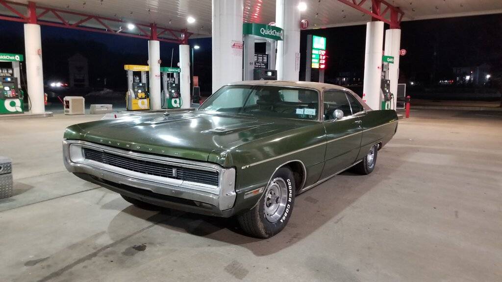

Some of you already seen on the GT fb page but I got the car registered last week and took it out on my first drive!
Tracks strait & actually stops well with those manual drums surprisingly! However it bogs pretty badly when you get on it. Pretty sure its starving for fuel. The ancient fuel filter is probably clogged with crap & the carb could use a rebuild. More parts to order lol
Looks great . Where you get the repro radiator hoses?
There's a few places that offer them as they are the same as B-body but I forgot who I went through. I believe they pretty much all come from the same source so shop around and see who offers the best deal.
NAPA usually has the molded hoses.
Your GT definitely found the right owner. Keep up the good work.
Alright it's on the road! That didn't take too long at all, congratulations on getting it going and it looks great. As saforwardlook said it is in the right hands.
I got a feeling that the bog you mentioned is indeed a carburetor.
On a separate note, gas prices suck where you are.
