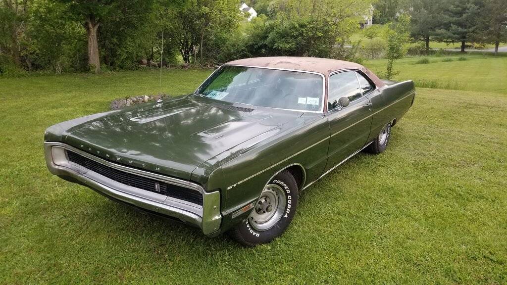

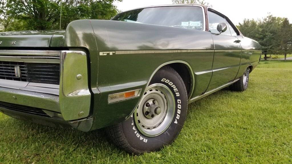

Finally my own '70 Sport Fury GT

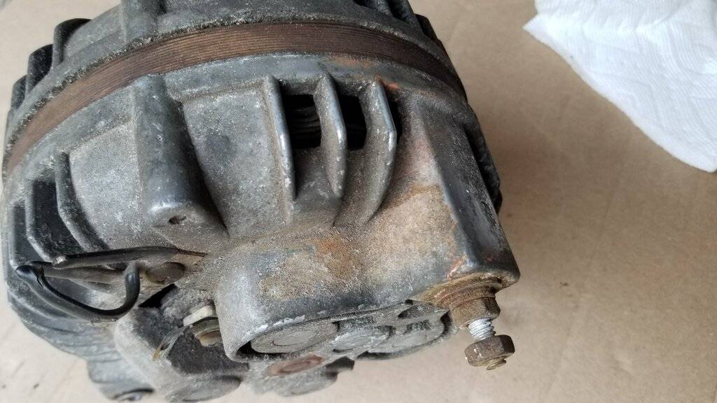

While putting the front accessory drive back on I was pleasantly surprised to find the car still retained its original assembly line alternator after all these years.
Front case cast late '69
Rear case cast early '70
Assembled 6th week of '70, just before the car was built.
Even still has faint traces of the orange paint inspection mark still on it.
This alternator has a bearing on its way out so on the self it goes till I can rebuild it with correct parts.

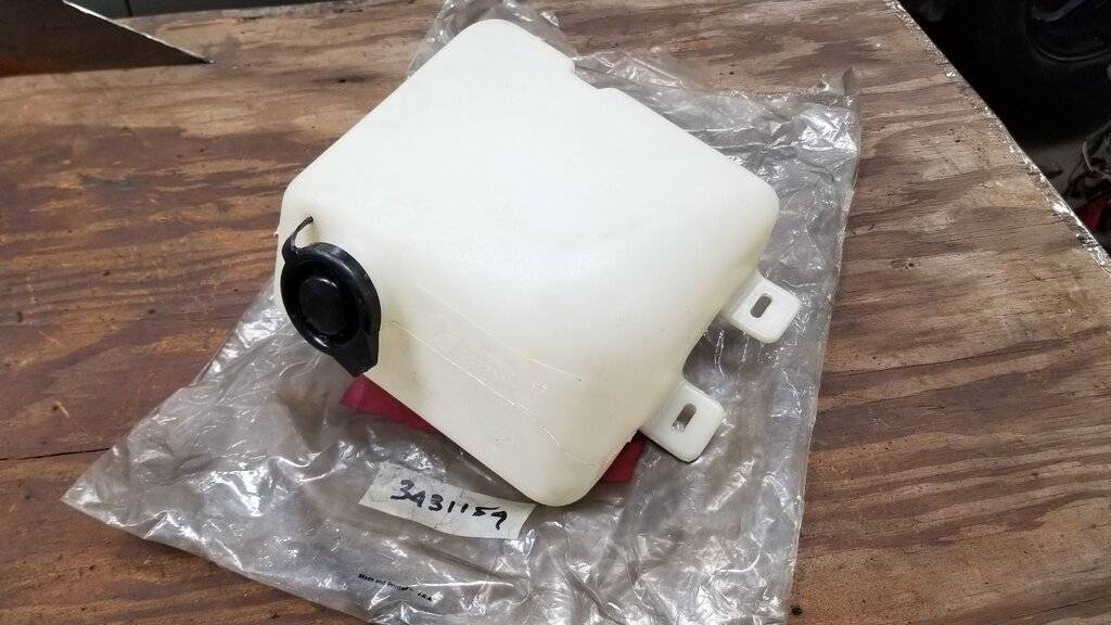

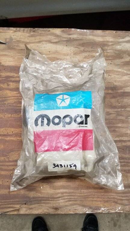

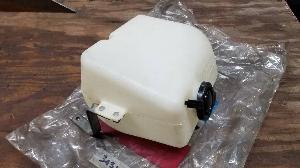

Where did you find this Charles? I ask because we are in need of one
A lot of searching on the web I was able to find a retailer of NOS parts. This was the only '70-'73 bottle they had.
Nigel at National Moparts has a few of the old reproduction bottles listed on his website too.

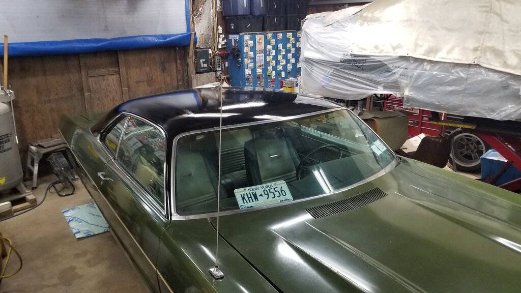

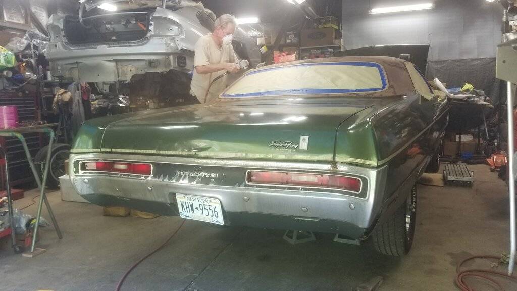

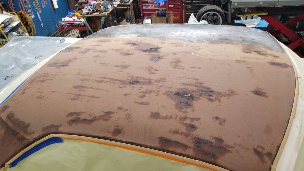

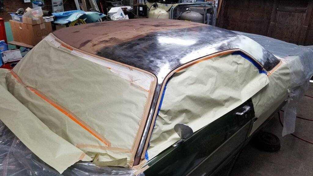

Steve attacking the roof and doing a quicky so that it'll look presentable & water proof compared to the brown primer & rust disaster it currently is.

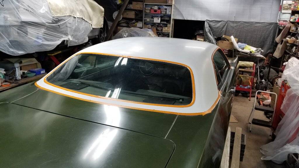

Although born with the V1X black vinyl roof originally, I kinda like the white top look.
It made no sense trying to put a vinyl roof back on until the roof can be properly repaired/replaced I decided the next best alternative for making the car presentable from 20ft away would be to do a V02 two tone painted roof with some TX9 black. This was the best option take in my opinion while trying to keep it visually close to what it was originally with the limited amount of time I have to work with.
