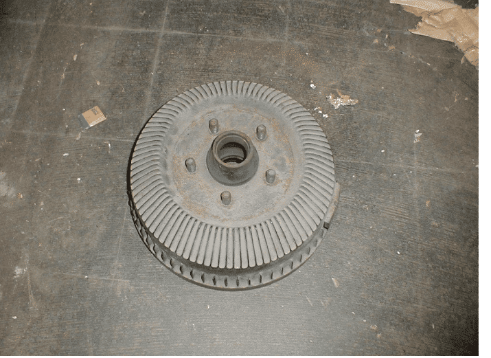

do all wheels other than stock, fit these drums? I have some after market wheels and wonder if they fit in the recessed area of the drums...
Should not be a problem. Double check the back spacing of the aftermarket rims for clearance in the back of your car and the front control arms ball joint area.

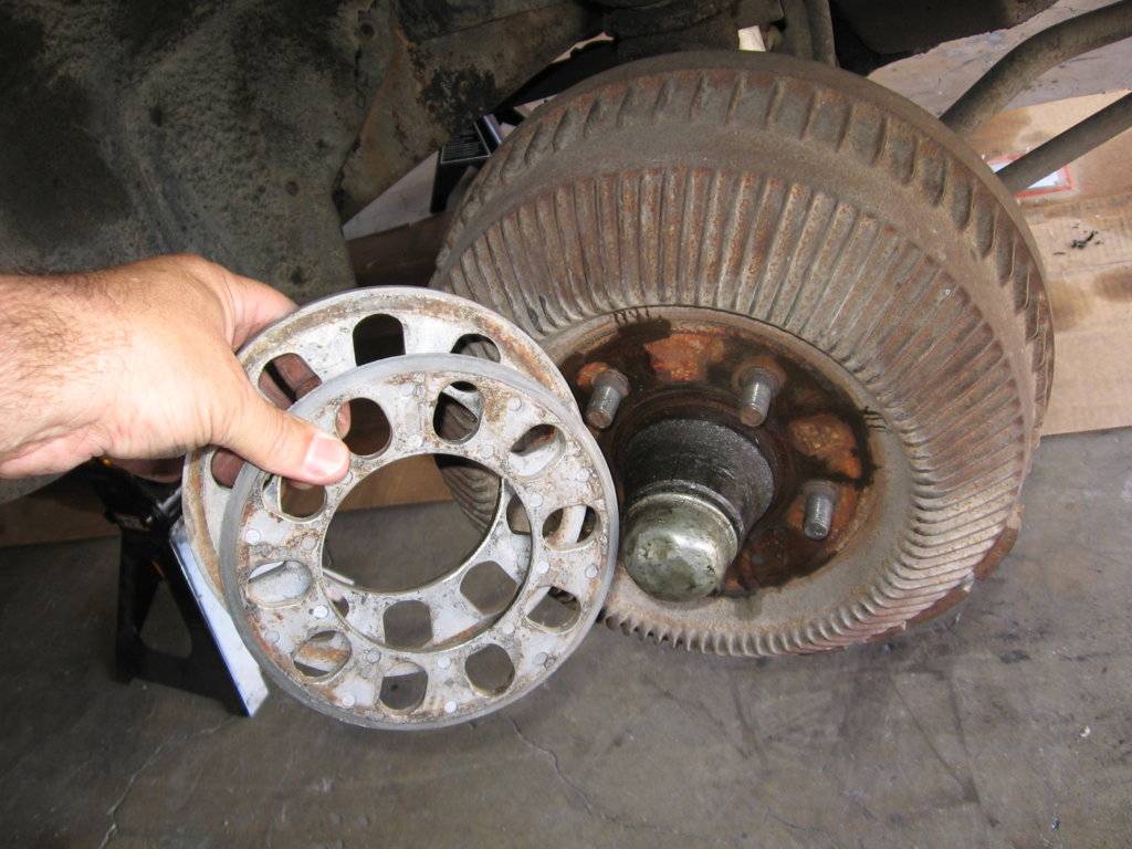

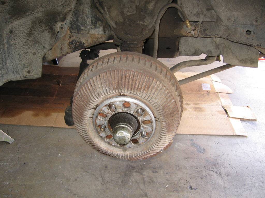

Sorry to disagree, but I had those same drums on my '70 Newport. When I put on the slotted wheels I used for 12 years, they would not clear without using spacers - two on each side.
When I converted to disks that problem went away.

View attachment 195772 View attachment 195773
Yes,I was corrected in a previous post.
Thanks for posting the pics!
