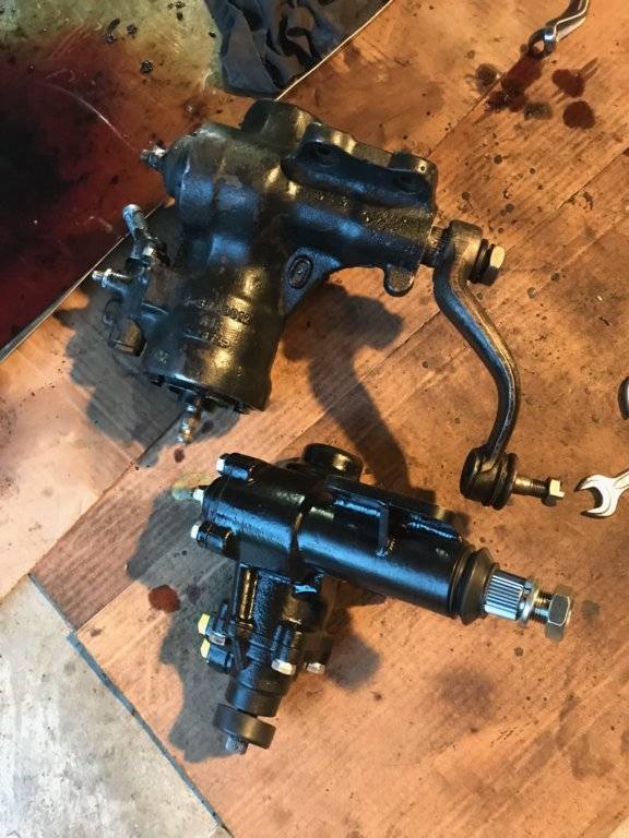

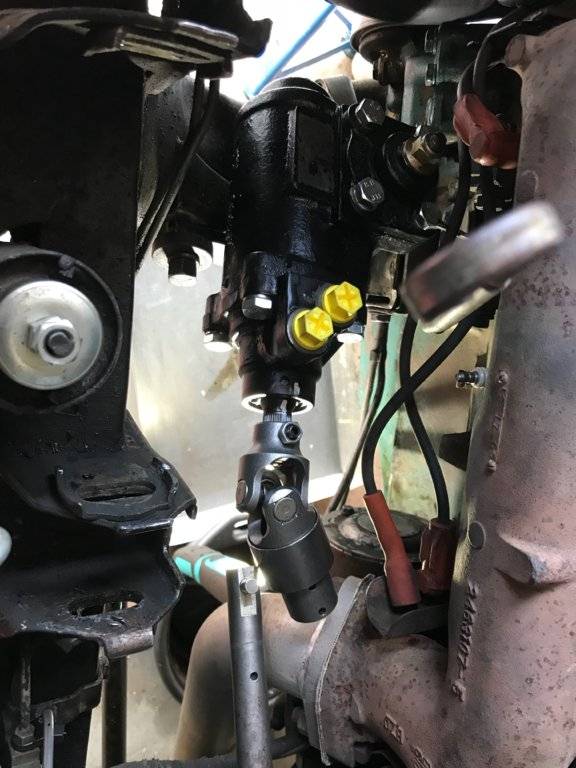

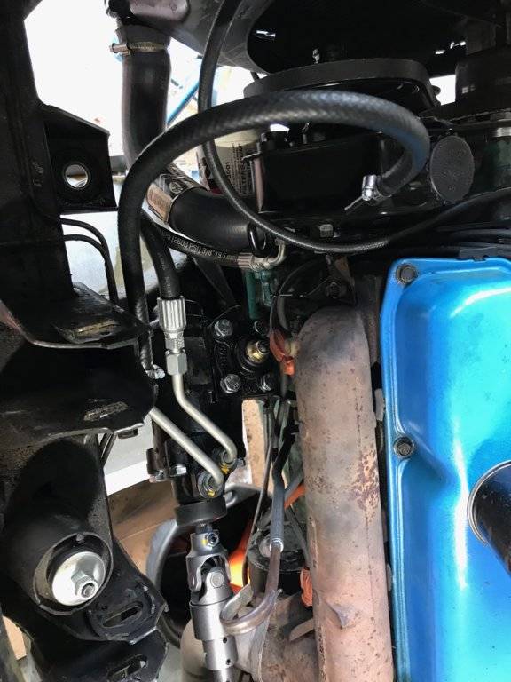

That is a comparison picture of Borgeson and oem Part. The Borgeson Box is smaller and light whigt compared to the OE Box. It has a quicker Ratio (approximativ. half a Turn less lock to lock). It has no noticable lash and requires slightly higher Steering effort. This swap is still not like a new vehicle with rack and pinion steering. You would Need to modify complete frontend.
You would also Need to have a good ps pump. I followed the borgeson recommendation and bought a new pump and hose set all at once. I like the new steering feel. I feel much safer than before with a cardone rebuild box which was horrible.
That looks like it definitely provides more clearance all around for after market headers and swaps correct? Just curious would you have an idea of how much smaller the new box is in width and height etc??
