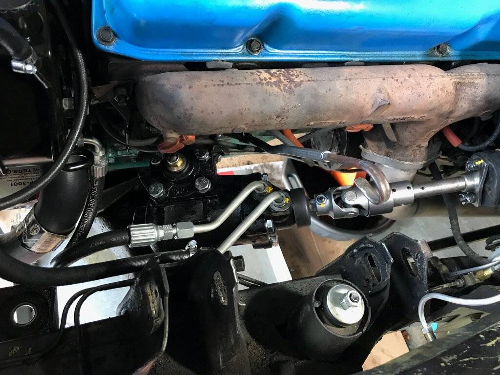

That looks like it definitely provides more clearance all around for after market headers and swaps correct? Just curious would you have an idea of how much smaller the new box is in width and height etc??
I wish I had taken some measurements of both parts to compare dimensions and weight as long as laying on the bench.
Borgeson Homepage states it has a 10# ( pounds?) weight decrease and „drastically header clearance increase“ . No dimension found so far. Steering gear box weight is 25 lbs.

So far I drove my 66‘ 300 for about 700mls. Since installing the Borgeson Box with the „solid“ universal coupling and I can not report on any vibrations.
For sure, it could become an symptom when tires become imbalanced or wheel alignment is not good.
It worked out very good on my car.
Only thing I have noticed is an hydraulic grunt noise under certain conditions I could not explain myself.
It only occurs when returning to centre from a left turn, and not always. So speed and temperature are playing within this equation.
I did separate both pressure and Return line from each other and added a foam on a place where the return line maybe could touch the inner fender But this did not fix this effect.
I can live with this Minor issue, sometimes I will find the Root cause.
I drove long tours into the black forrest and the car was so easy to keep in line on narrow roads or Long and fast curves.
I‘m very excited about the easyness to Drive the 300 now.
Here is a good picture about clearance to the stock manifold providing a rough idea how it will work with headers.
PS. I forget about the fact that there is still a rubber in place above the solid universal joint providing insulation as well as enough of a length compensation.
