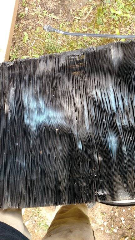

Engine has always ran high end of normal. I see airflow obstruction here . This is the condenser coil.

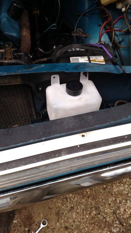

Installing an overflow container. I repaired a coworker's smart watch at no charge. He decided to get me an overflow. It's Dorman part number 603-001. About the size of the windshield washer container.
