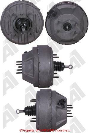

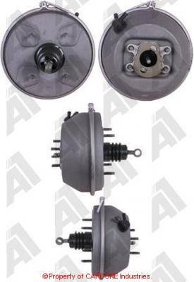

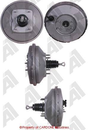

Take a picture of your booster and post it. Easy to identify.
FYI, here are pics of the 3 boosters that it could be.
Drum Booster - is unsafe (in my opinion) to use on a disc system. Will bolt up and work, but not provide enough boost.

Disc Booster (what the factory used up to mid 1970). Hard to find, worth looking for. They're out there.

Mid 70 and up Disc Booster (will fit and work on console shifted 65-68 C bodies, but will interfere with the shift linkage on column shift cars). Easier to find. May require modifications to the booster backing plate to bolt up.

Sorry for the delay, It's definitely pic #3, the mid 70's style booster.
