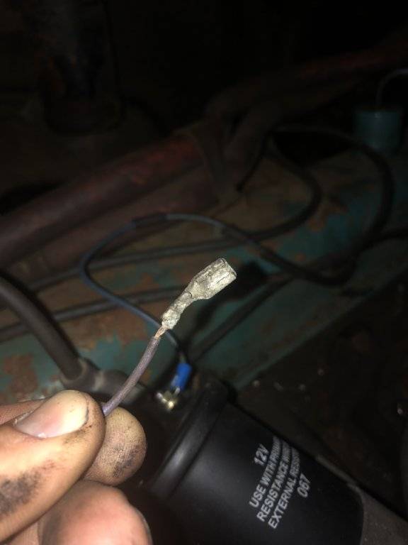

Hmm I’ll have to look again I grounded the wire to the one in picture and temp gauge was moving maybe I messed something up
They will sometimes do that if the is a bad ground to the cluster, try the test again, if the car has an idiot light for the oil pressure, grounding that lead will cause the idiot light to come on and supply a ground to the cluster.
