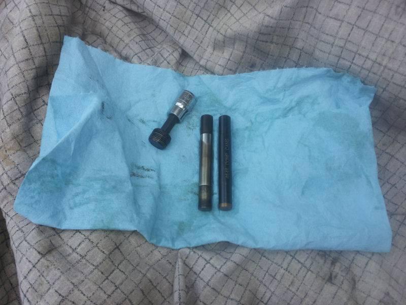

fuelpump-pushrod-new-and-old.jpg original pushrod and new comp cam #4646 pushrod . . .same length . .. sigh. . .I ended up putting the old one back in.
