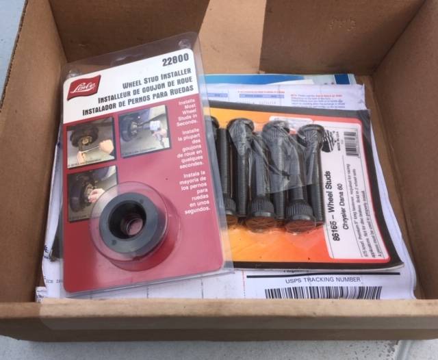

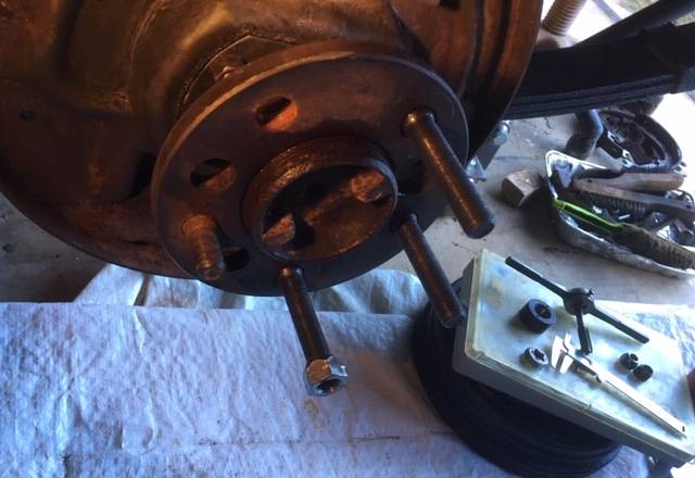

Putting a 3 inch long wheel stud with a .685 knurl into a hole a .678 knurl came out of. Using a Lisle stud installer. I busted one today. I ran out of new lug nuts & tried to recuse one. It stretched the threads & ruined it. Almost had it. 3/16 of an inch to go & it stopped moving. I’ll ream the hole a bit more as well for the next one.

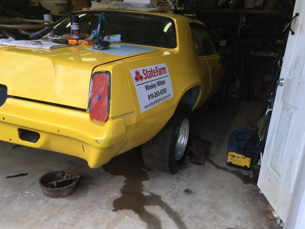

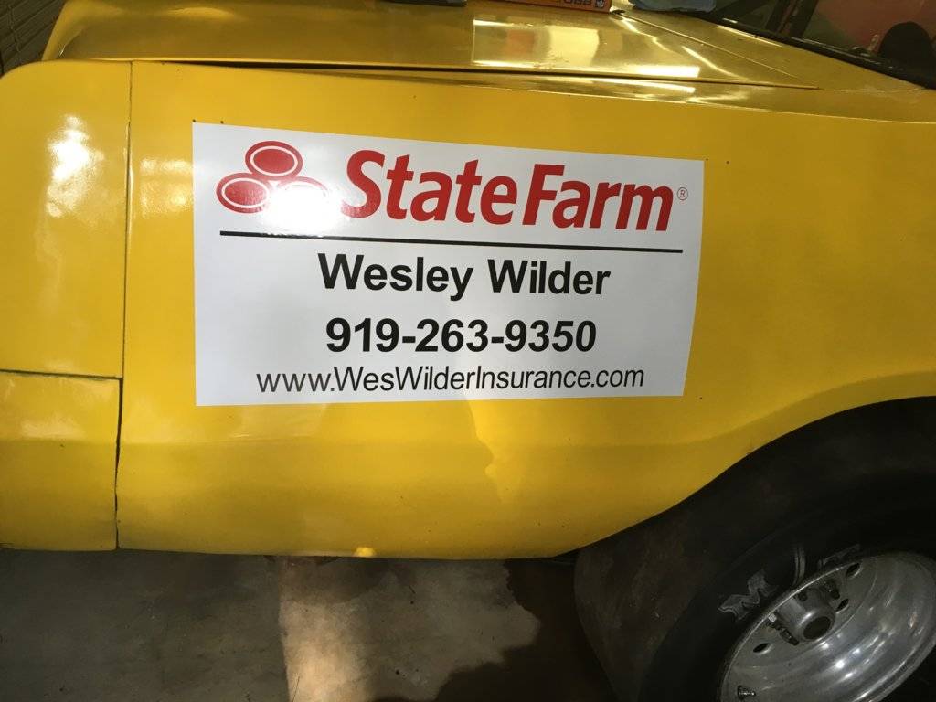

Picked up a 6 race sponsorship deal for FURYIOUS today. Hopefully I’ll impress him enough to get him to commit through next season. Anyone else want to sign on & advertise your business on the ONLY 77 Plymouth Fury Big Block powered drag car in the country

View attachment 271394 View attachment 271399 Picked up a 6 race sponsorship deal for FURYIOUS today. Hopefully I’ll impress him enough to get him to commit through next season. Anyone else want to sign on & advertise your business on the ONLY 77 Plymouth Fury Big Block powered drag car in the country
What does sponsorship get you these days, cover the cost of the entry?

I'm a fan of anyone who finds a way to beat an insurance company back out of a few bucks... and especially statefarm... :thumbsup:
