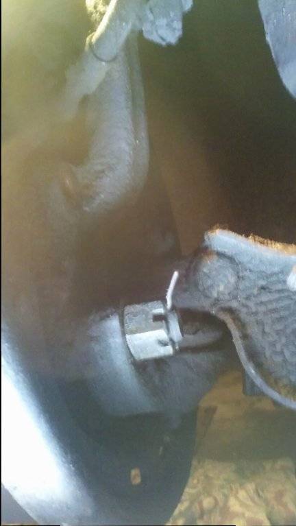

I assume this pin goes straight through the bolt ....

I assume this pin goes straight through the bolt ....View attachment 75508

Yes, that's the cotter pin. Use a pair of dikes (cutters) to grab the head of the pin (bottom side from your photo) and pull it out.... or grab the head of the pin and rock it out with the dikes against the nut.
Yes, sir.
The cotter pin is to prevent the castle nut from backing off.
Now that I think about it the '73 disc setups didn't come with castle nuts and bolts with holes through them for the cotter key. My setup came intact and that's the way it was... Gary, if you didn't get any bolts with your spindles you can probably use the old bolts and castle nuts providing the bolts are long enough. I don't recall off-hand, but I think the disc spindles are a little thicker than the drum spindles, but the bolts should work fine.
