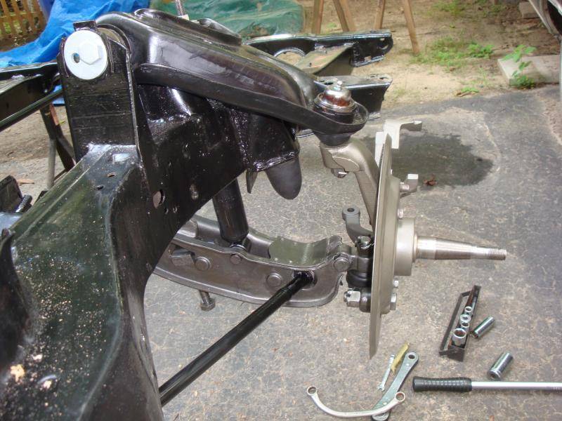

View attachment 75373 LOL, I'm no Superman, but I was still able to tear down the front suspension with my bare hands! I actually pulled the upper and lower control arms, which in hindsight made it harder to remove the ball joints, and they were heavy. And yes, Big John, those bolt heads spun without a wrench on one end! However, if Gary is getting all of the parts from a '73 I would think all the hardware is included. Based on the number of pages in this thread at least we can agree, there are many different ways to skin a Newport.
The thing to remember here is Gary is reusing the lower ball joints. He has no need to separate them from the lower control arm.
I was going to re-use mine, but the boots were split. I ended up replacing them with parts from PST.

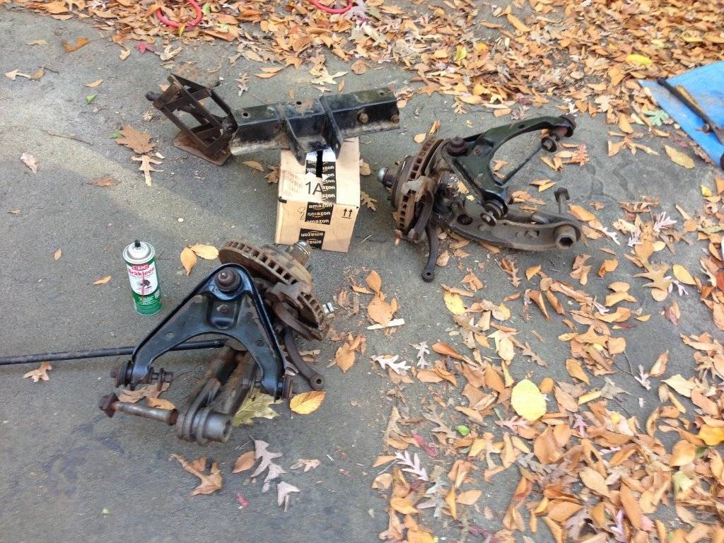

Not sure why you have to take the drum off at all. you are removing the spindles, correct? release the tension on the torsion bars, pop the upper and lower ball joints and the tie rod end and remove as a unit.

alright. I think I'm gonna have to use this approach on the pass side. I've been banging away at this drum and it just will not let go, and I need this damn thing off already. I KNEW this wasn't gonna go perfectly. So what's the story with this? Put a jack beneath the LCA?
So I'm looking at this......I can see how the whole assy can come out without pulling drum off.
alright. I think I'm gonna have to use this approach on the pass side. I've been banging away at this drum and it just will not let go, and I need this damn thing off already. I KNEW this wasn't gonna go perfectly. So what's the story with this? Put a jack beneath the torsion bar?
That is not the best way to do this..It's a lot more work.

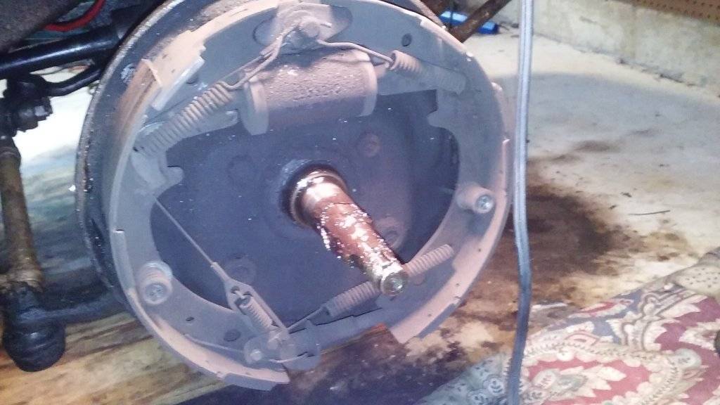

DONE!View attachment 75499
This SOB refused to give up the drum...but I got it.
Gary, did you back off the adjusters... they still look pretty extended. It was suggested to loosen them all the way. If you didn't that's why it was so hard to get the drum off.
To back them off, take the little rubber cap off from the rear side of the backing plate and use a large flat head screw driver to spin the star wheel.
