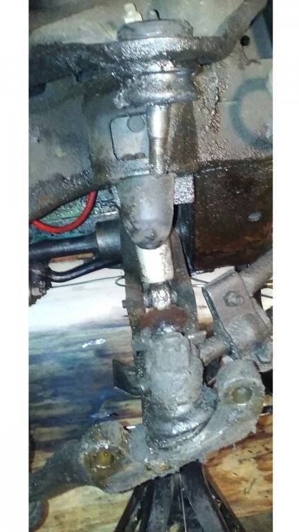

Alright, about now you are frustrated and ready to pull your hair out and tell us all to F.O.
But, PLEASE listen to what I say so you DO NOT get hurt. Reinstall the lower two ball joint to spindle bolts, you do not have to tighten them, just make sure they are on at least five turns. Then you can jack the car up off the jack stands about 1 inch clearance. Then loosen the upper ball joint nut, THEN STRIKE IT WITH THE B.F.H.
The force of the torsion bars will help dislodge the spindle. Then lower the car onto the jack stands and remove the spindle.

Put the upper ball joint nut on a few turns before you do this. I see from the pics it's off.
Yes, right after the boot and the grease inside burst into flames. Please, no torches. Ever.

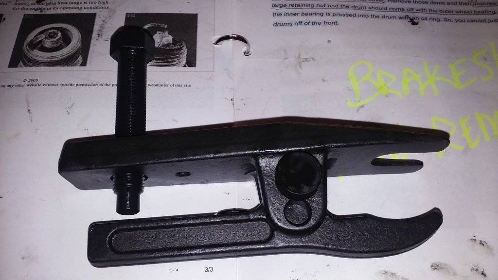

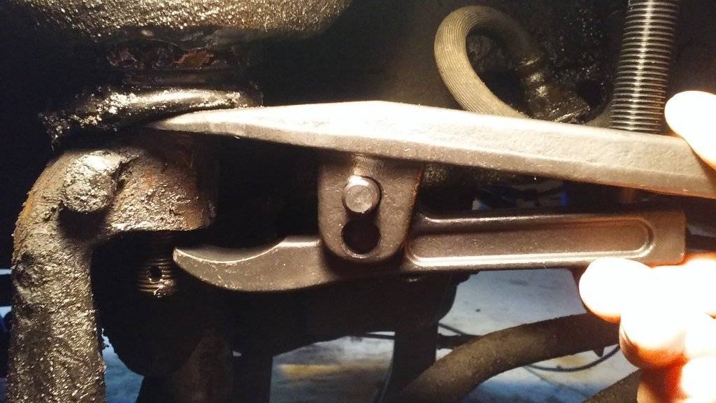

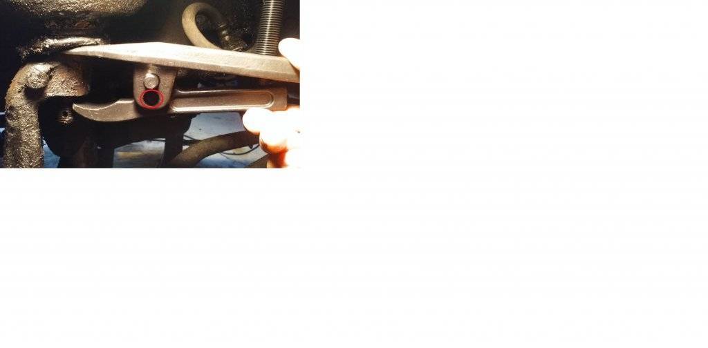

So I got the joint separator from HF........not exactly sure how this thing works...I guess its obvious where the top u shaped part of this is placed..OR no? How is the bottom "lip" situated? Under the the ball bearing bolt? It isn't going to open wide enough to do that
I've never used one of those.
It looks pretty simple though.... Open it up farther by pulling the pivot pin out and installing it in the other hole.
I'd try it by "loading" the ball joint stud and then giving the knuckle a rap with the BFH, just like we've showed you.
BTW, wear some safety glasses when doing this and especially using that Harbor Fright Chinese thing.
I'd also grease the pocket the jack screw goes in on that tool... Just 'cause.
