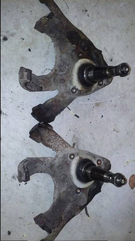

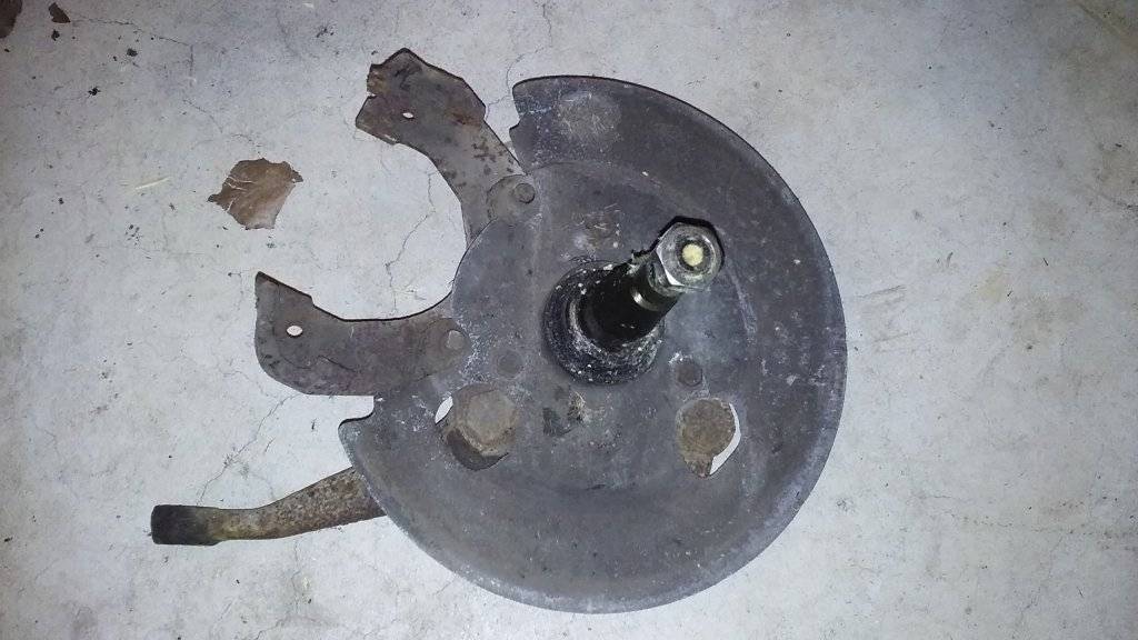

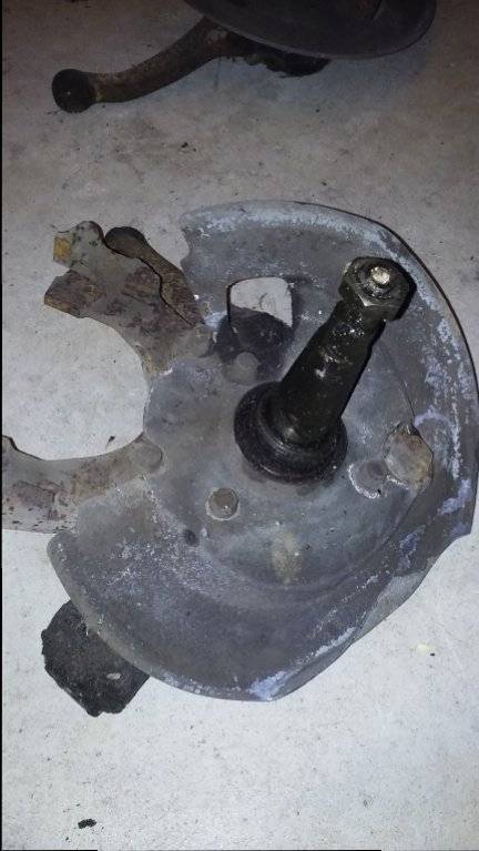

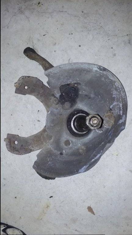

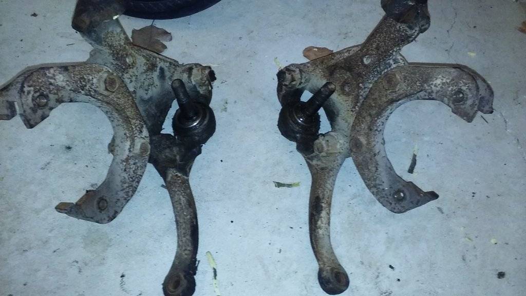

So my spindles show up today....FINALLY. The backing plate on one of the these is trashed; bent back in two different ways.......but guess I'm replacing those anyways...
IMHO those dust shields are optional. I did away with them when I did the swap on my 66 for the same reason. No ill effects as far as I can tell.
They don't repro the C-body ones AFAIK.

Yeah, Im thinking about going that route too.

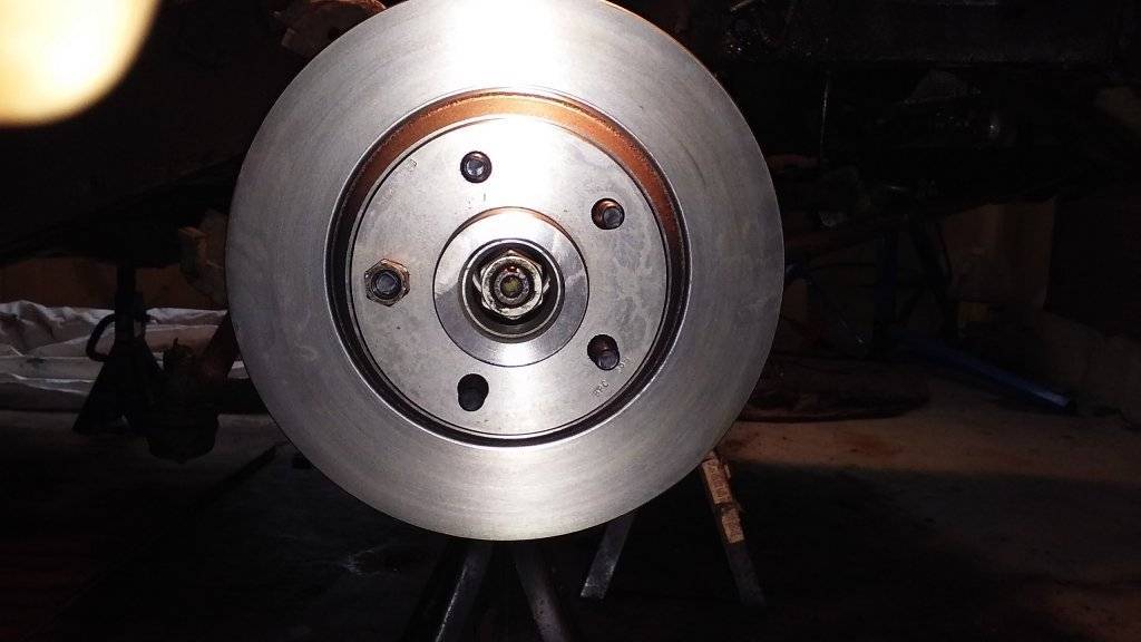

Do I want to reuse the same cotter pins I pulled out of the castle nuts holding the spindle assy together?

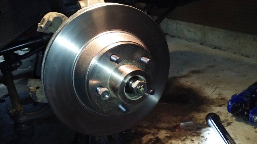

BIG shiny disc brakes...throw contents of back seat clear thru the windshield now, not a prob.
LOL I did that once ... contents was my little brother. I was driving Dad's 71 Fury with the Discs and he was driving my 4 speed RR that day. When I hit the spot up the road where I normally shifted to second I hit the BIG ' disc brake equipped ' or whatever it said, brake pedal where I was expecting a clutch pedal and things came to a halt like RIGHT NOW ! hehe. Thank goodness no one was hurt .. I was only doing about 25 but 25 to zero is quite a shock in a nano second.
