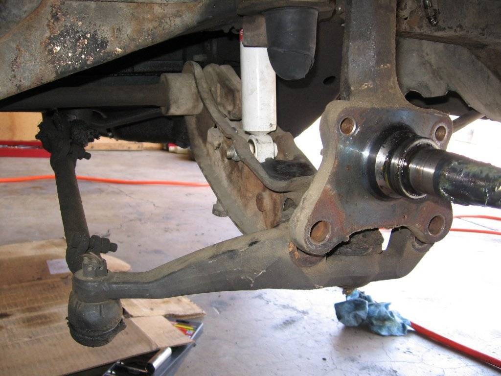

View attachment 74703 View attachment 74704 View attachment 74705 View attachment 74706
Thanks Snotty, I REALLY appreciate the pics....worth a million and a half words for me. I really hate reading directions, lol.

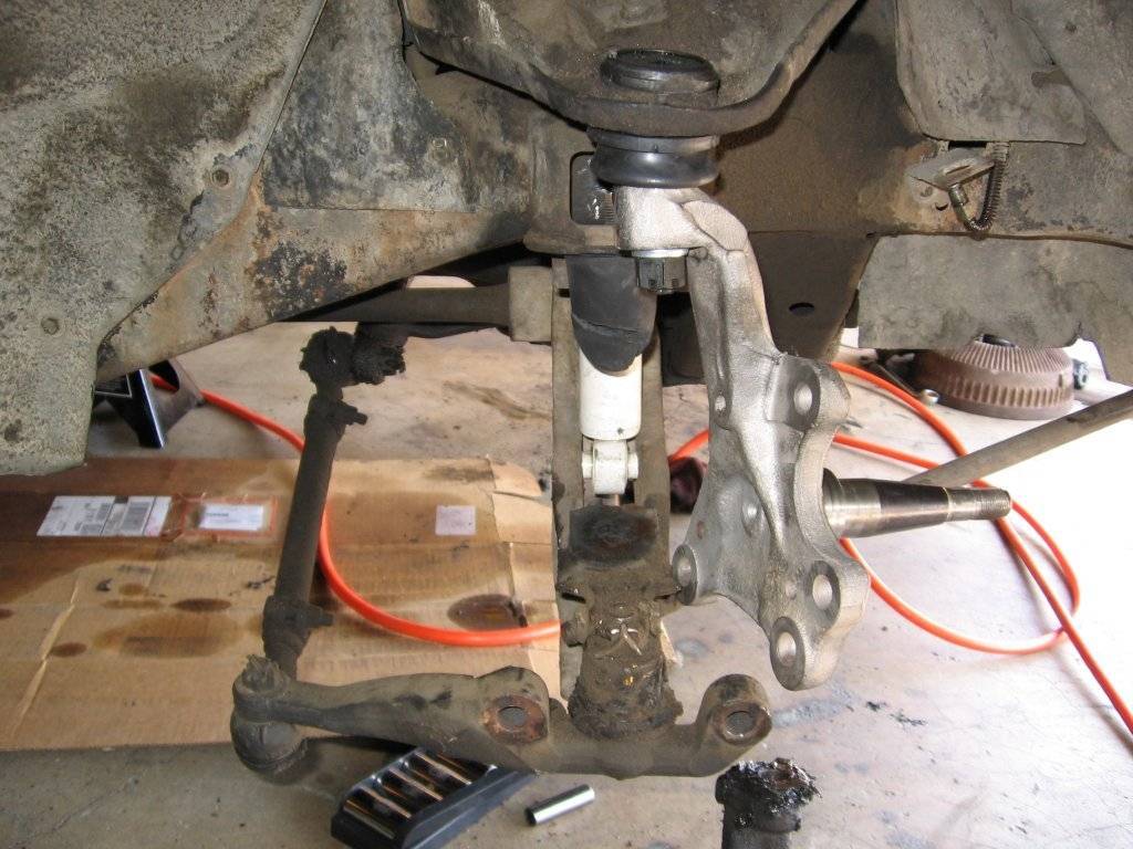

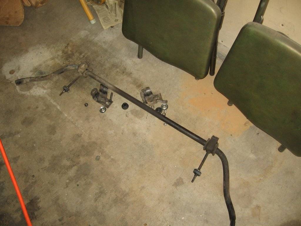

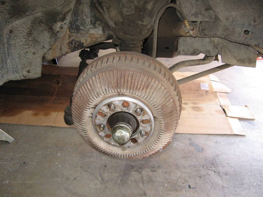

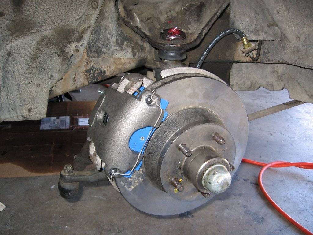

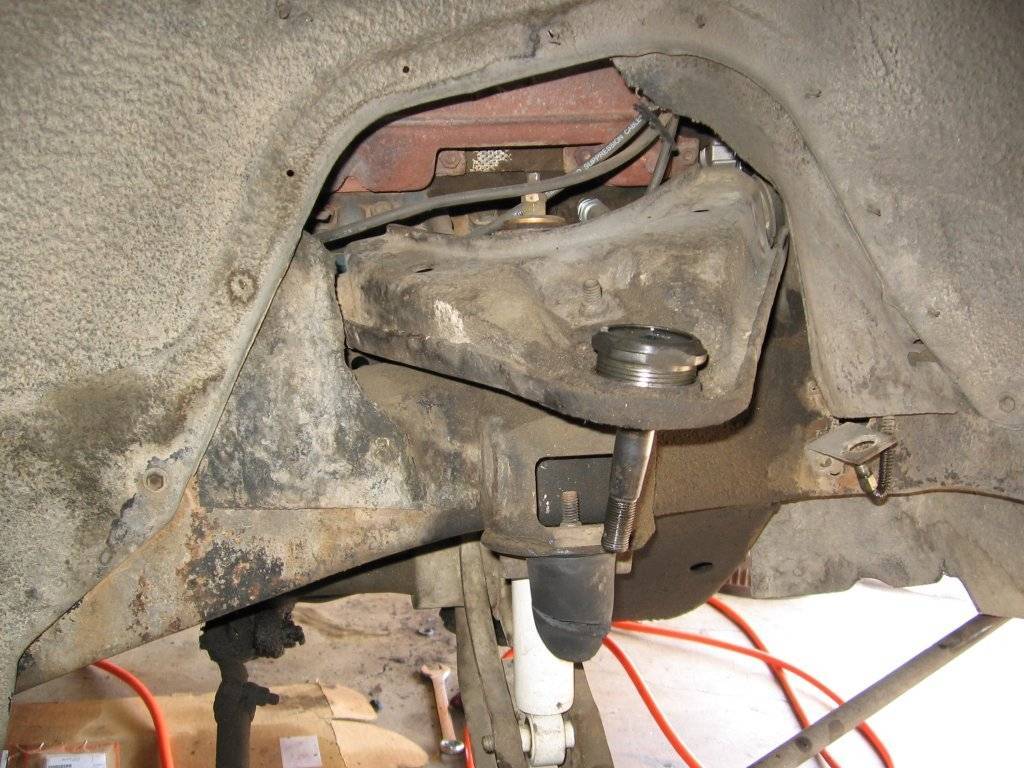

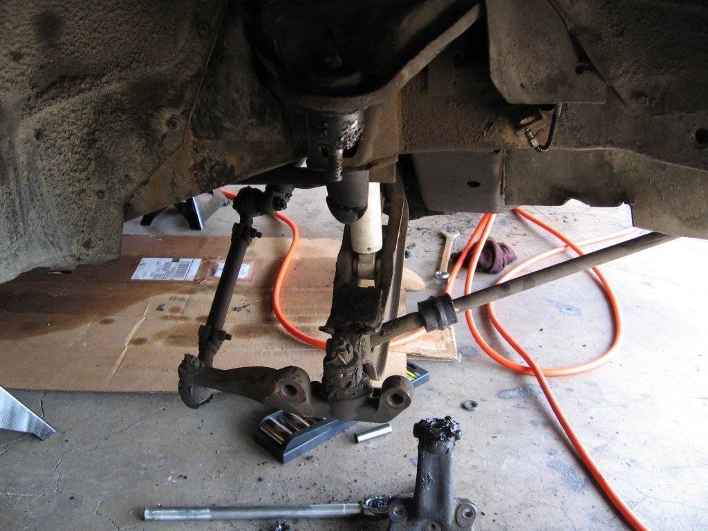

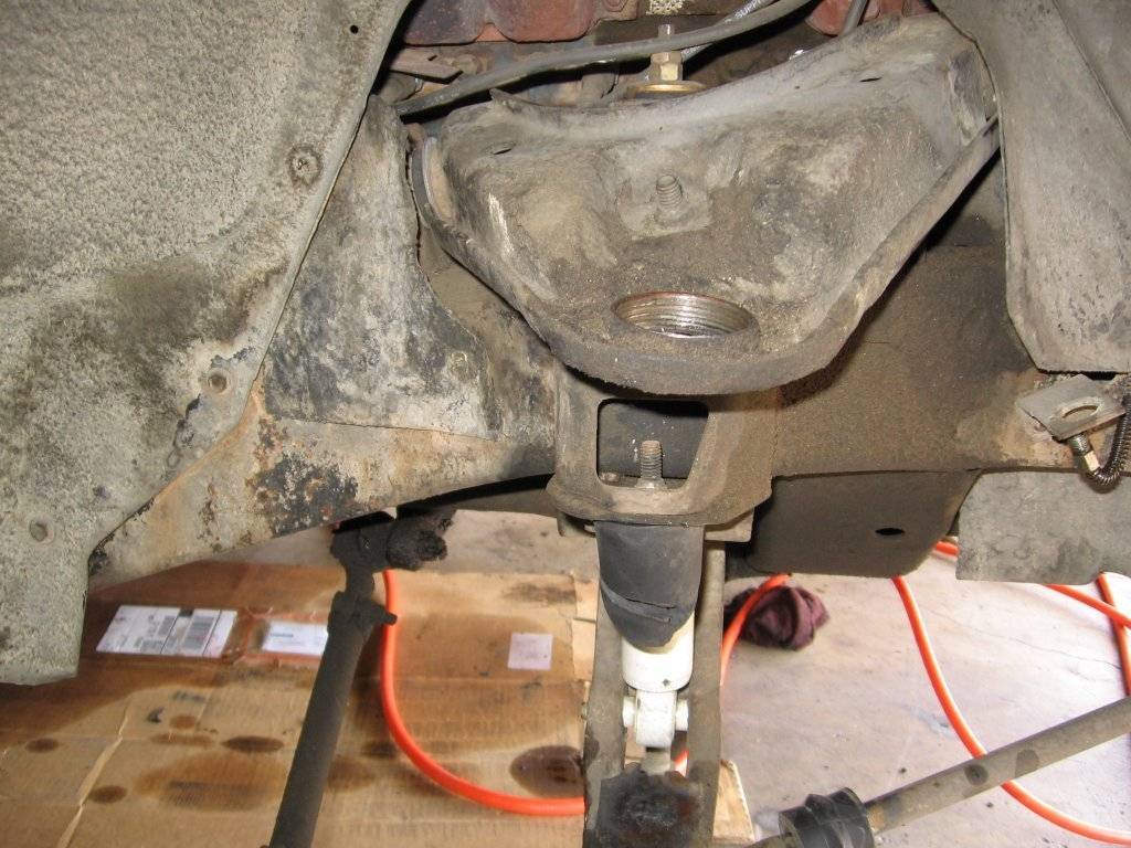

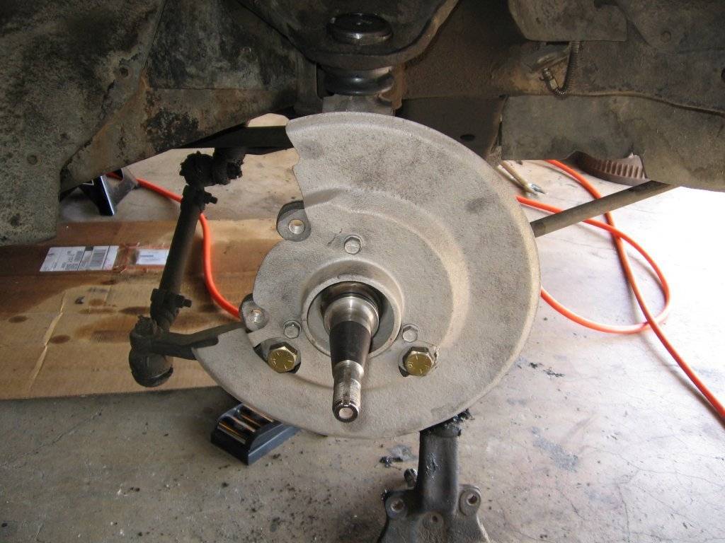

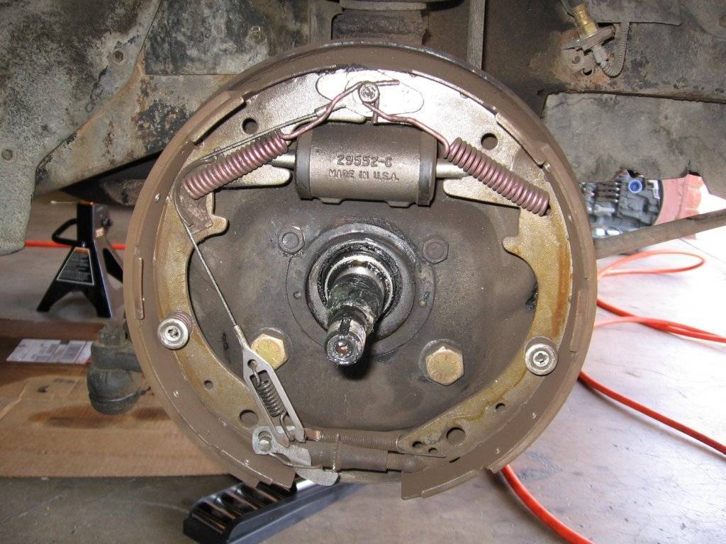

Here are a group of pictures:
Original drums. I had to use spacers to mount the Shelby 500s I use.
I removed the sway bar and used new bushings and hardware when I reinstalled.

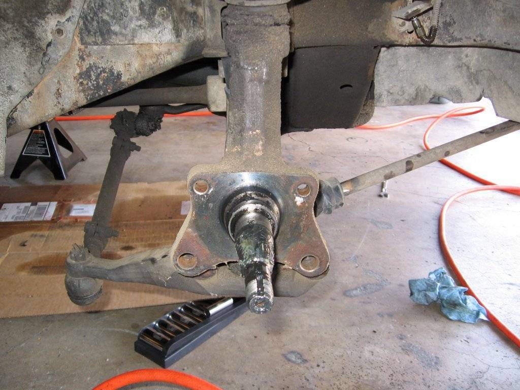

Backing plates now gone and lower carriage bolts removed.

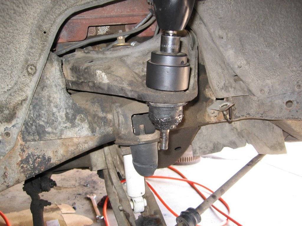

Using a separator tool, I removed the spindle.
The passenger side upper ball joint had actually failed, so I replaced it. This can be tough without air tools and proper sockets. I borrowed the latter from a mechanic buddy.

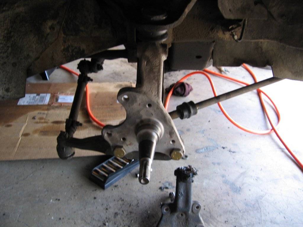

With new ball joint installed, and attached the disk spindle.
Then reattached the lower carriage bolts.
