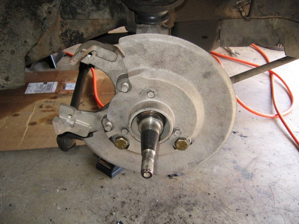

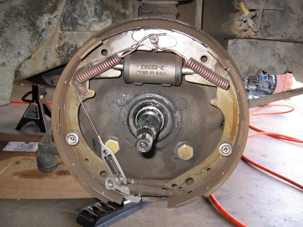

Put on the backing plate, freshly sandblasted. (These things were UGLY!!!)

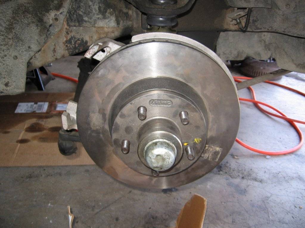

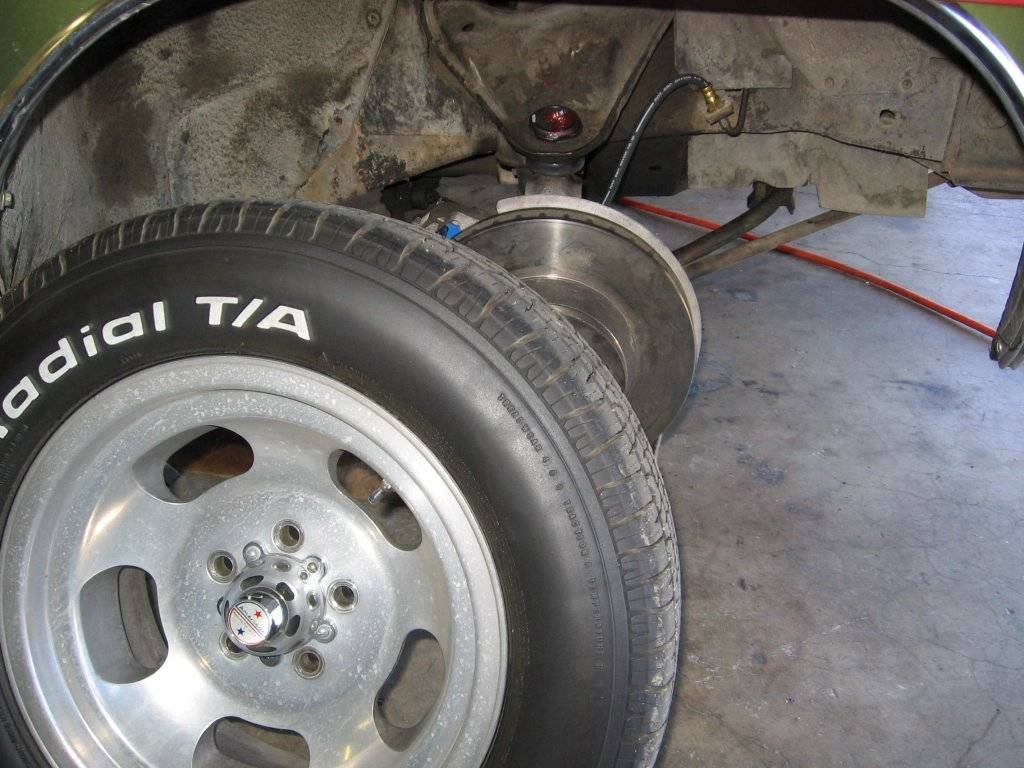

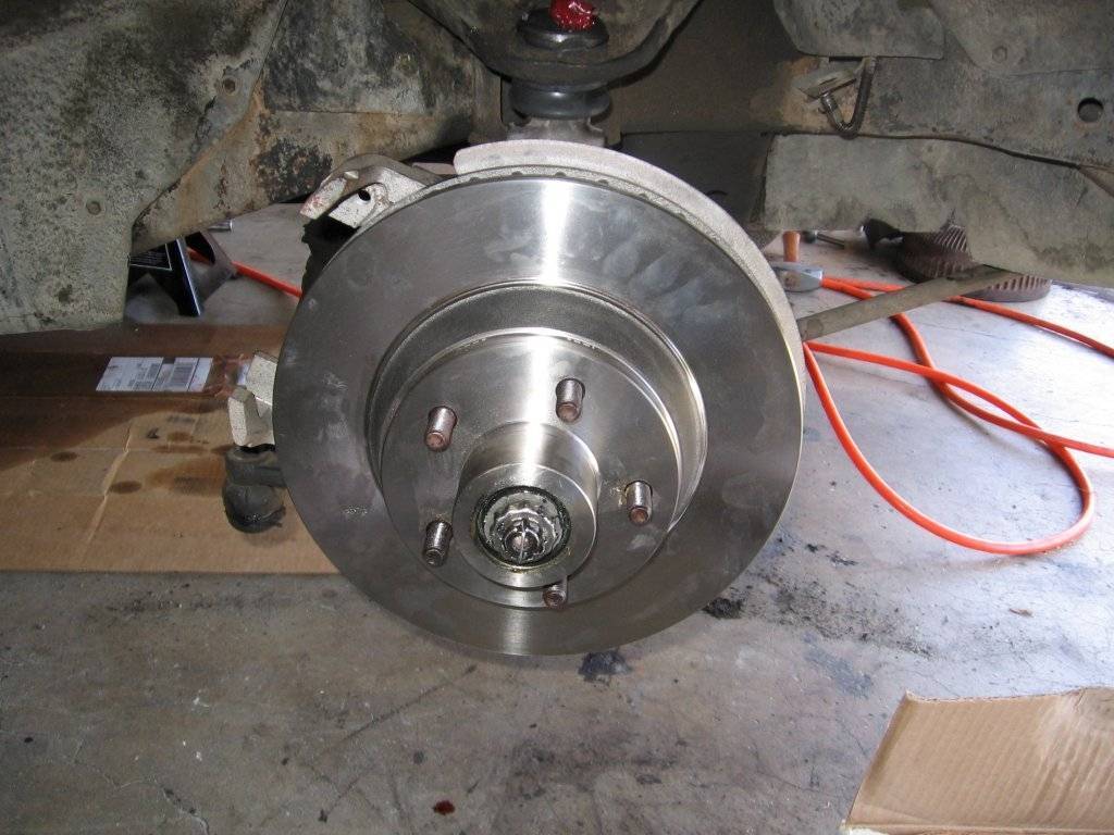

Then put on the rotor. This was when I learned that I had mix-matched parts. The bearing nut would not tighten down until it hit a point where the rotor would not turn. Not good! My mechanic buddy came by after work and said, "Scotty, these old rotors are for a '71, not a '73." I had to go back ad get new rotors, calipers, bearings, caps, and brake hoses for '71s. That turned a weekend job into a four-week trek through Hell.
The correct one. Look closely and you can see a difference.

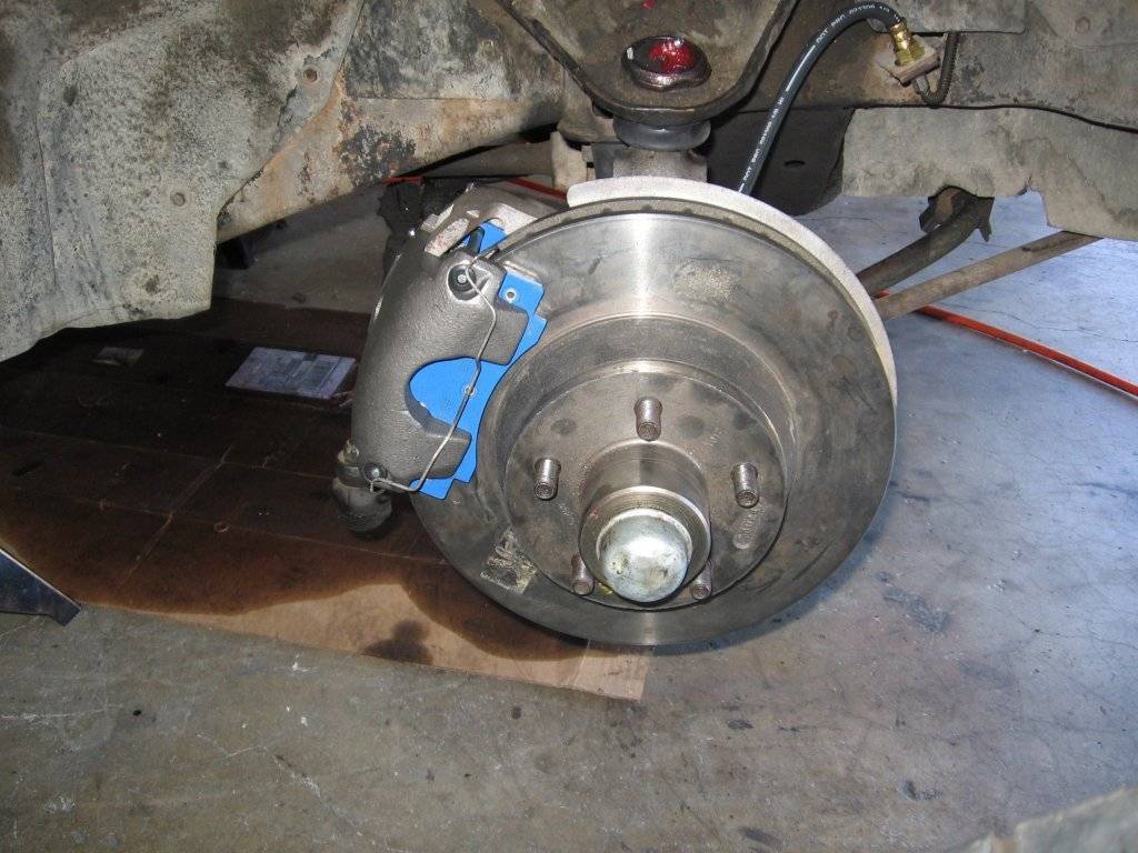

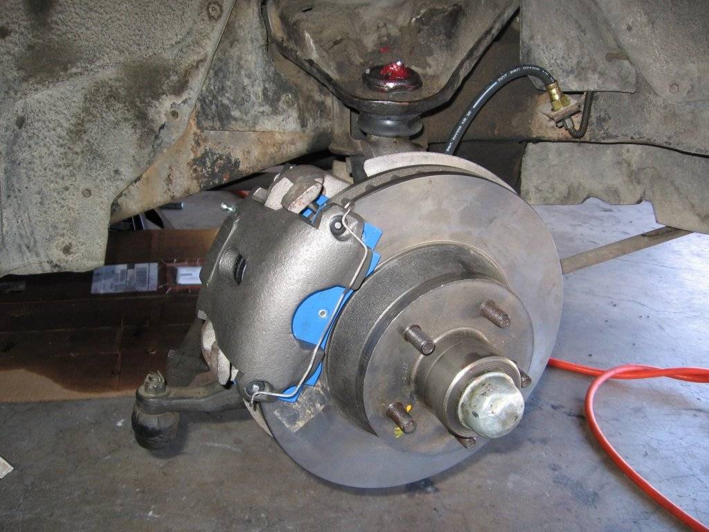

Caliper in place.
Brake hose attached.

And... done!!

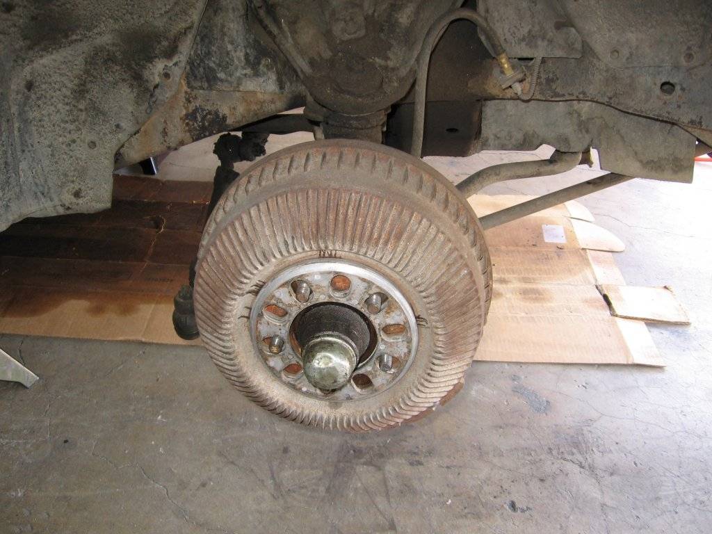

Original drums. I had to use spacers to mount the Shelby 500s I use.

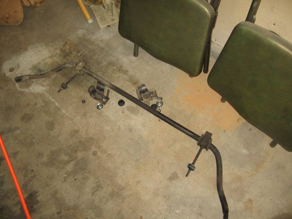

View attachment 74727 I removed the sway bar and used new bushings and hardware when I reinstalled.

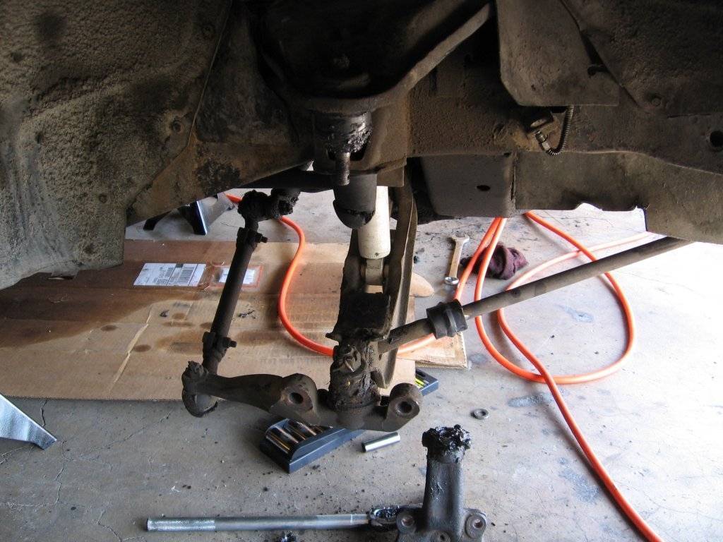

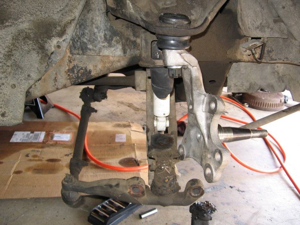

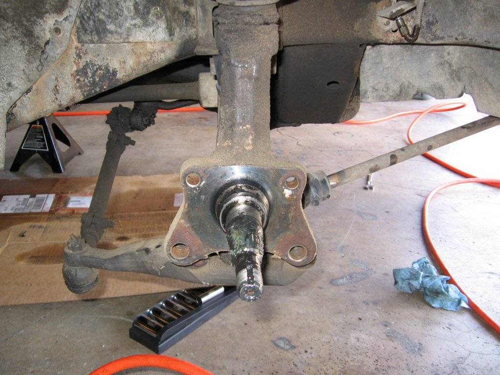

View attachment 74728 View attachment 74729 Backing plates now gone and lower carriage bolts removed.

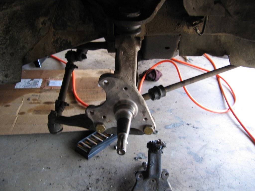

View attachment 74730 Using a separator tool, I removed the spindle.

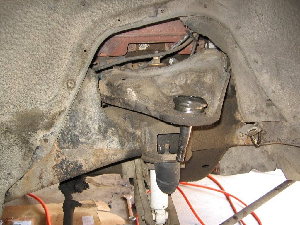

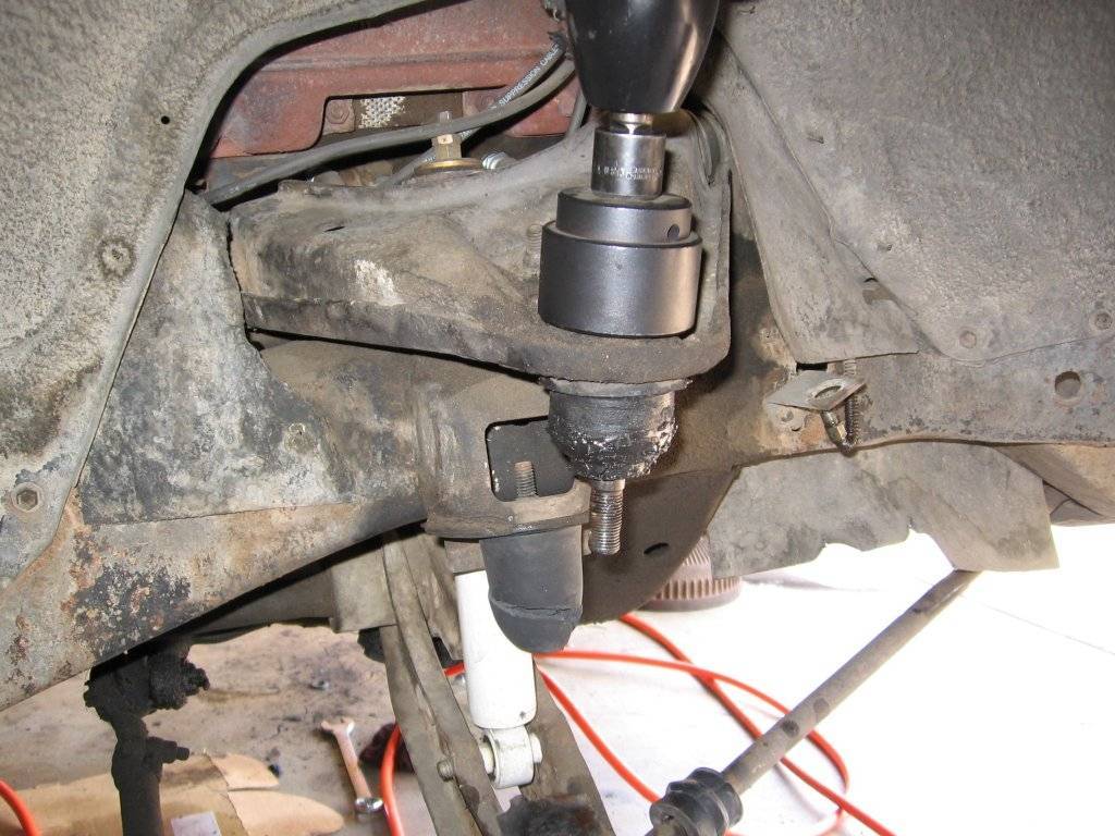

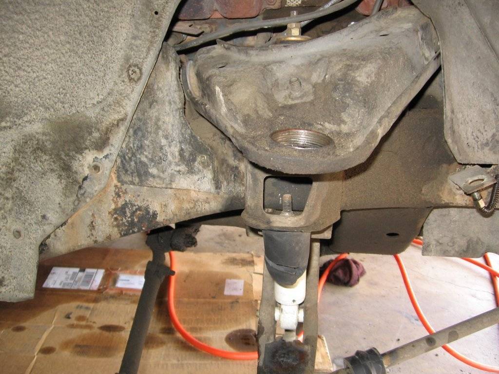

View attachment 74731 The passenger side upper ball joint had actually failed, so I replaced it. This can be tough without air tools and proper sockets. I borrowed the latter from a mechanic buddy.

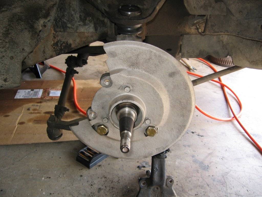

View attachment 74732 View attachment 74733 View attachment 74734 With new ball joint installed, and attached the disk spindle.

One question however..What is this "separator tool" used to remove the spindle?

Did you coat these with anything after they were sandblasted?

[QUOTE="Snotty, post: 343899, member: 4420]
Did you coat these with anything after they were sandblasted?[/QUOTE]
No, just Rustoleum paint, the grey color you see in the pic. The driver's side was so rusty it had a small hole in it. Since it's just a dust cover I used it anyway.

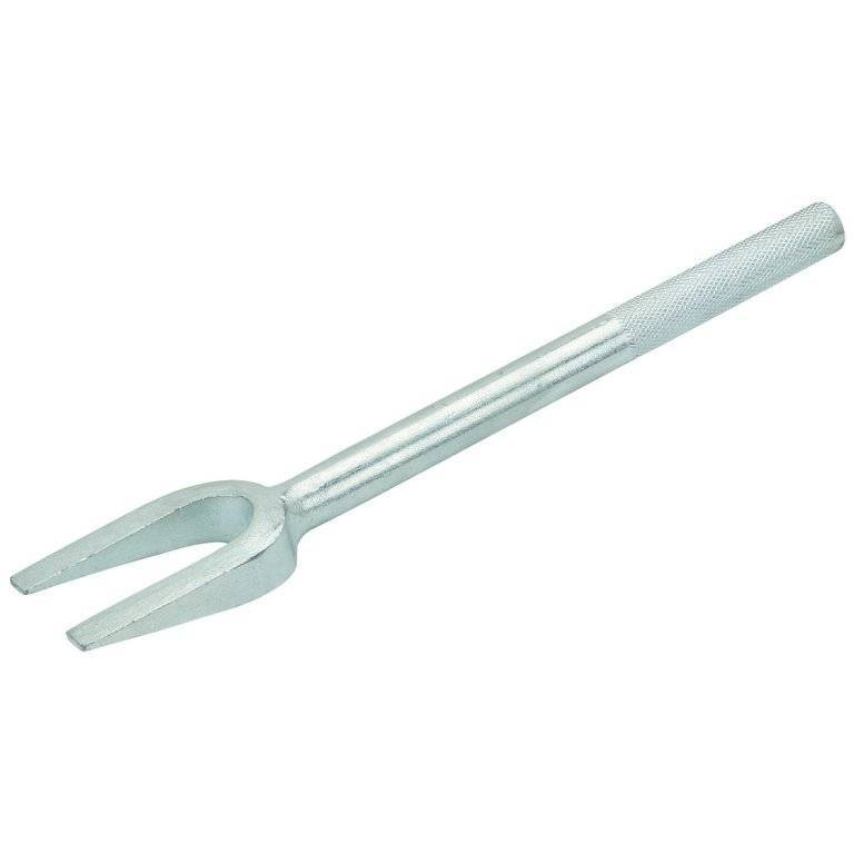

I bought a pickle fork attachment for my air chisel a couple years back. Works great on tie rod ends, but I haven't tried a ball joint yet. Anybody ever use one on a ball joint?

Yes, Bs ad Cs are quite different in size. Another one of the hold-ups for me was the driver's side caliper they originally sold me would not mount on the rotor, no matter what I tried. I took it back to the shop where my mechanic Buddy, Big Chris Fredricksen, just so happened to be there getting parts for a project. As I walked in he looked at the caliper in my hand and said, "What are you doing with that B-Body caliper?" He knew it instantly! Once I got the correct one it mounted with ease!
Yes. It still refused to budge and I murdered that thing.
Finally broke it free with something like this:
¾" breaker bar and 3' pipe. When it finally popped, it sounded like a cherry bomb.
Commando, isn't that the factory ball joint separator tool? It has been 35 years since I've seen one but looks awful familiar.
This is a pickle fork, it seperated more suspension joints that a ball joint seperator.
