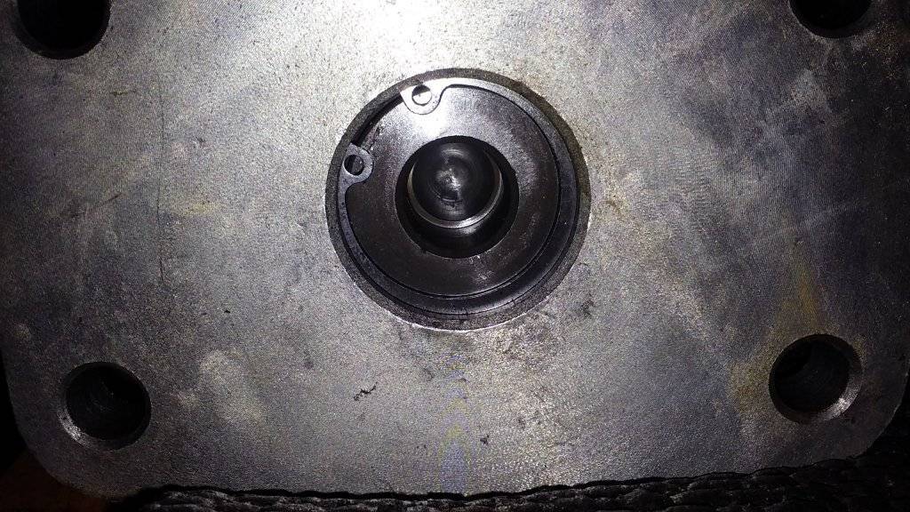

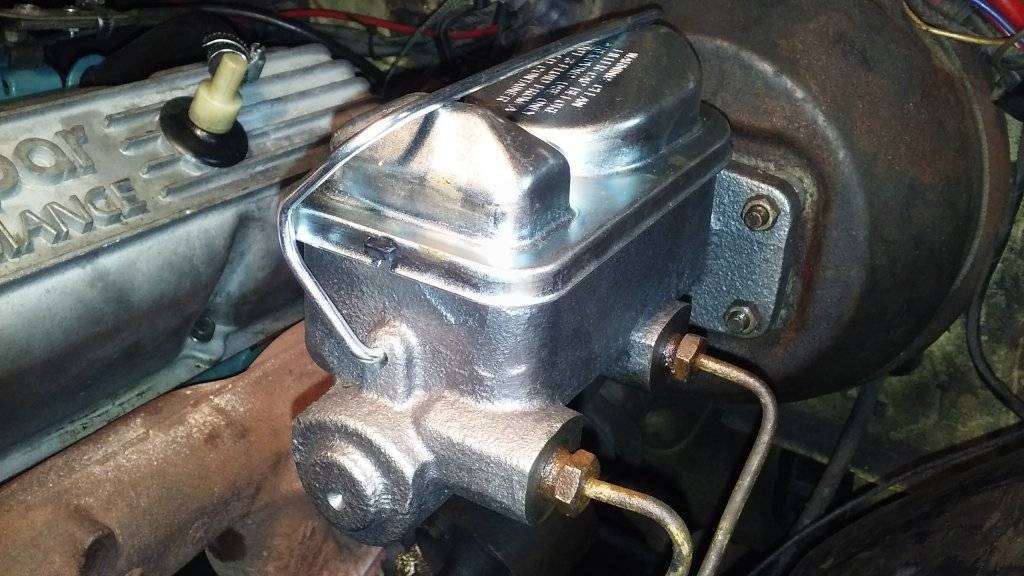

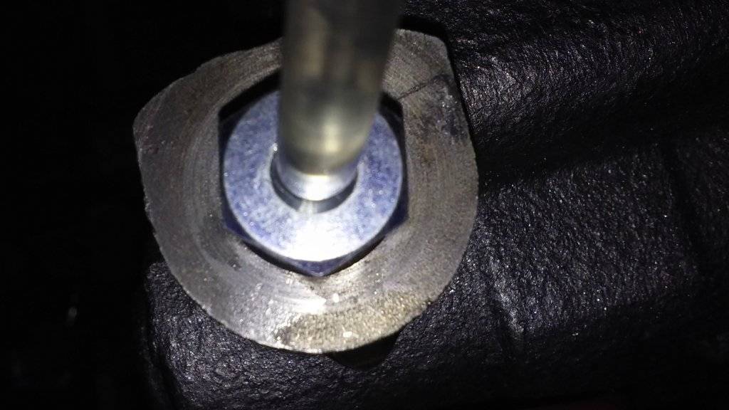

Also, don't forget to adjust the end of the booster rod (adjustable screw end) that fits into the master before you bolt the master to the booster? Insufficient play and the brakes will drag, too much play and you won't have sufficient braking power.
Ya I see it. How do I know what the proper length will is BEFORE bolting the new MC on? As it is now the MC fits right onto the four studs it mounts to, but not all the way with the rod there (I removed the pedal bolt under the dash).
You won't... There is often a brake pedal free play measurement, but I looked in my FSM and it wants you to verify the brake circuits are compensating. After fill and bleed, you will have to look down into the master to verify fluid is creating turbulence there when the brakes are released. Caution, the front chamber will likely squirt fluid all over the paint if you release quickly. This is best done with a helper and a couple practice stokes before your face is in the way. Flush any painted surfaces thoroughly with water if fluid gets out of control.
To be safe, start with a lower setting (screwed in) and you get too much pedal travel, start with a higher setting(screwed out) and the brakes wont compensate pressures as they heat and will drag as you drive. More heat more drag more heat... it would eventually boil the fluid and result in no brakes... so it is important not to be to far out. FSM should be more clear now... but please ask before you chance anything on a guess... brakes are too important.
  1. Can't tell exactly, but is that a retaining clip @ the plunger on the new mc?
  2. Bench bleed the master
  3. Use a tooth-pik or something to measure the depth of both mc's plunger from the FLAT of the base for comparison
  4. Your boosters rod is adjusted for the old mc and you don't want it to be adjusted too short (insufficient braking) OR too long (will hang up your brakes)
Go back to page 28 #552 to review my comment.
  1. The booster rod was adjusted for your old MC.
  2. The NEW MC plunger appears to be inset further than your old MC.
  3. You won't know if the plungers position shown in your photo is actual until you bench bleed the MC as the plunger may extend out after bleeding.
  4. Measure the depth of each plunger first
  5. If they are equal and the plunger is still inset after bleeding, then the difference in depth from the FLAT of the base to the FLAT surface of the plunger would be the approximate amount to adjust the tip of the rod.
  6. If they're of different depths then adjust your measurement accordingly.

How hard should it be to push the plunger into the MC? It has sat for awhile and the fluid level is constant with no bubbles present....the plunger does not seem to want to move?
It's pretty stiff to move. You are pushing against the springs in the master cylinder. It might be a little stuck from sitting too.
Once the MC is bench bled and primed, does the fluid stay in the reservoirs during install?
Yes, just put the cover on and if there were some plugs for the ports from the box it came in, stick them in there.
Just be very careful not to get any brake fluid on the paint.
air bubbles are lessening, but a slight leak is getting past one of the fittings.
If you can give it a little more, tighten it. Otherwise don't worry, you will still have to bleed out the rest of the brake system... there will be a small amount of air that gets in during assembly.
The whole reason behind bench bleeding is how difficult it can be to get the air out of the tiny passages of the master cylinder. It also helps protect the master cylinder during bleeding.

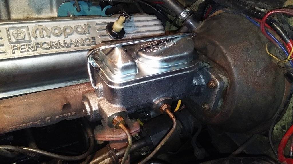

All bench bled and installed.....I guess bleeding the calipers comes next...
