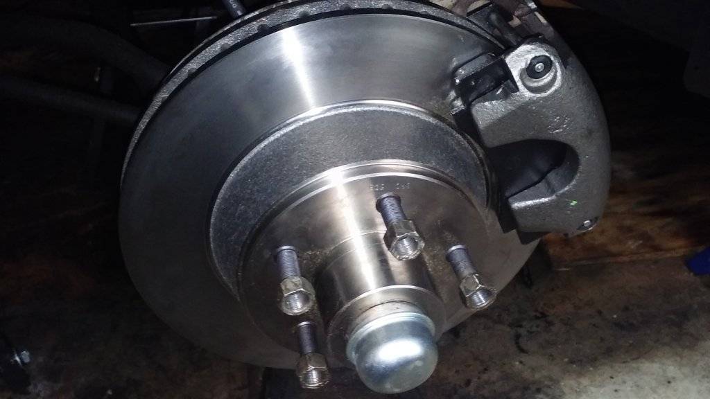

Just notice the driver side studs on the rotor are not "reversed" threads...they are the same as pass side. Looks like multiple sources on the internet sell the right threads..
any suggestions?
go to napa and get some nutz. my ride is the same way, only the rear left is L threaded now.. the other 3 corners are R threaded.
Could go ahead and change the rears to the thread and have them all the same
Yep... want to add replacing rear studs to the growing resume? It will absolutely F-up the kid in the tire store if you just need a laugh...

Actually the stud is no big deal, but you wouldn't want him to hammer out the holes in the rim... I retract the prior bad idea.
How was bleeding the brakes? Does the pedal feel firm, just slightly lower than with the front drums?
