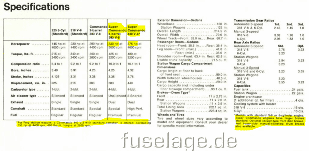

You seem to be implying that the Super Commando 383-4 was not considered a HP engine. I disagree, although the RR 383-4 was rated at 335, IMO that doesn't mean the Super Commando 383-4 used in Fury's was not considered a HP engine also. From a technical perspective, the 330 Bhp engine had higher Bhp, higher torque, dual exhaust, and required Premium fuel compared to the 383-2 290 Bhp. From a Marketing perspective, Plymouth called there HP engines "Super Commando" and used the red lettered hood ornament on the 383-4 330 Bhp engines so they obviously considered it HP.

You are most certainly welcome to disagree but you’d be arguing with Mopar over their use of "HP"...not me. Their changing use of the term HP does cause confusion if you don't look at it in context.
In 67 and earlier and in 71, the 4bbl version of the 383 is designated HP when compared to the 2bbl version. In 68-70, with the introduction of the 335 horse 383-4 in the Road Runner, the assembly with the 440 HP cam et al becomes the HP variant of the 383-4bbl when compared to the 383-4 with the standard cam.
As there is no C body 335 horse assembly, pending broadcast sheet documentation, the answer to the question is still 'zero'.

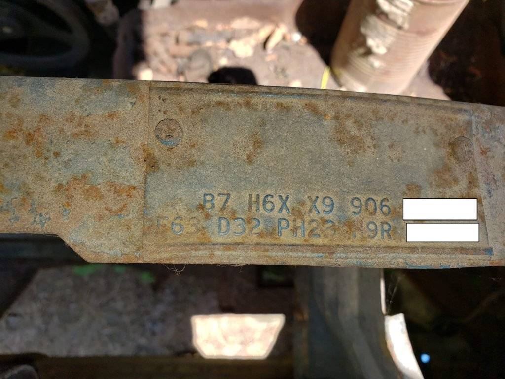

What if I told you I'm looking at buying a 69 Fury with an E63 383.....with dual snorkel, dual exhaust and HP manifolds..
Ask and you shall receive....car is well optioned....PS PDB, PW, Cruise, buckets, console, etc.
Nick
The H code is the correct code for a '69 383 HP engine. I am not sure however if the Windsor plant produced 330 or 335 horse engines under the H code, as they tended to do some things differently than here in the US.

Did the Windsor plant also assemble their own engines or were they brought in to the plant like they were at other plants? Otherwise the final assembly plant is irrelevant.

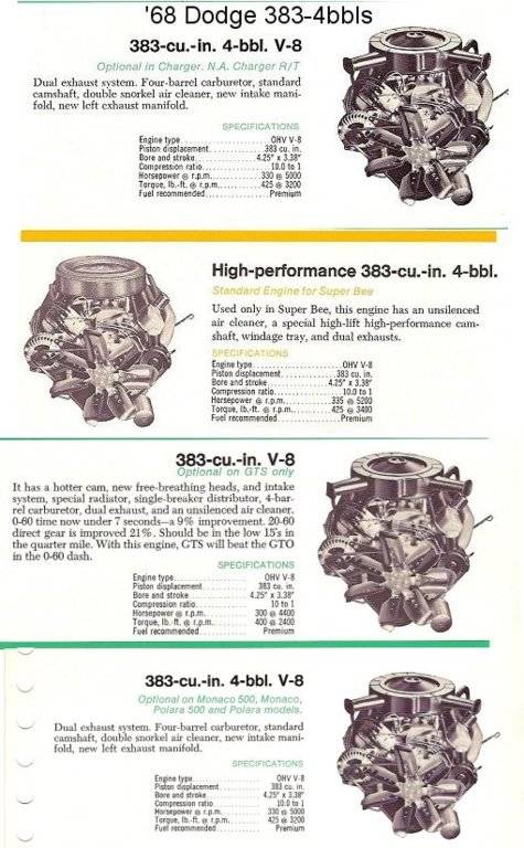

The H in the VIN only tells you the CID (383) and carb (4bbl) configuration. It does not tell you the horsepower rating or the application.
A, B and C bodies all received 383-4bbl assemblies with various horsepower ratings. All code H in the VIN to indicate 383-4. (Below is from 1968 but the concept applies to 69 and 70 also)
