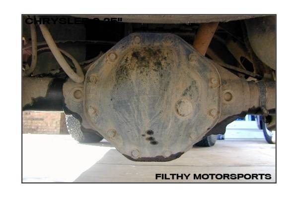

Going by his "handle" and avatar pic, he has a 75 NYB-which means he'll very likely have a 9.25 diff behind the 440/727 standard drivetrain. The 9.25 Diff cover has a fill hole...On my past Imperials, it was a threaded plug that over the years rusted and deformed...I replaced it with a rubber plug used on later trucks like you see here (highly recommended).
I don't know what year they transitioned to the rubber plug.
Hmmm.. The 9.25 just installed in the blumo out of a 74 fury had the rubber plug. Looked original too. I put a newer cover on it off a truck with the rubber plug too.
