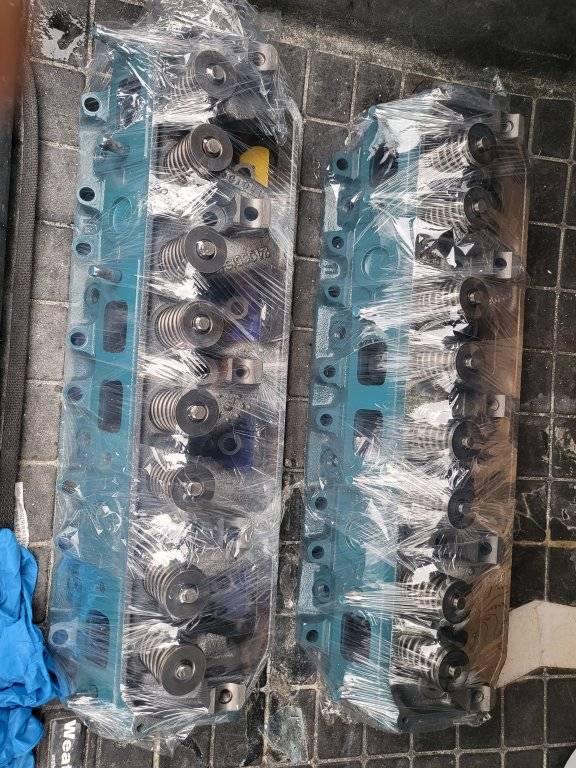

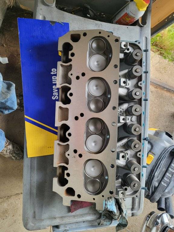

Goldie's heads finally completed after 15 months
Zymurgy
Sep 14, 2012
6,716
7,632
London, Ohio
I can't believe I let this go on this long, but he is supposed to be the best in the area. I did take your guys advice and have the 516 heads exhaust valves enlarged to 1.74 with hardened seats and valves.
I have started the process of the reinstallation and any advice for this novice would be appreciated. I have bought all new gaskets, retapped all the threads in the block and have picked up some assembly grease.
They look great. And should work very very well.
See that small hole next to the big "L" cast into the head??? It's the oil passage up to the rocker stand. Clean all four of them out thoroughly. Many times if heads get swapped side for side, you could have oiling issues since the block only pumps oil into one on each head. Even baking the heads rarely cleans them out properly.
Thanks that is exactly the kind of advice I am looking for, that isn't in the service manual.

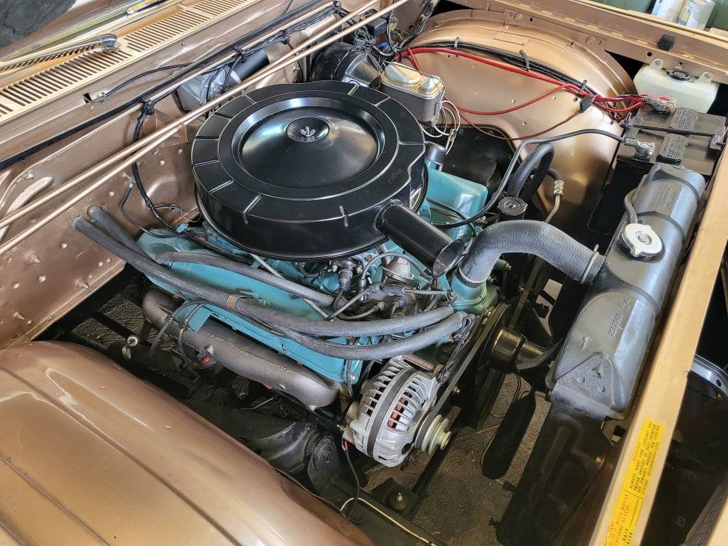

I am really close. Thanks for the advice. I have been really busy and only had a little time over the weekend and spent some time on her yesterday. I forgot to pick up some new spark plugs or I might have stayed late last night and tired to finish.
It is all back together. The engine is much smoother and quieter without the burnt valves.
I ceramic coated the exhaust manifold. I got them back over a year ago. There was alot of white smoke when I started it the first time. If he mentioned this to me I had forgot. A quick Google search told me this was normal and only happened the first time.
