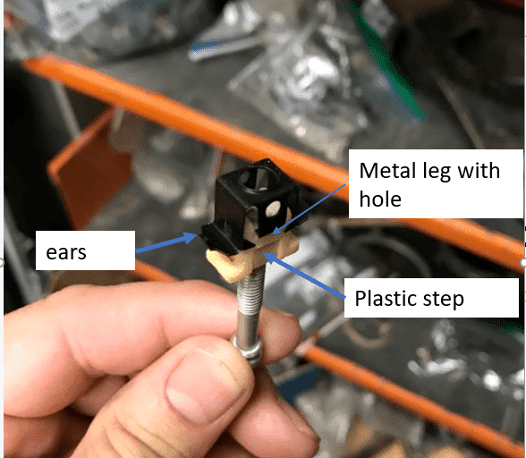

Insert black metal piece and plastic like shown. When black ears bottom out on grill then you may have to expand the legs (with hole) so that the plastic can slide up into the metal carrier. The plastic should expand the legs enough to trap the black metal piece in the grill. If the plastic step is worn or non existent it will slide back out.
I used a socket and C-clamp to press these in, some of mine were falling out. My grill is potmetal and I don't thing the factory put the same effort into pressing them in. They are solid now that they are properly seated.
Alan
Using the labeled picture above, all I had to do was bend those metal legs out a little bit farther and it snapped right into place.
