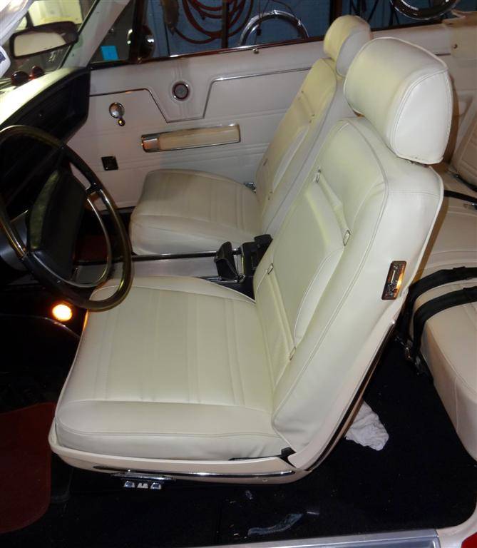

To add to this ....... Headrests were avaliable as an option on 68 and early 69 cars. They could be had with just a driver side headrest, or a passenger side headrest or both.
The reclining seat option included a headrest on the recling seat only. So if a passenger side reclining seat was ordered then the driver side headrest would still be optional.... wierd, huh.
Also ..... recliner seat headrests were different then non recliner headrests. More square then the pod type, although they will interchange.
