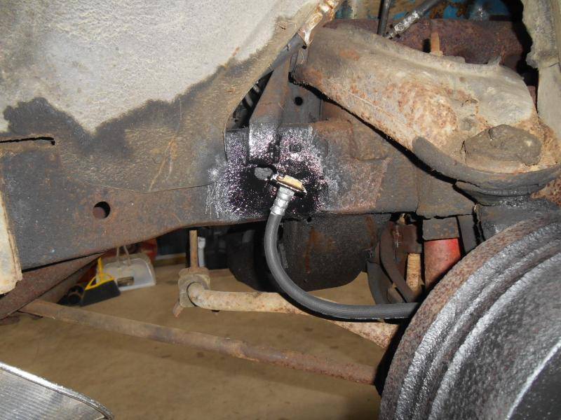

I have run into a small problem in finishing up my brakes. I desperately need the frame bracket that the front brake hose of a drum brake car hooks to. The passenger side one is missing on my car. It has a 12 point hole that the hose hex keys into so it can't turn. I am not even sure what the proper name for this thing is. Please let me know if you have one...many thanks!!!

Specifically what year make and model are we talking about here? Many of those were welded to the stub frame rails and not bolted. Give Murray Park ah bump at: mbpark@cbodys.com fill in the blankz and have him send you good used one. If Mindy answerz don't be afraid to talk to her and try to be polite. She knowz az much az he doez and maybe more. lol

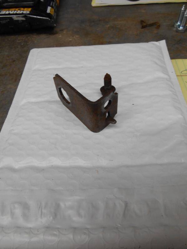

We may be good. Looks darn close

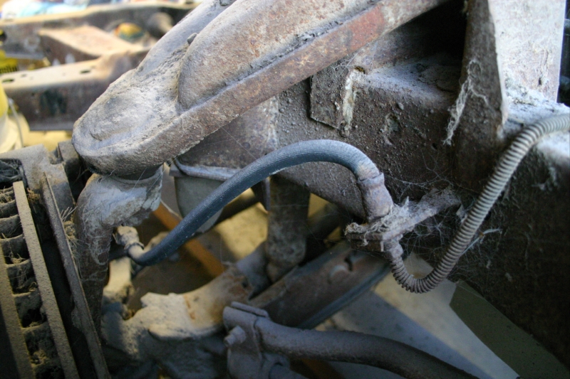

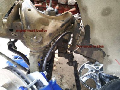

It's strange....the parts book shows the steel tubes looping and connecting from the top side, yet your car is opposite. My car was also backwards and my new hoses were too short that way. If the hoses come up from the bottom, they fit correctly.

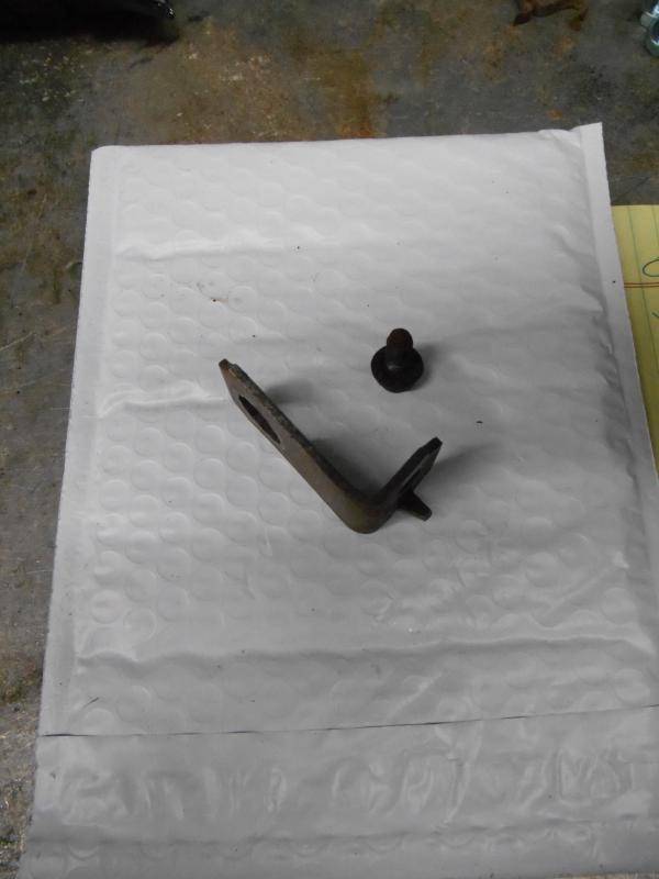

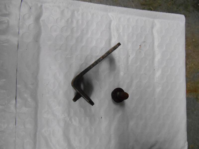

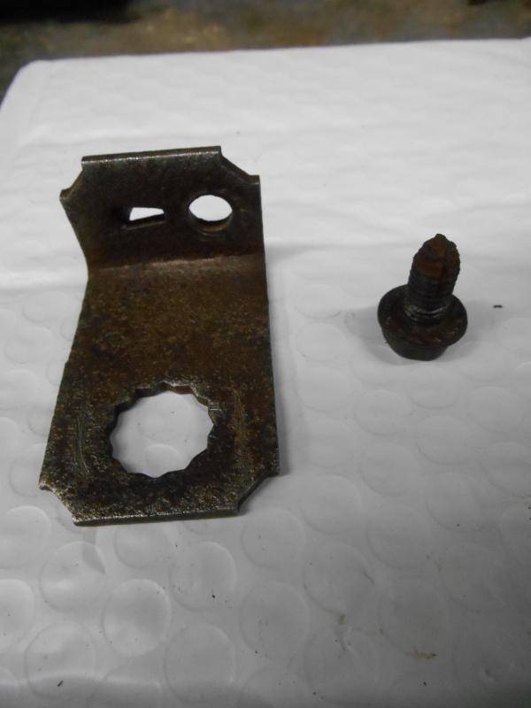

Bracket

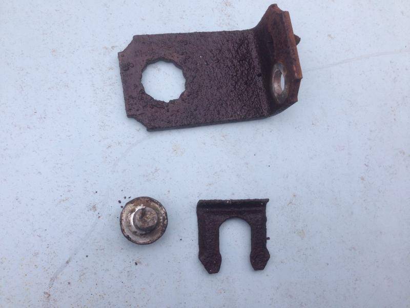

Ok got them both off. This is the passenger side. If this looks good let me know. Also I have a blast cabinet & can clean it up & paint it black for $10.00 if you need that done.
Thanks to all for your help and thanks Bob for finding that bracket!

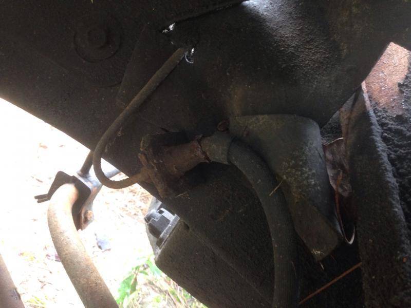

I thought a picture of the bracket installed correctly with the hose locked in place would be useful.
Yes, but...a '69 disc brake setup is very different from a '68 drum brake setup. Hose from bottom is what the FSM shows for my car.
