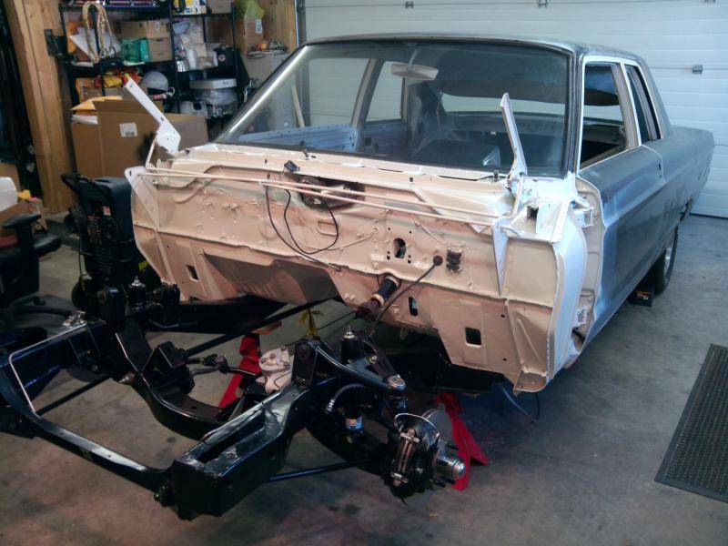

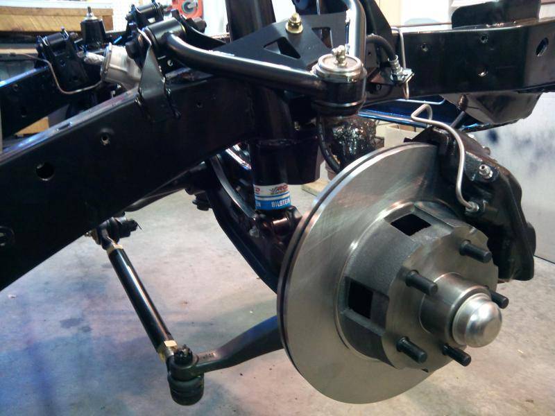

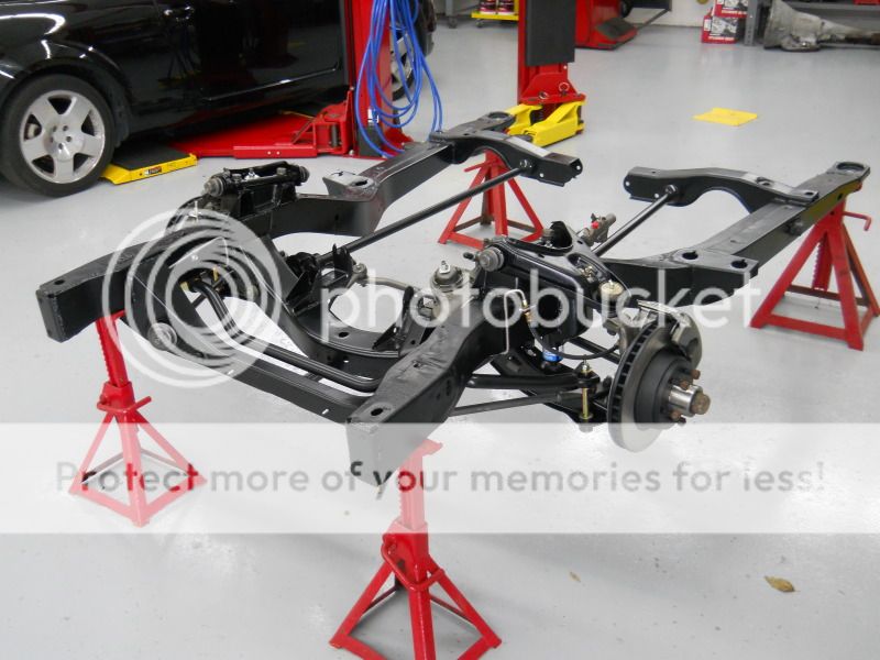

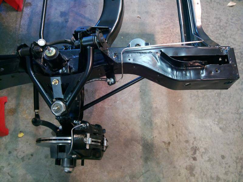

Catfish I installed the firm feel front end recently with 1.12 T bars. Also got the sway bar but cant install it until the engine is in and it is sitting level. Had to weld in the brackets before the frame powder coat.

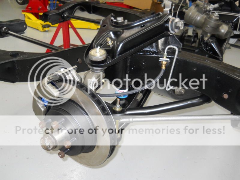

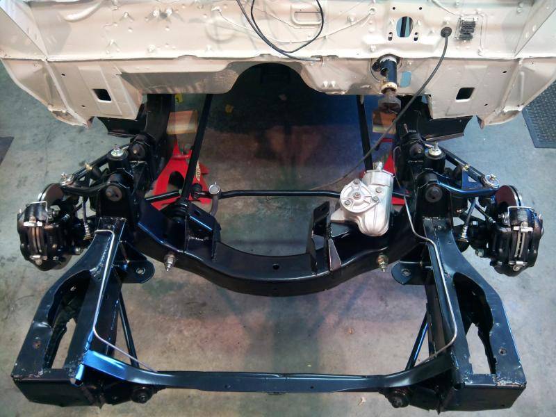

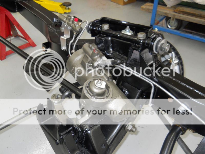

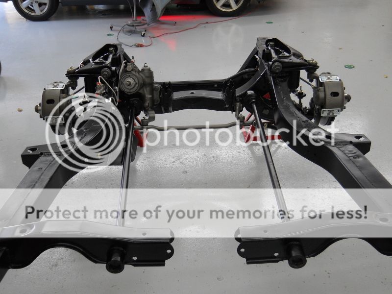

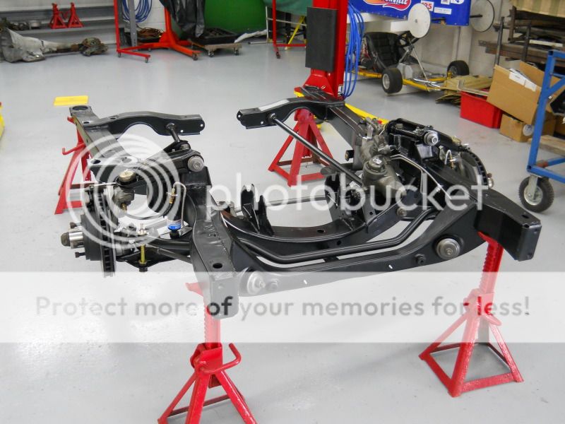

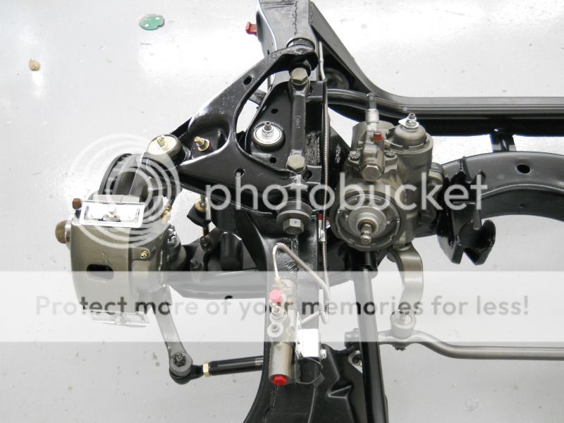

I have a front end that looks kind of like that. I rebuilt my 74 Monaco subframe by taking it for a walk thru the Firm Feel catalogue. I don't have the car on the road yet so I can't speak for the ride or handle but I used the big 1.18 bars. If you have concerns, call Dick at Firm Feel, he is very helpfull. He's not a huge C body guy but he knows his stuff.
The following is a list of parts that have been used:
Stage 1 steering box from, Firm Feel Inc
1-1/4" front sway bar, Firm Feel Inc
1.18" Torsion Bars, Firm Feel Inc
Bilstien Shocks, Firm Feel Inc
HD Tie Rod Assemblys, Firm Feel Inc
Bushing Kit, Firm Feel Inc
Idler Arm and Pittman Arm, Firm Feel Inc
Moog Ball Joints, Firm Feel Inc
Custom Stainless Steel Brake Lines, Inline Tube
Rotors, Local Parts Store
Reman Calipers, Local Parts Store
Flex lines, Local Parts Store

Beautiful work!!
One concern: The upper control arm frame brackets... I'm not 101% comfortable.
Those front stubs look great! Both of guys! I haven't bought everything just yet, the dentist bills this summer racked up to the tune of 20 grand. Done with now, so I can start researching again and place some orders.

Feeling stub frame envy...I'm surprised to see tubular A arms on a C body...I didn't know that anyone made them. Nice to see some C body support in the industry.
