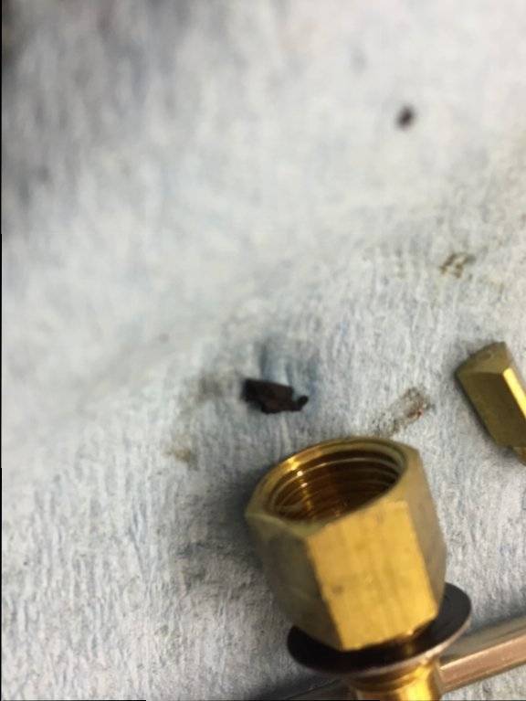

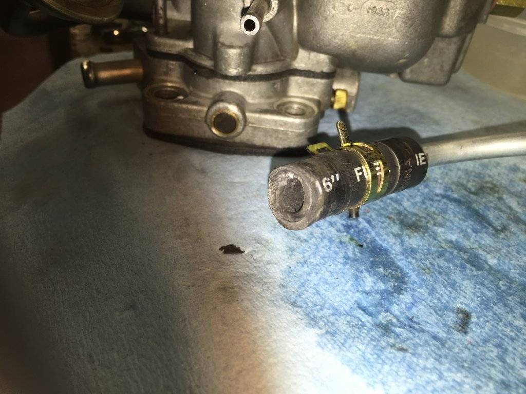

View attachment 87531 View attachment 87532 Ok

Found a pice of fuel line had broken off and lodged itself in the needle n seat
I changed the fuel line pieces attached to the filter
To top it off I disassembled the carb to trace my steps and discovered that I had installed the accelerator pump check ball into the metering valve port by mistake reassembled the carb

One last thing here is that I was speaking with Fred (Fratzog) a few weeks ago about this and he had hit the nail on the head about the needle and seat issue he had experienced when rebuilding a carb form his car..
I didn't have a flooding issue back then but this certainly would have caused me a fuel related issue even just floating around in the line.
