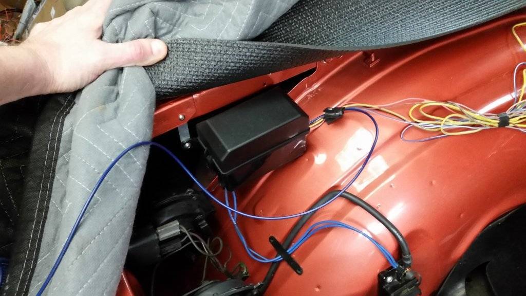

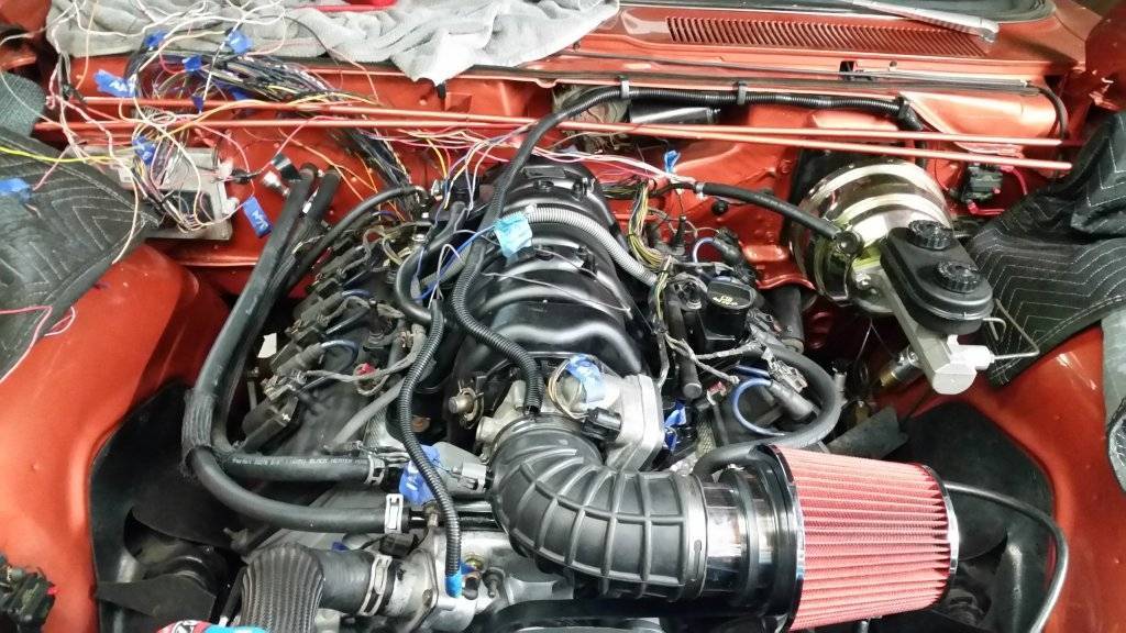

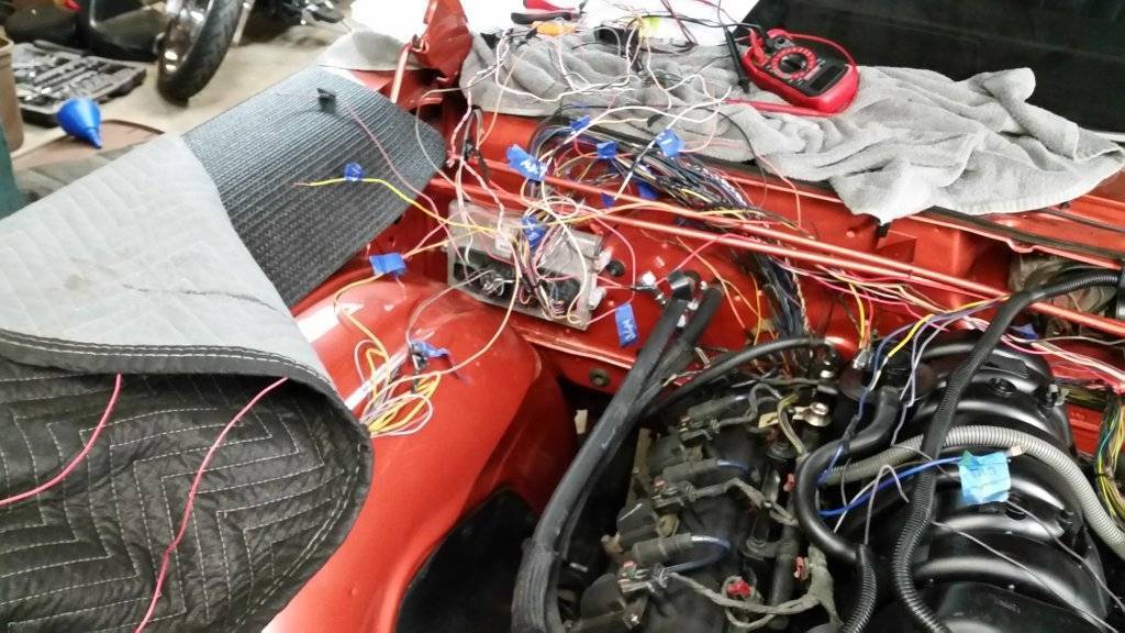

Started fixing the wiring harness last night. Pretty much figured out the engine side. Now to supply all inputs - battery, ignition, start, then test everything and wrap it nicely.
Tested the wiring last night. Installed the PCM and additional fuse/relay block for auto shut down relay, fuel pump relay and fuses.

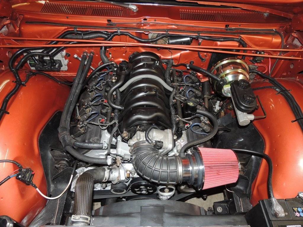

Finally drove the Fury. The Hemi pulls great and is very responsive to accelerator pedal.

I took the Redhead for a few rides and honestly I like the Hemi a lot. And it did not cost me that much to do the conversion. I was given the engine as well as new gaskets, rings and bearings. I had to buy rod bolts and a few other parts. I did not buy expensive mounts, expensive wiring and controller, gas tank and pump. I had factory wiring harness, PCM and Durango tank/pump. Yes, reworking the wiring took a lot of time, but it costed me nothing and it is doable, same for other things. In the end I think I have spent around $1k on the swap and a few months of my time (working evenings and weekends).
I made my own engine mounts using original big block mounts with rubber part cut off. I also reworked Hemi plates and sandwiched a-body small block rubber mounts in between. The 727 stayed in it`s factory location, therefore I retained console and shifter, transmission mount, driveshaft, etc.
The engine is pretty close to firewall pinchweld - about 1/2" on the passenger side. That is the reason I used car intake - it is more compact. Alternator on truck setup is not that high and would not interfere with the hood, but the car intake/throttle body does interfere with truck timing cover. There is a workaround for that - 1" spacers can be installed under intake manifold - that would bring the throttle body up and would clear the timing cover, you would also have to relocate alternator a few inches to the side.
If I would have done this again, I would have moved the transmission forward one inch or so and would have installed a longer driveshaft. That way you get enough clearance at firewall and retain the truck setup completely (I like it better because alternator is not sticking out to the side).
